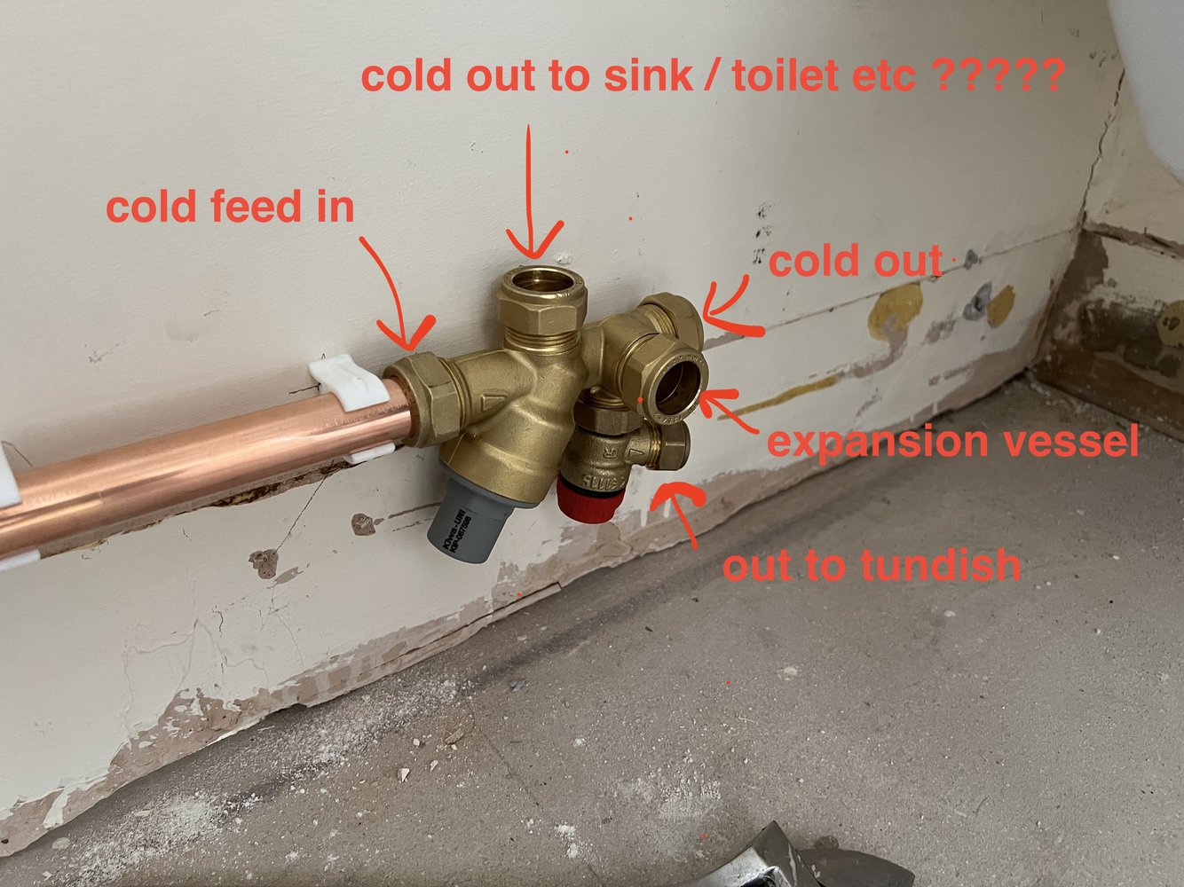

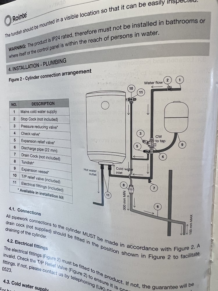

I have bought a Rointe rome water heater for a 'granny flat' on our property, no gas etc so has to be electric, so this model ticked all the boxes, wifi control,timer etc.
There is a pressure reducing valve and expansion relief valve which comes in the kit, and poorly labelled (in my opinion) on the instructions there are 5x connections
1x cold water feed
1x cold out to water heater
1x expansion vessel connection
1x tundish connection
And there is one last connection which is labelled as 'CW to tap" which i assume means that becuase they ask for the water heater to be fed from a good mains water pressure, that you could use this connection as a cold water feed to dish wash/ washing machine, taps, toilets etc?
Am i correct in what i am thinking?

, I believe your correct .that would be at the same pressure as the outlet on the hot water . So if the heater fed a sink or basin it would be same pressure from both hot and cold taps . I think it's called a balanced connection or some such name .
