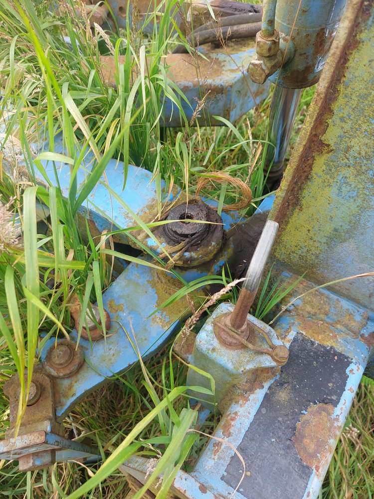

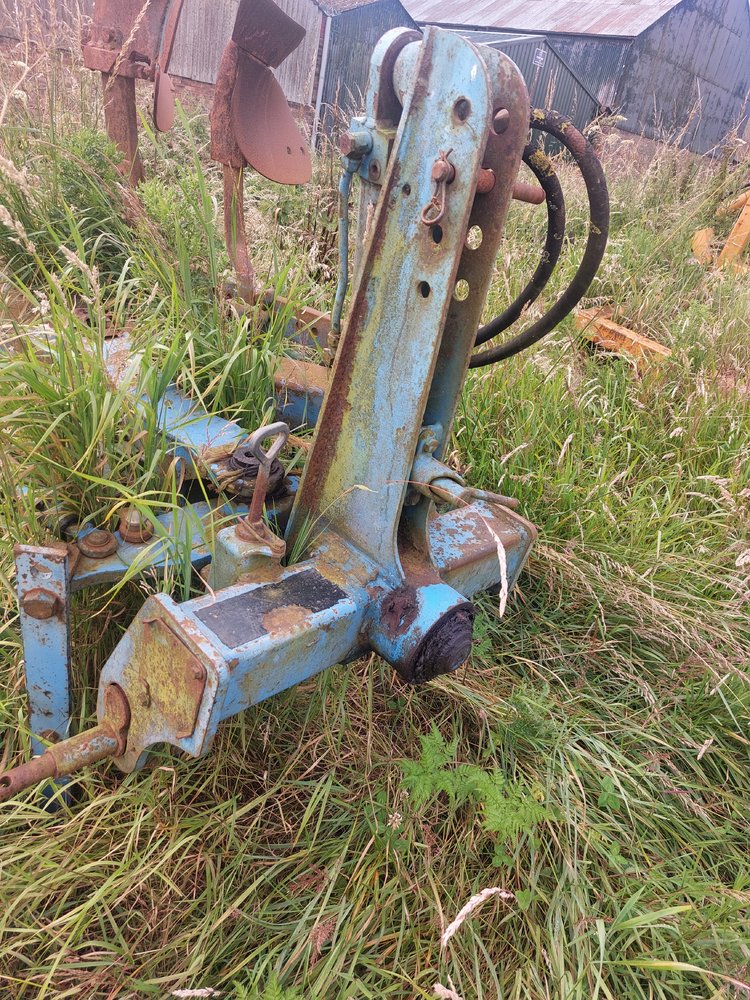

The depth wheel on this is right at the back and its always felt decent with a loose top link when set right.On our 5 furrow lemken the depth wheel was quite far forward and with the top link in the slotted hole the plough could nod about so generally used it in the hole, used the slot for one or 2 fields with bad bumps and hollows. The 6 fur kuhn we have now the wheels nearer the back and runs in the slot all the time. On my 8 fur semi mounted the toplinks pretty irrelevant. We both run jud top links and it's handy on the fully mounted for finishing off without leaving a big open fur.
 got an old hyd top link on the post knocker but it's hard piped in and leaks a bit. It would be really handy to have a hyd for setting out and finishing, though. Will think about it.
