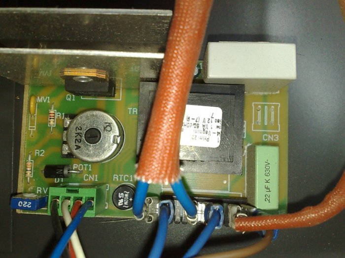

I bought 1 a few months ago (after reading on here I'm thinking maybe that was a bad choice lol) & used it Gasless for about 2 Rolls of Wire. I decided that I really needed the Gas for what I'm doing so spent the last month getting the bit's together to change it, including a Metal Wire Liner to help things along!
I put it all together today, got it ready to weld, pulled the Trigger &...... nothing! Well, I say nothing but what I mean is the Wire Feed Wheel didn't turn & feed the Wire through! So I checked everything I'd had my hands on but all looks good, took the Wheel off & the Cog's turn, when I pull the Trigger the Relay clicks & when I disconnect the Blue Wire that runs up to the Trigger it doesn't so I'm assuming the Blue Wire & Relay are fine! Only thing I could think of now is that the Motor had burnt out or seized somehow! Took the Motor off, touched the Wires to the Car Battery & it spins nice & freely!
Anyone know what else I could check or any other regular problems it could be?!
