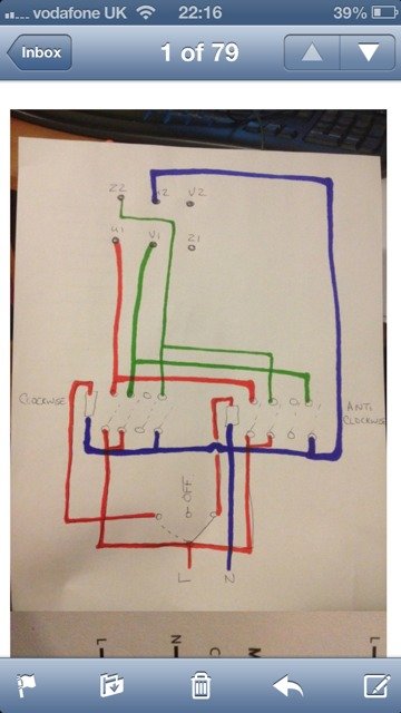

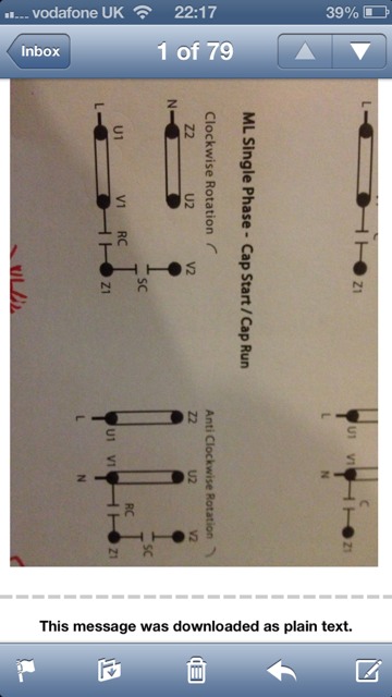

The lift does go up and down though so the motor is going both ways is there anyway that it could do this if the wiring was not quite rite though?
The wiring is all new and enough to cope with it and its the run cap that has blown not the start cap or was you just saying re the start cap in case a prob occurs there?
so are you saying the wiring is ok? as will just replace the capacitor and see what happens as only stopped as capacitor blew so thought We had done something wrong
