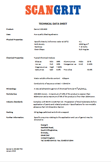

If it's sand approved for blasting, it will NOT be "sand" as most people know it, as it will NOT be made of quartz (ie... pure Silica).Sand can be used and is approved for blasting.
That’s just a fact.
If it is suitable for blasting it will (amongst other things) have less than 1% free silica and will have a data sheet and chemical analysis supporting that.

Sand in most people's eyes, especially DIY-ers, is silica sand.... do you ask for "sand" when you order blasting abrasive? Does that datasheet mention "sand" anywhere? I think not...
Come on man, you aren't exactly completely right here either, you're having a go at Parm for not knowing what "sand" is when you don't seem to know yourself either. And saying to a bunch of DIY-ers "sand" is asking for criticism.
