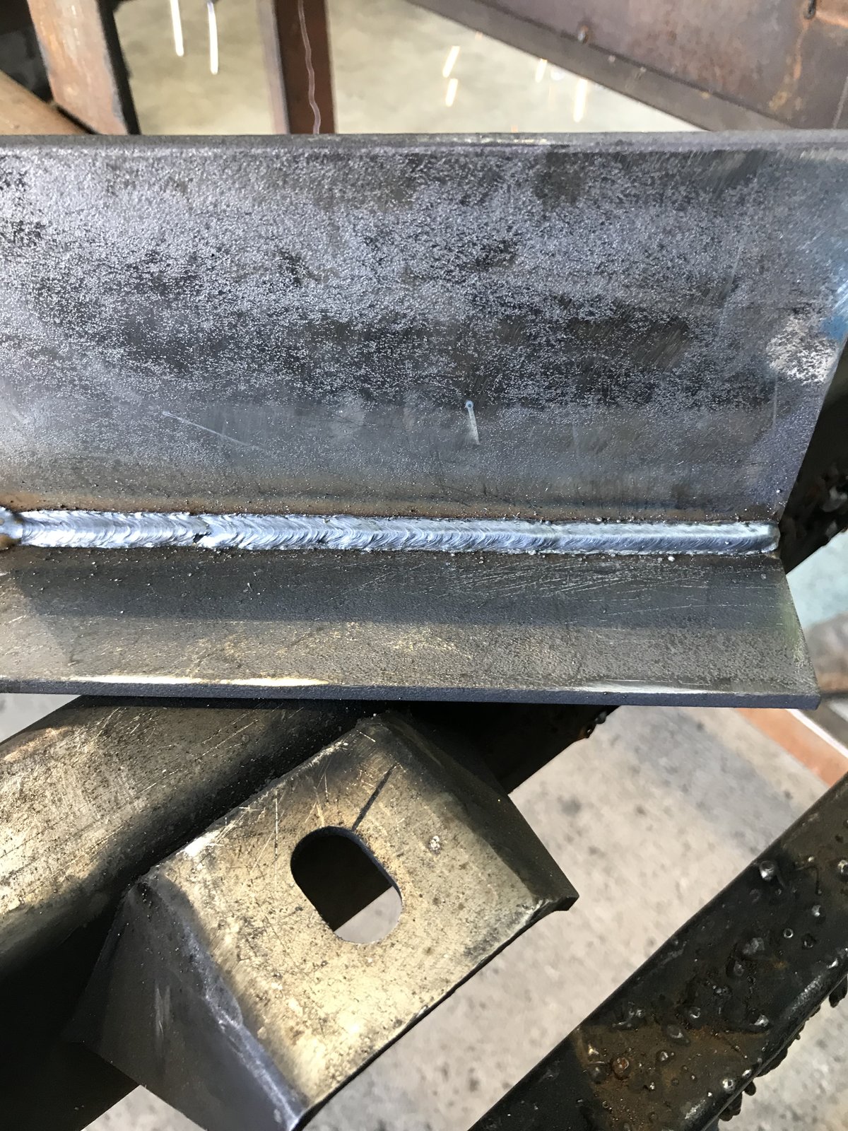

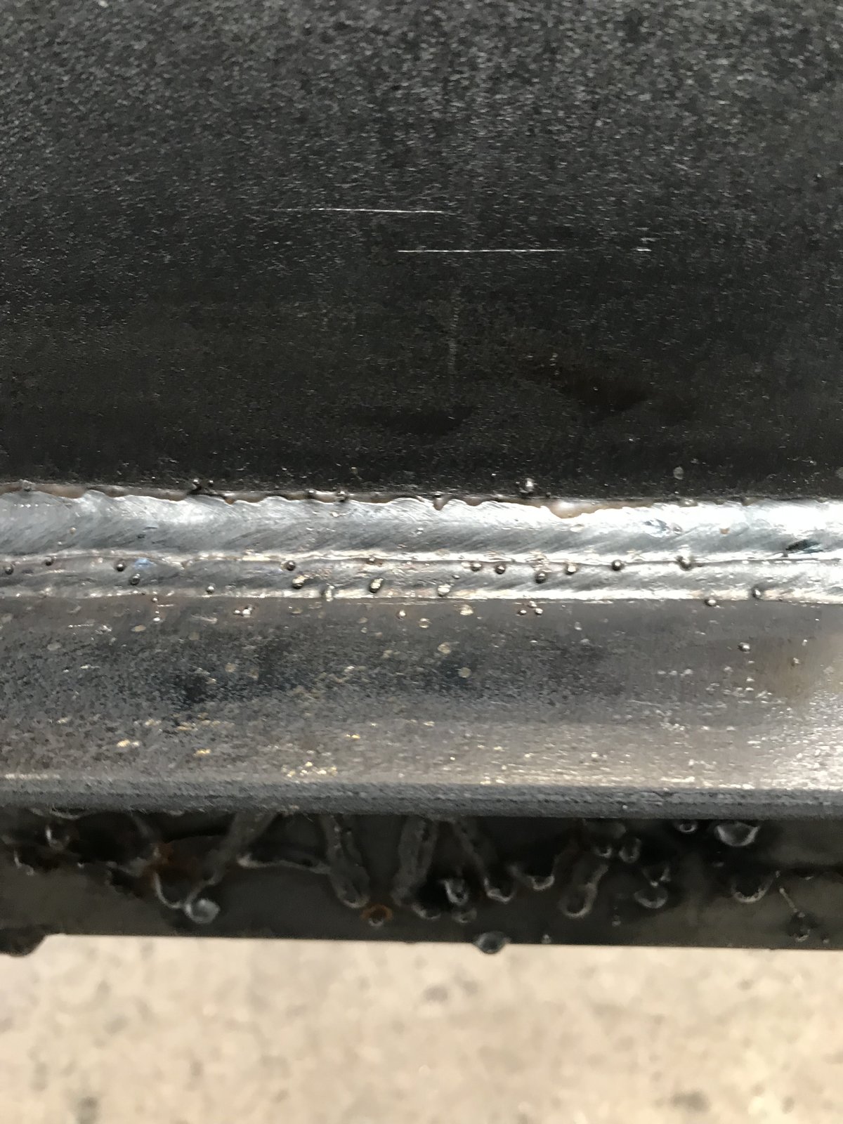

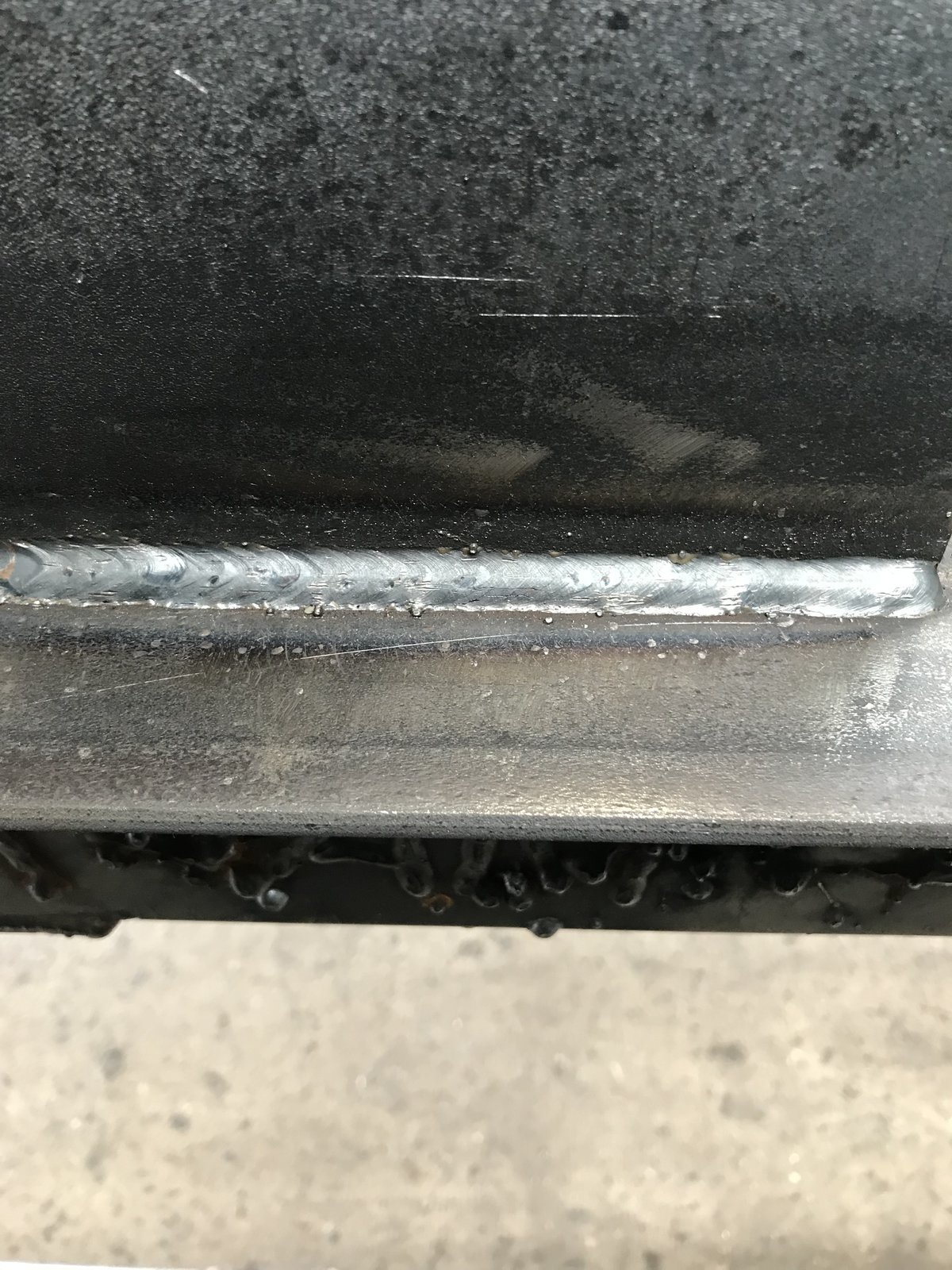

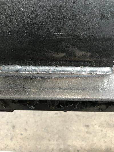

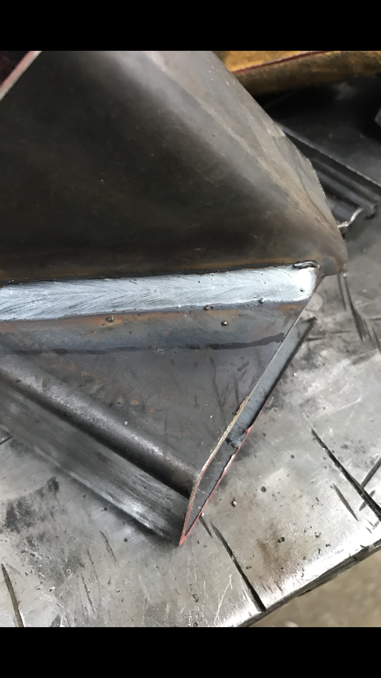

second picture looks like there wasnt enough voltage, the last one i would say 0,7-0,5 m/min of wire less and it would be top class. your lap joints looks great.playing around with scrap..
Thanks for the feedback mate ,im going to keep practicing and hopefuly get in with a good companysecond picture looks like there wasnt enough voltage, the last one i would say 0,7-0,5 m/min of wire less and it would be top class. your lap joints looks great.
but a very nice constant movement, no doubt youll get the hang of it in no time.
you should aim for a slightly concave profile of the weld.
just like that.
it was done on Ar96% O2 4% MIX, 30-31V cleaned steel 6-12mm
I already work as a welder just the company isnt very good ,i want to move on to a different companyyou dont need scrap anymore to practice but an experienced welder to guide you at work. you can always start as a fitter at heavy construction work, prove your skills and talk to your manager. a lot of fitters know how to weld, so they will tell you how to get the job done. and its a nice job, youll earn skills in drawings, grinding, welding, plasma cutting, gantry or even cnc bending - i would say its the best route to start a welding career.
you see that little spatter everywhere? and the profile of the bead more on a convex side, possibly crackling sound, add some more voltage to it. the arc will get more stability and a neat sound. you are somewhere near it.Another friday afternoon of practice
