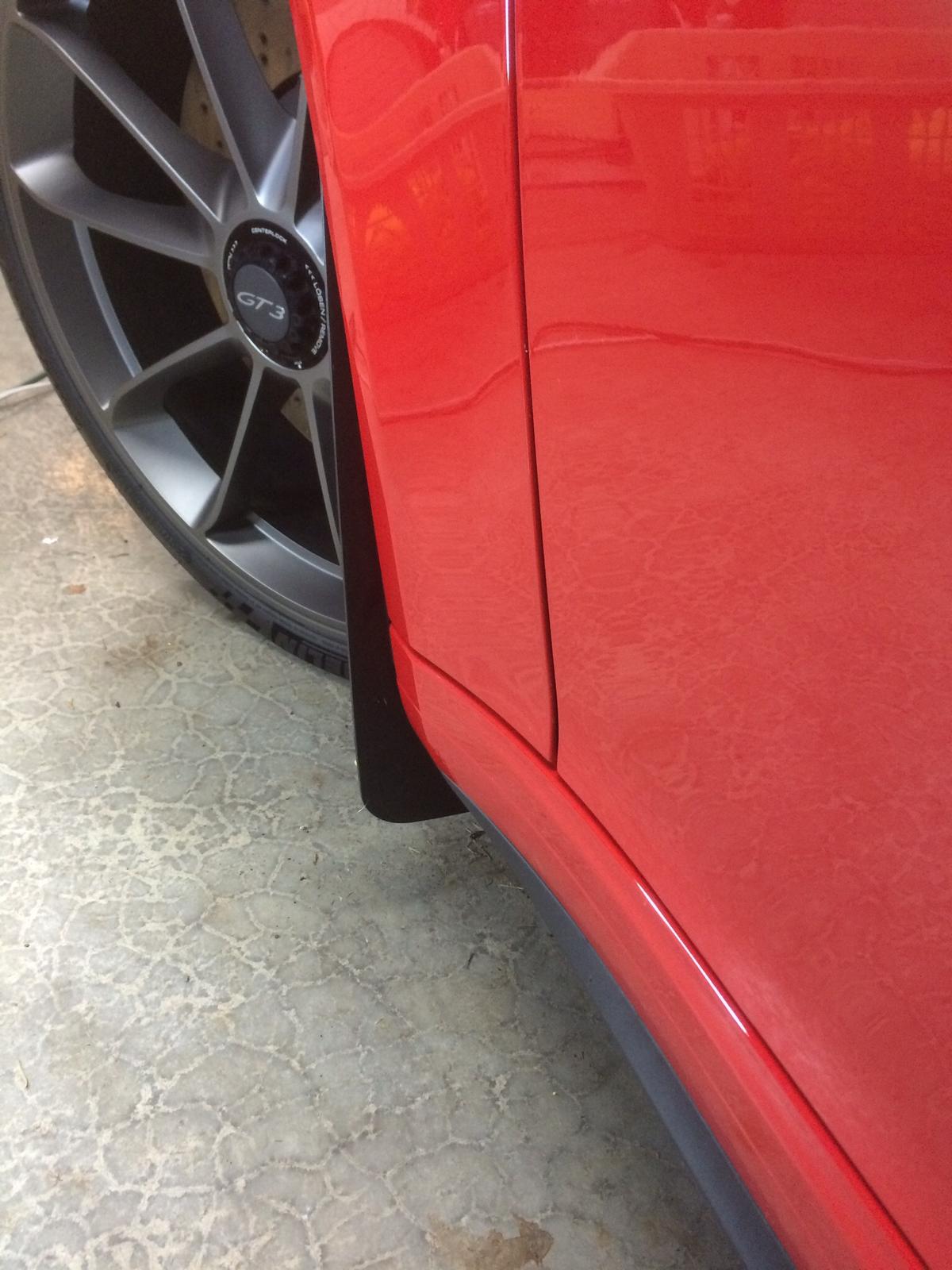

    I am looking to cut some small mudflaps, stoneguards to fit to the lower section of my cars front wings behind the wheels.
    Can anyone recommend what type.of plastic is going to hold up best, I need it to be tough and slightly flexible so it can curve to the shape of the wheel arch, it will only be a few centimeters wide and maybe thickness of 1.5 or 2mm???
    I thought wheel well liner, old black dustbin/cold water tank type plastic.
    Aiming for something like the photo
    Thanks
  2. pedrobedro
    pedrobedro Man at Matalan
    Messages:
    9,919
    Location:
    CX Derbyshire
    Abs is the usual for car body parts. It bends instead of breaking.

    I think it's PP you're thinking of not ABS. Car bumpers are made from the stuff. ABS is more brittle.

    I've seen thin HDPE used before, can get A4 sized sheets cheaply

    Thanks for all the suggestions, I will have a look may have some old oil containers, I only need really thin light material as they will just be held in place by 3 plastic plugs with the centre pins that are already on the car fixing the arch liner to the wing lip.
