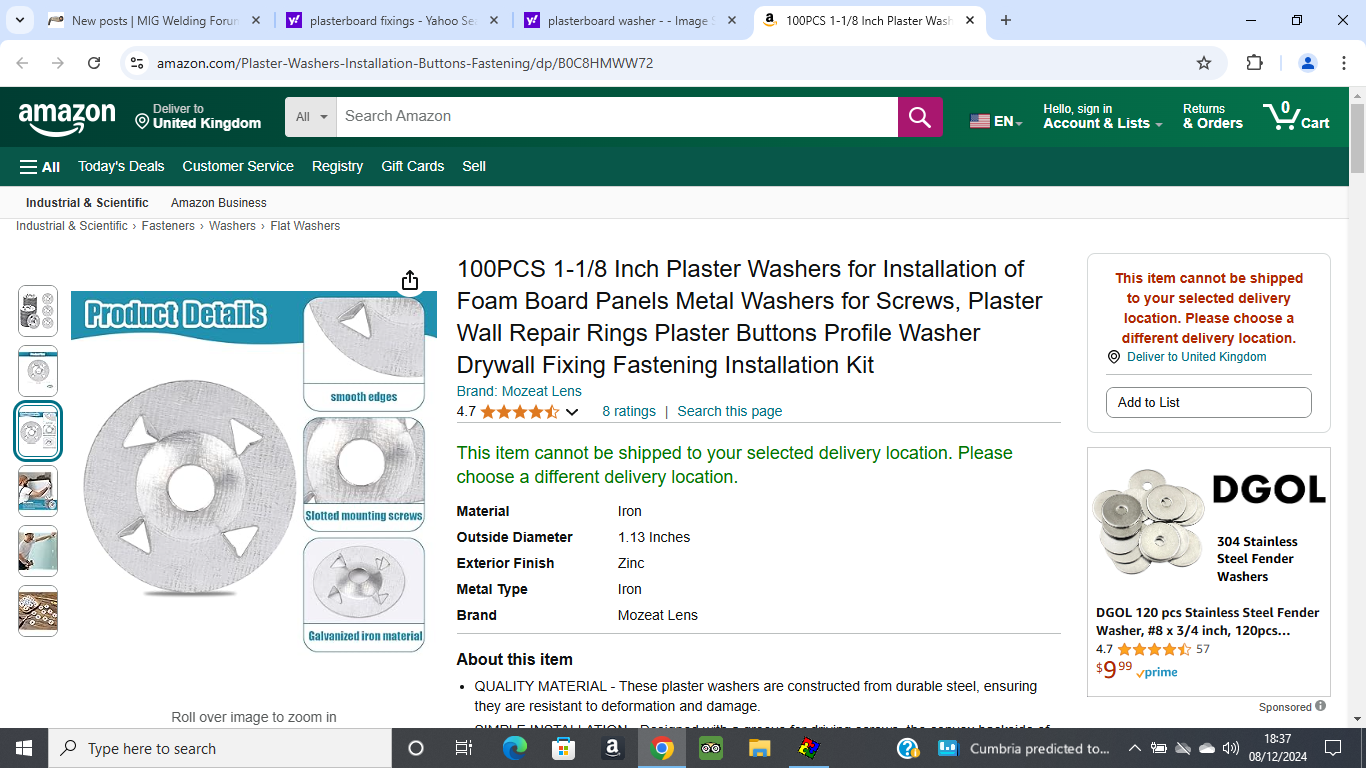

I've used some galvanised plasterboard washers to put up plasterboard. But what can I put over it (slilicone, etc,) that will stop it rusting and showing through the plaster?
best just use the dry wall countersunk screws ity wont fall downBecause depending on how/why you used them, ( why use washers? ) some washers are to thin and either, if not straight away, the screw heads can pop through their holes, if that happens, you have plasterboard sheets not attached to joists properly, one or two no real issues, drywall screws can pop but most washers of this type are used to attach light weight tile backer board that is not going to be walked on from any floor above.In conjunction with plasterboard screws yes why Mark?
