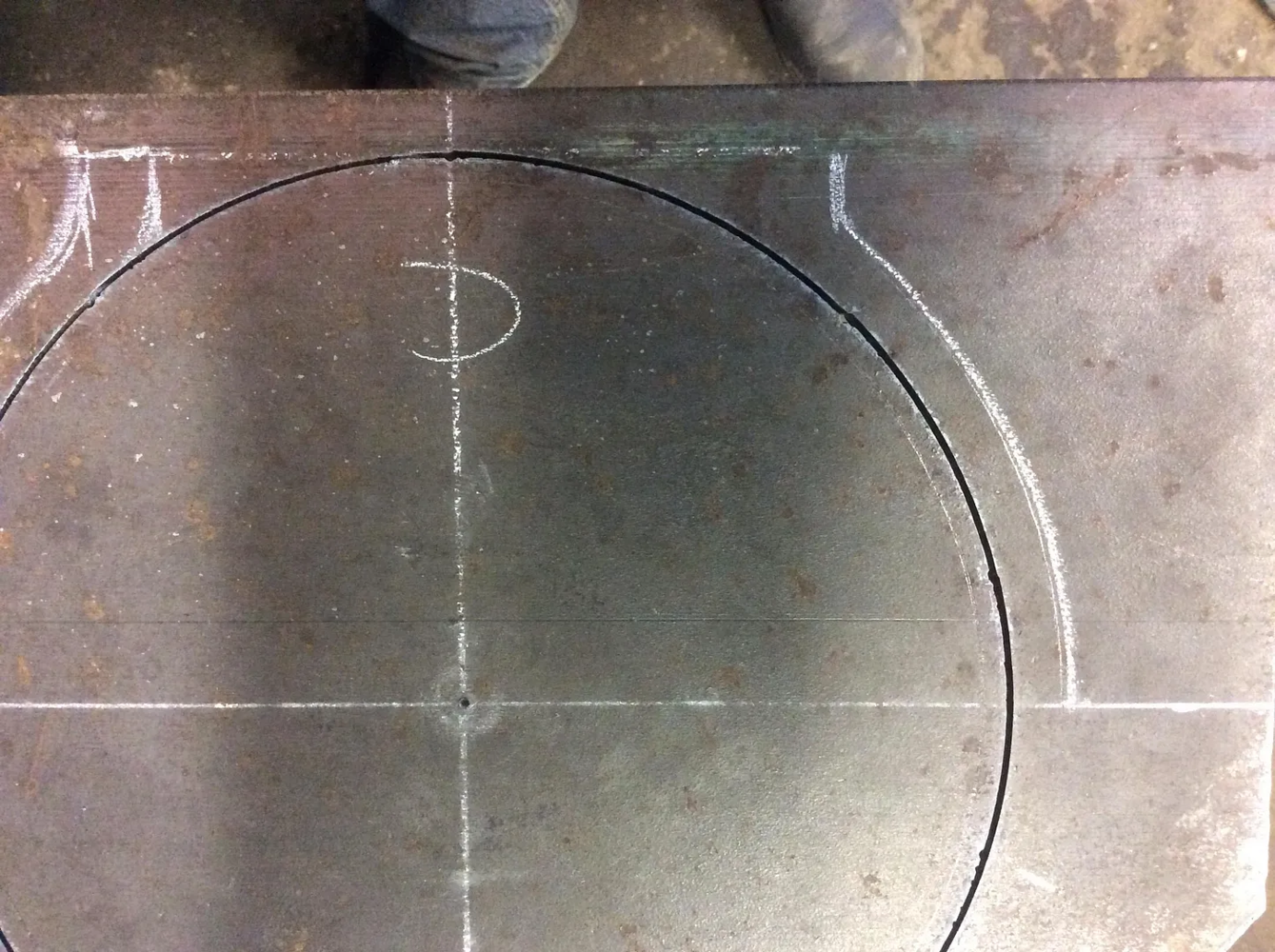

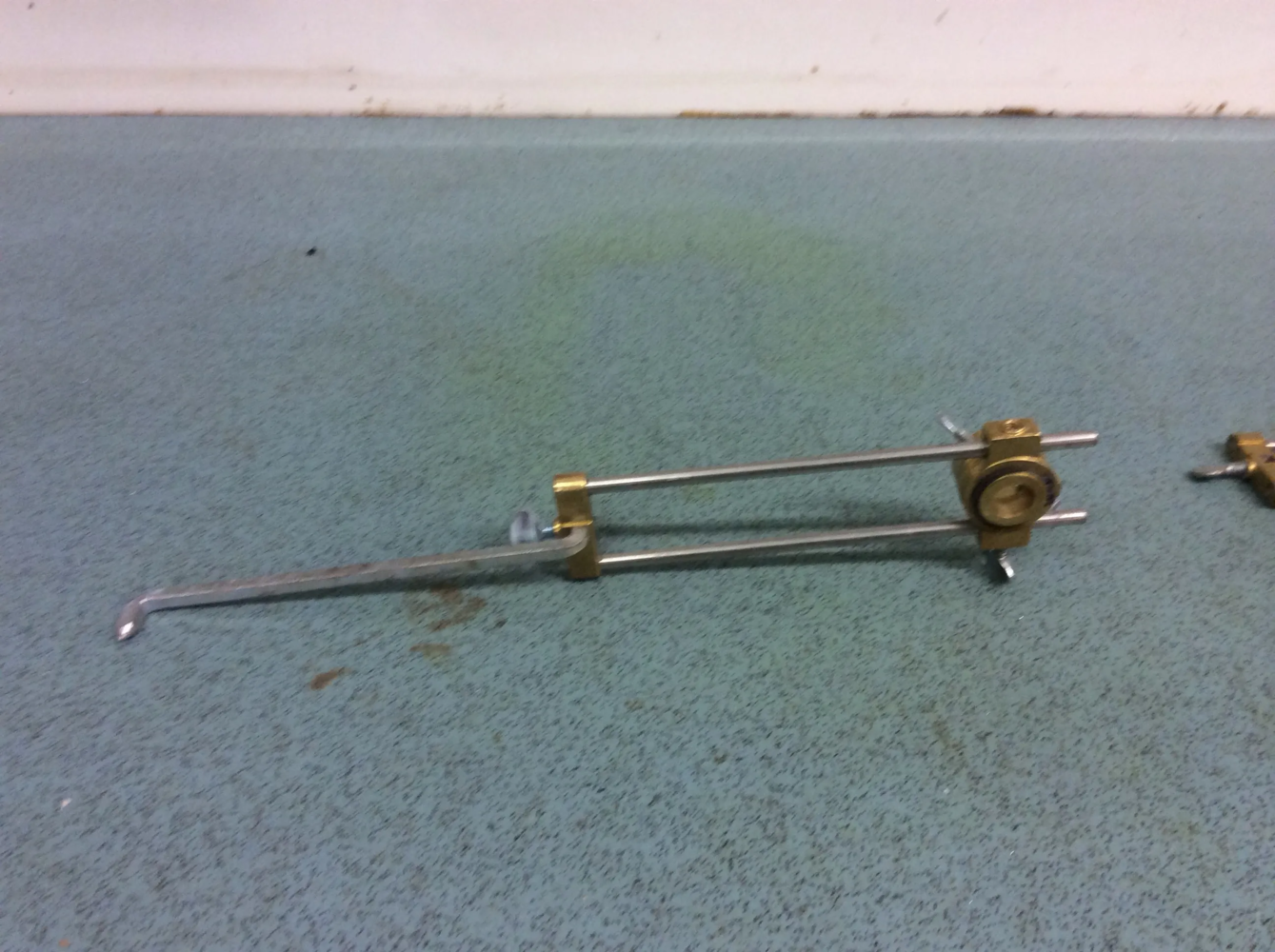

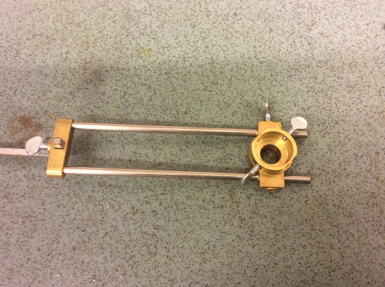

D Dave89 New Member Messages 1 Location West Mids Nov 7, 2022 #1 Can anyone recccomend a genetic circle Cutting tool for my LG 50 plasma HF. Had it a number of years but i’m in need of a guide really. Preferably magnetic

Barking Mat Cuddler of hedgehogs. Messages 13,610 Location France, Brittany. Nov 7, 2022 #2 Welcome. Generic. Any idea what torch you've got on it ? Lidl had some cheap last month, when selling plasma cutters.

Dev 8th generation, Weyland type Messages 1,422 Nov 7, 2022 #4 Barking Mat said: Lidl had some cheap last month, when selling plasma cutters. Click to expand... i have it - the magnet hasn’t enough oomph to stop it slipping

gordon stephenson Member Messages 7,430 Location Skelton in Cleveland U.K. Nov 7, 2022 #5 I Made one quite a while ago now, Search and you may find the thread,
T Turbo Member Messages 8,681 Location Fermanagh, Northern Ireland Nov 8, 2022 #6 Dev said: i have it - the magnet hasn’t enough oomph to stop it slipping Click to expand... Also, the PT31 torch is a sloppy fit in the holder, cured with a few turns of electrical tape!

8ob Member Messages 14,394 Location Nescient in the vale Nov 8, 2022 #7 I bought a basic universal circle cutter, works ok with drag tips on the plasma cutter and the OA cutter.
