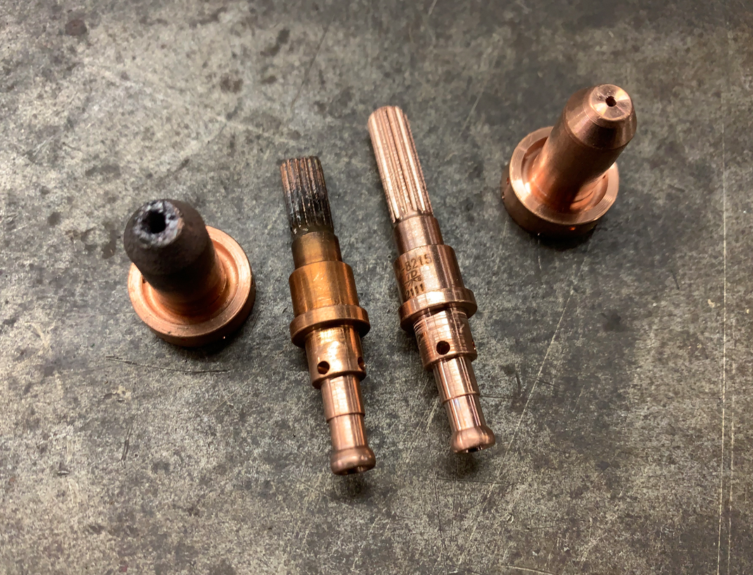

So today I finally got around to looking at the plasma cutter, this is what I found, amazingly with new consumables it now works perfectly!
I have to say it is bit of a weapon, 10mm plate with no effort, I had a job moving my hand fast enough to keep up with the cutter.
