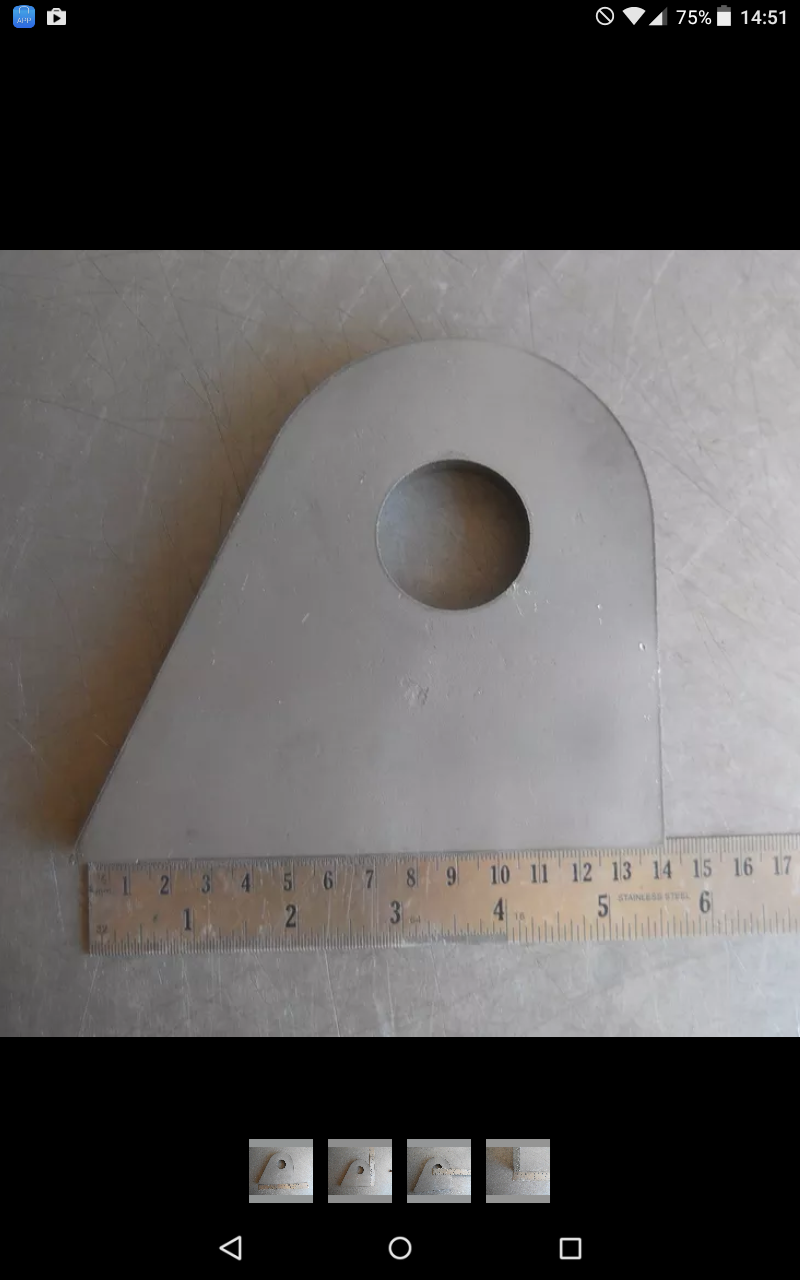

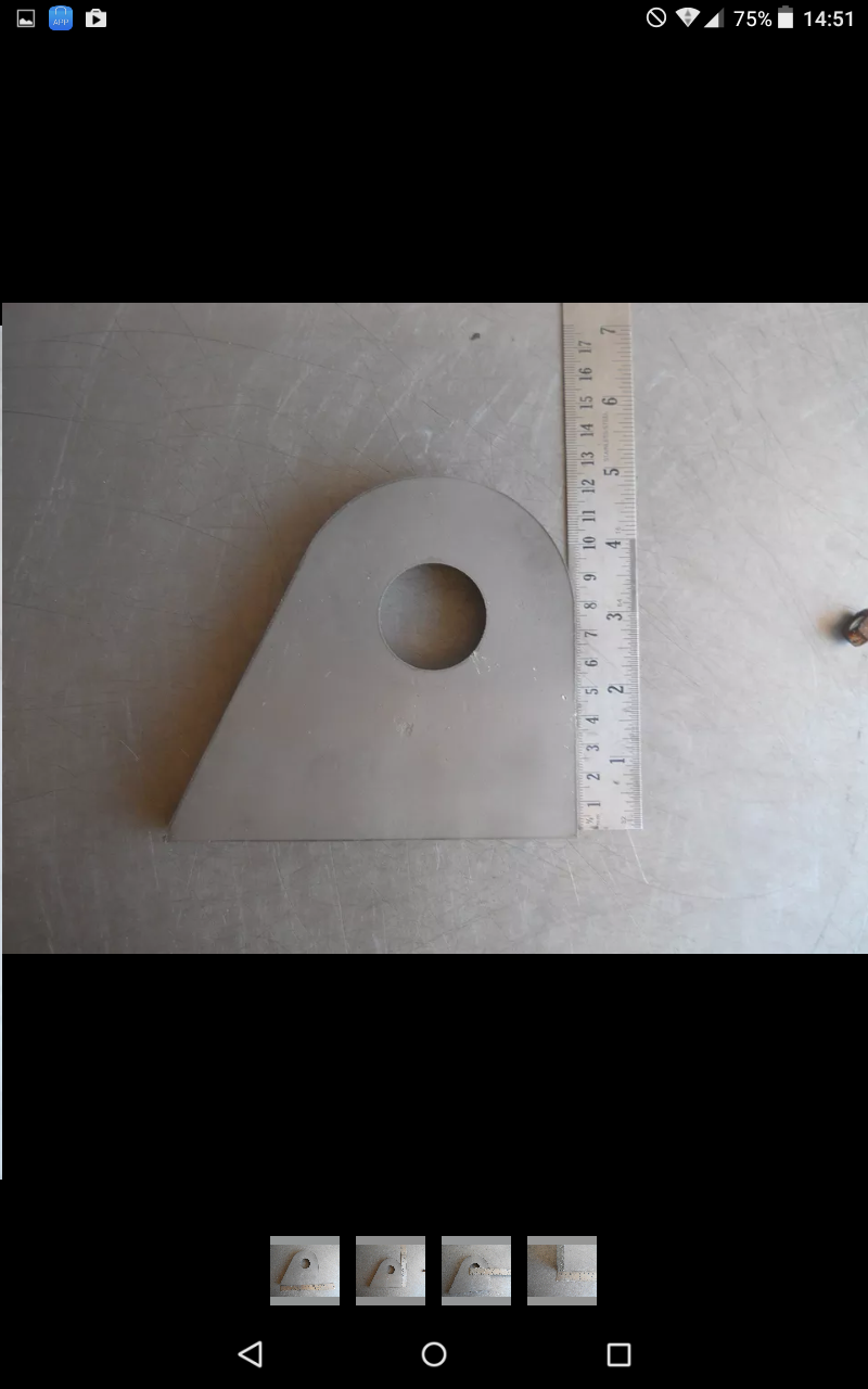

Sorry for the late reply. What's the distance from the edge of the hole to the right hand side?140mm across bottom, 125mm up, 35mm hole located 60mm from bottom just exactly as in pic 15mm thick steel how much for two thanks

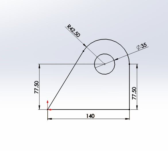

I made it 47.5mm? And 77.5mm, as you say.Looks to me like it is the bottom of the hole that is 60mm up so the centre would be 77.5mm up. If that is correct then likely 42.5mm in from the right hand side. Pic below showing what it possibly is.
I just reckoned that it would be 42.5 as that would make the upright join the arc dead on a quadrant. Not at computer so can't draw to see what difference it would make. Regardless there is a dimension missing, either distance to hole centre on x axis or angle of side is required.I made it 47.5mm? And 77.5mm, as you say.
Correct. I used the radius plus the 30mm for the X axis, and I already had the Y axis. I then pulled a concentric circle to the edge, which took it to withing 0.026mm of overall height, which I'm guessing is close enough. The angle would have been helpful, but as it was I just pulled a line from the left hand corner to meet the radius, then trimmed it all up so its a continuous line for the laser, and it looks very neat.I just reckoned that it would be 42.5 as that would make the upright join the arc dead on a quadrant. Not at computer so can't draw to see what difference it would make. Regardless there is a dimension missing, either distance to hole centre on x axis or angle of side is required.
