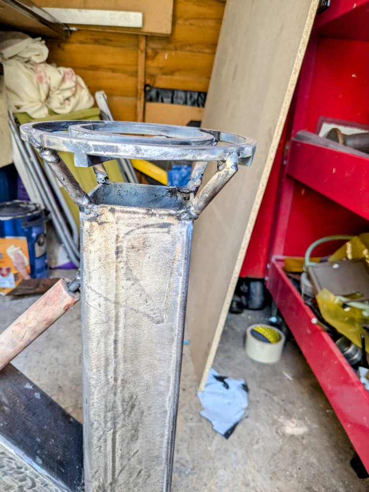

Think i've missed a trick thereTurn the outside skin into a water tank & heat the water to wash your dishes![]()
Would you need a copper pipe? I'm guessing the rocket stove box is inside and would radiate heat into the surrounding water anyway. Seal up the bottom, add a fill point and a drain off tap & jobs a good un?Think i've missed a trick thereThe bottoms open with a removable plate but it would be impossible to get a copper coil around the chimney part now
Thanks for the input GRW, Now I'm close to finishing, these could be one for the futureWould you need a copper pipe? I'm guessing the rocket stove box is inside and would radiate heat into the surrounding water anyway. Seal up the bottom, add a fill point and a drain off tap & jobs a good un?
Edit: and a high level breather/ overflow pipe?
I like the idea for the top Gaz, i'm gonna chew on it a bitif you look at this build you will see the step out for the insulation layer
the hot plate will give you a good area to fit fans upon to blow heat around the shed area dont forget to include the replacement top they do burn out at the max heat point above the flames
putting box section on the top will form a type of grill fins for air to blow through or even pull through as they will heat up rather well
its not chew on it it gives heat off of it and that you can use that to good advantageI like the idea for the top Gaz, i'm gonna chew on it a bit![]()

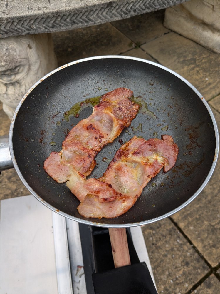

Thats upsettingCooking good
ive been doing the same as wellCooking good
