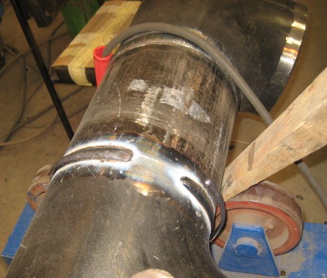

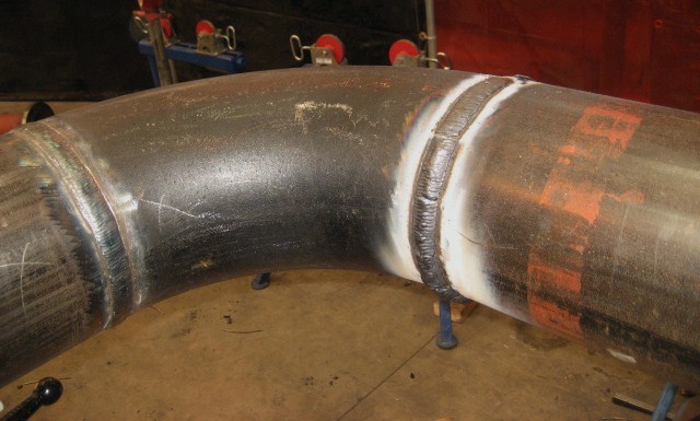

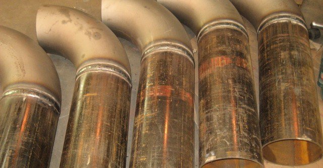

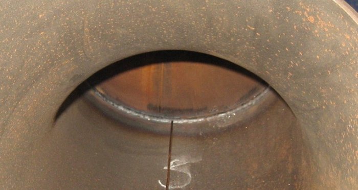

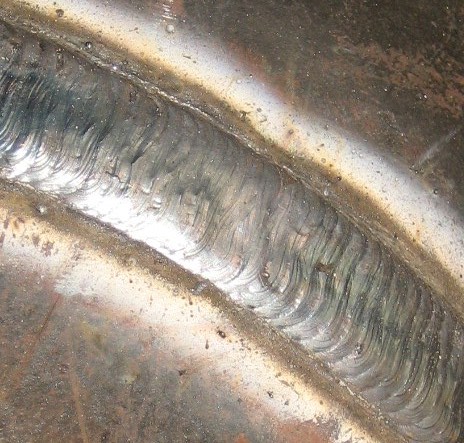

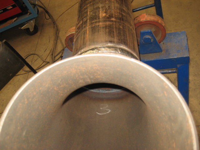

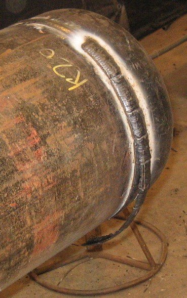

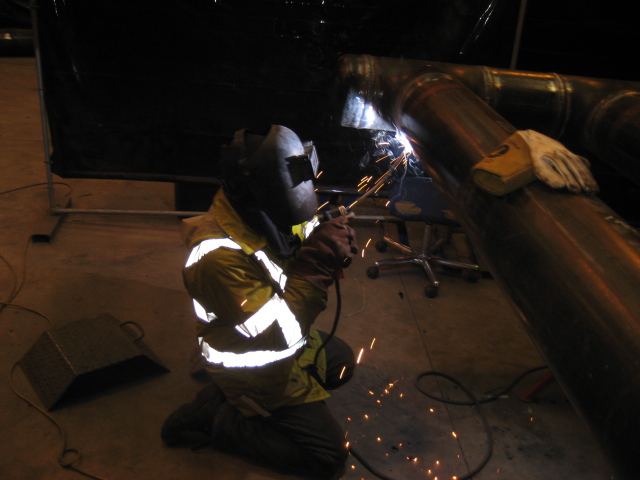

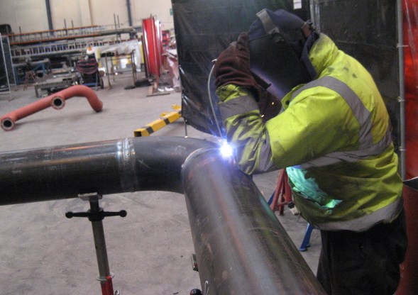

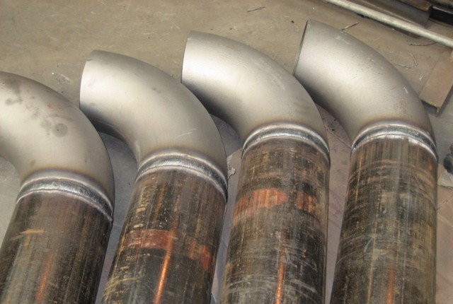

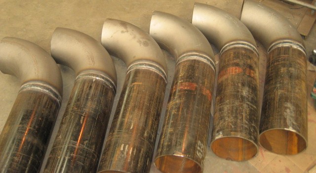

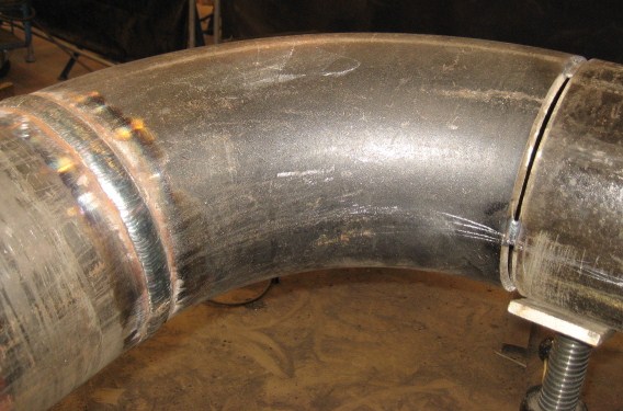

.thanks as always lads heres a bit more. f/j.
) but are there any technical reasons why you wouldn't use MIG on mild steel tube ? I was just thinking that it might be quicker - especially for the cap. Plus no slag to celan / sweep up afterwards ! Would appreciate your thoughts.
