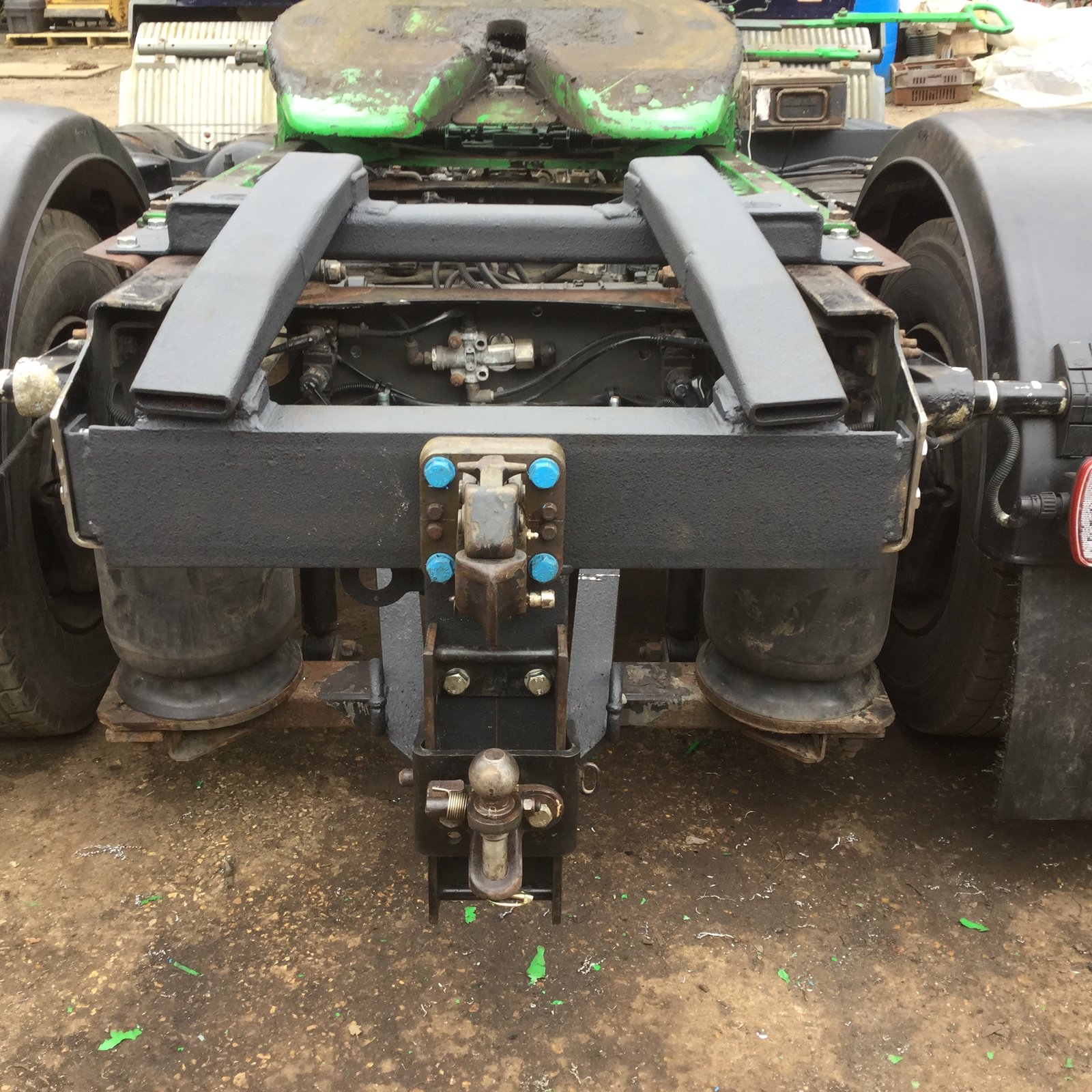

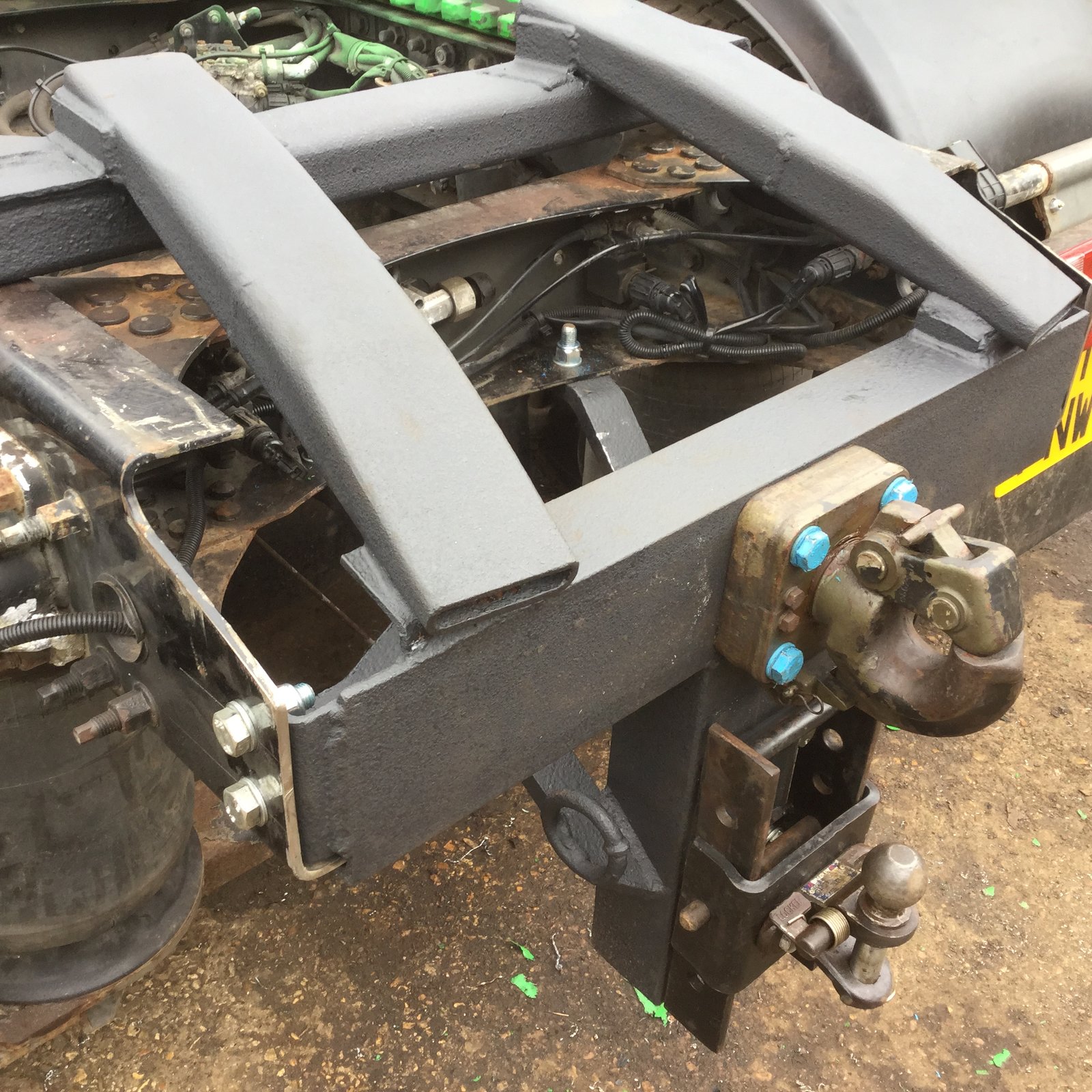

Aside of the hitch type the height is an issue. I made up a drop plate for the urban artic and the correct height for the nato hitch can be gauged from the picture below.
