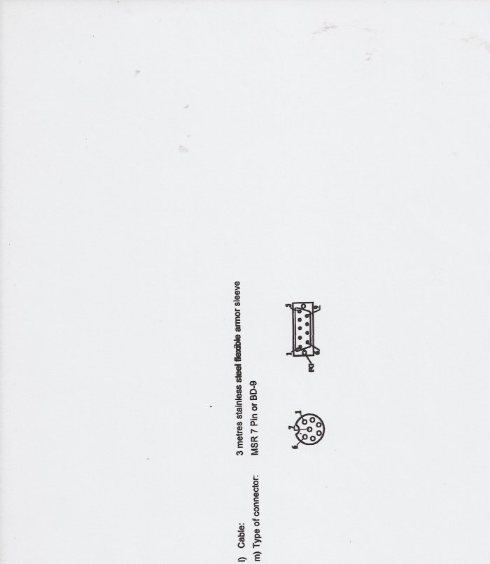

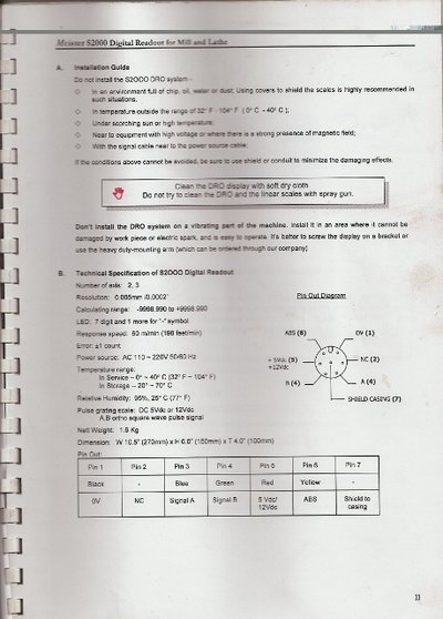

I have a spare set of scales and Readout I want to put on the radial arm, Problem is the scales are Mitutoyos and the box is a Singapore special.
Looking at the Specs on the 2 compatibility shouldn't be an issue both are 5V with 2 Chanel's of TTL square wave for the phases.
Now here is the problem, The scales have 1 type of plug, the readout another, I have found a Pinout for the Mitutoyo part, but not the actual readout, so is there anyway I can find which pins the Readout uses for Phase A/B and reference, +5 and 0V shouldn't be an issue to find.
