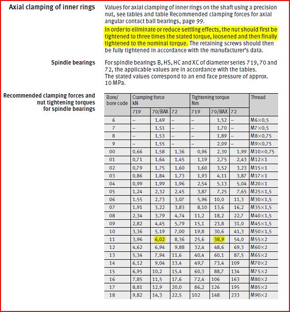

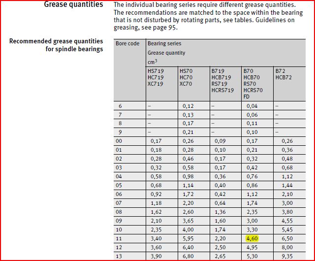

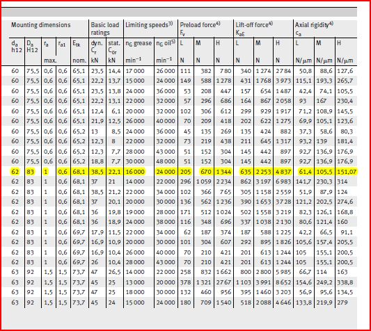

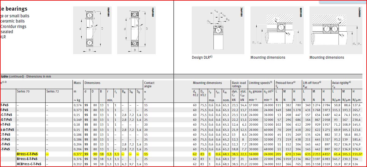

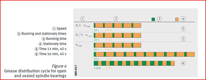

Pete. Forum Supporter Messages 15,055 Location Kent, UK Aug 7, 2019 #21 I used FAG bearings and their technical document go into great detail.

indy4x Forum Supporter Messages 3,661 Location Pontypool, South Wales. UK Oct 8, 2020 #24 Yeah, spindle was sorted and running fine, kept checking temps etc when 1st done and not had any problems since Am a little limited on space, would love something Bridgeport size or thereabouts but they are all too big. Am in negotiations over a Warco 4vs, it's more heavy duty than the VM-F, slightly bigger table and will just about fit in the space I have
