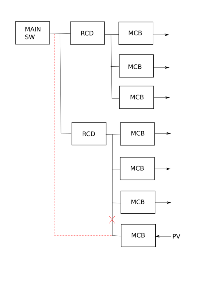

Just to be clear, that schematic wasn't out of the inverter manual, that was in some docs generated by the installer. It all looks very 'boilerplate' to me but it does match what I can see in the pics.You can't satisfy the house's requirements for 30ma and the inverter's requirements for 100ma in the same consumer unit. It's confusing that the manual shows this layout but maybe in other countries it would be acceptable.
I would show the installers the fact the manual states the inverter needs 100ma and ask them to fit that from a separate feed. They really ought to have done this anyway in my opinion.
I've got a copy of the paperwork, the solar inverter is a Huawei SUN2000. In the manual it says if an external RCD is used, it should be a type A with a trip current at least 100 mA. I can't see the markings on the ones in the CU, but they look like the original MK ones from when it was installed, so probably 35 mA?

This.You don't want to swap the RCDs out, 100mA isn't suitable for protecting final circuits - if the unit requires one they will have to split the tails and put it on a seperate CU, which is the better solution to be honnest.
You will probably get some pushback on that though as it will mean pulling the main fuse - might be a good time to get an isolator put in as well, sometimes the DNO will fit them.

According to the inverter manual, it has an internal 100 mA RCD, the note says any external RCDs in the circuit need to be rated the same or higher.This.
The installers need to follow both the manual and the regs. They should have fitted an inverter that was happy with a 30ma RCD if they wanted to do it the way they have.

The inverter won't fire up and deliver power from the PV panels to the mains if there is no incoming supply present. The solar inverter logic is designed to check that the incoming supply voltage, impedance and frequency are within set limits, before delivering power to the electricity network.Just turning off the inverter should do stop the tripping. If that's at fault.
Not qualified to comment on your wiring suggestion. I suspect that the wiring should have protection at both ends. After all, electric can come from either the grid or the inverter.
i was working on a job other week it had one mainswitch and one rcd . the mainswitch controlled 4 nightstore heaters fed with tails to the off peak supply and the rcd was used as a mainswitch fed with tails from the domestic supply. i marked it up properly saying isolate both supplies so no one would just isolate the mainswitch thinking the whole lot was offI missed that picture, yes, and it looks like an economy 7 meter too - with the isolator then it should be fairly simple for them to alter things then.
