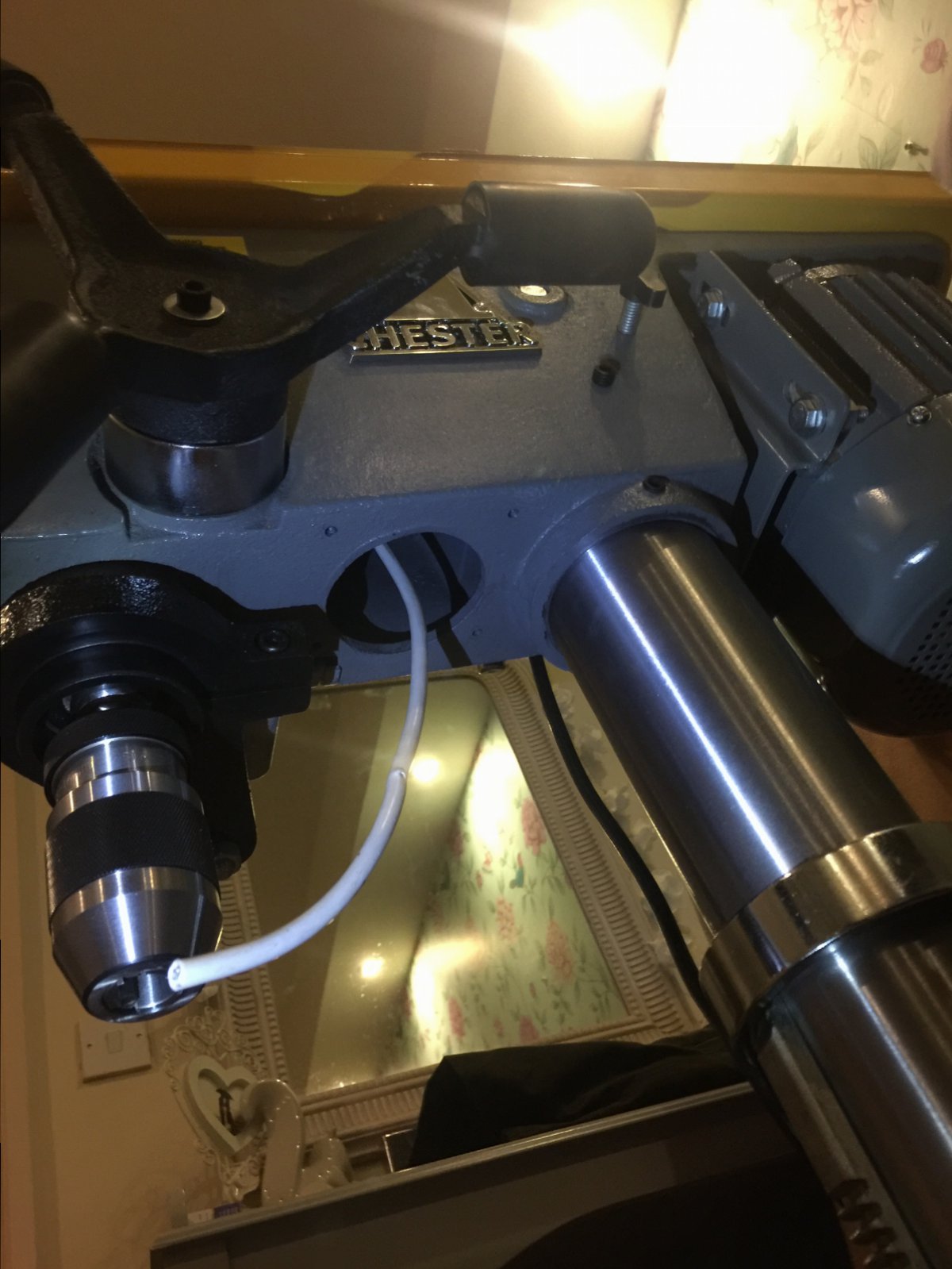

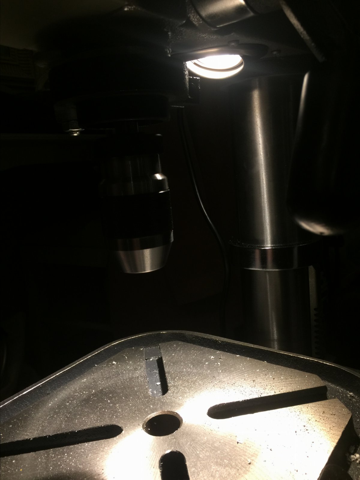

I managed to fit a work light to my Clarke pillar drill, a floor standing model. The head casting had a void just behind the front spindle. After purchasing a GU10 base off eBay, I made a bracket to attach it inside the void. I already had to hand a rocker switch, which I fitted by drilling & filing a rectangular slot in the side of the head casting. The job was completed by wiring up the switch & lamp base from the motor connections which were conveniently wired through the void. The purchase of a 5W GU10 LED completed the job & being LED it's super bright without any heat to affect the wiring.I have a draper pillar drill (230ish volt), it could really do with a work light, any info on make type supplier appreciated.
