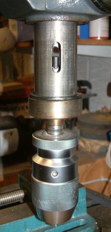

Took a couple of photos of my Clarke chuck & quill.......
With the quill extended there is a slot and rotating the chuck brings the Morse Taper ejection slot in line.
A tapered drift is then used against the Morse Taper tang to eject the chuck using a mallet.
