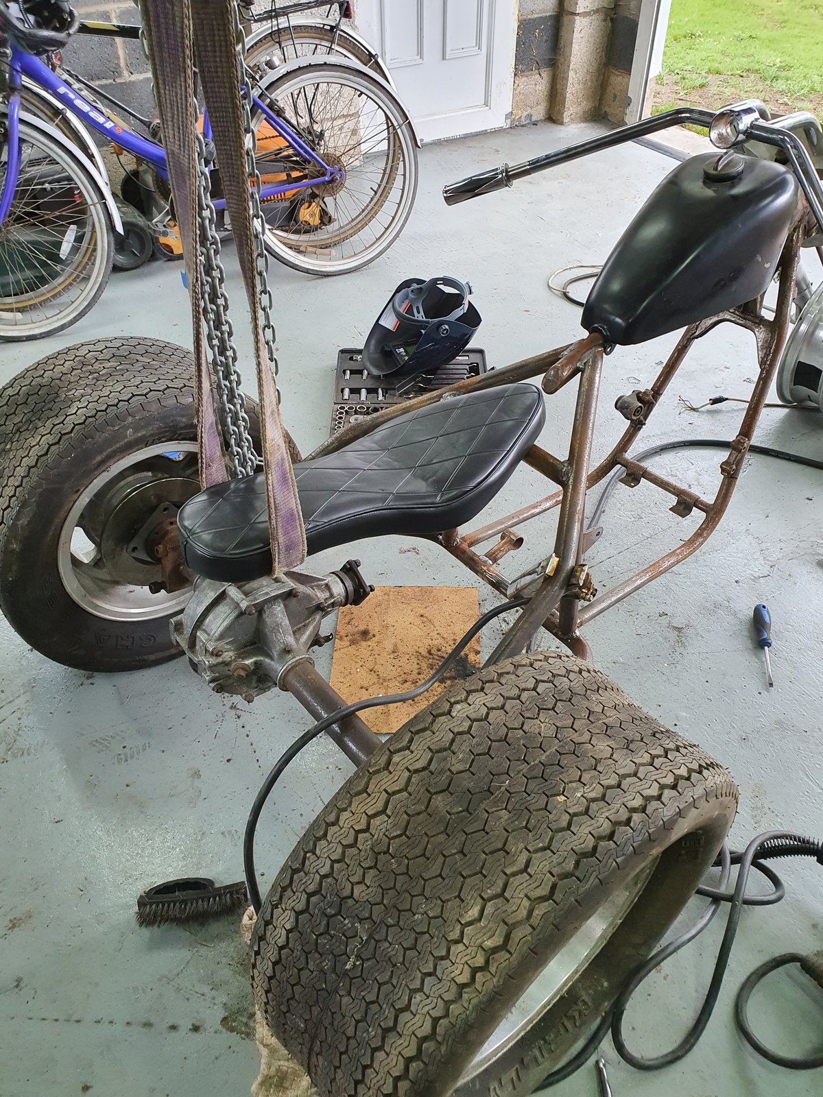

Running linked brakes is doable, but to pass the msva you would need to lck the bias valve so It can only be adjusted with tools.Why not with forward controls ? I was planning on running right foot brake biased front and rear , left foot clutch with a hand shift , harley suicide shift style against the tank

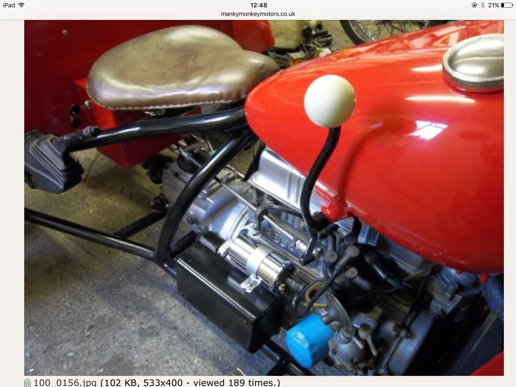

The hand change on the side of the tank may present an issue passing the MSVA as itll stick out with the potential to maim a rider in the event of a head on smash, even your fuel cap needs to be less than 10mm and rounded edges.
This has a foot clutch, and gears are changed using a klicktronic. Front and rear brakes are maintained separatly, having ridden a trike with linked brakes I hated it.
The linked brakes, didnt inspire me with confidence, but also separate brakes have their uses in certain situations.
With beetle based trikes gear change is often under the leg, reliants, are frequently central, but how many have actually been through an MSVA. You can build a linkage to bring it out the side, or just a long bent gear lever.

I know of at least one very well home built reliant that has a suicide gearchange out the side. You can put a big nob on it, even a ring around it to pass the msva. Linked brakes would work, but I accept that once set up for a dry road you might have issues on a wet surface and vice versa. It's not as if you can have a linked apportioning valve...

View attachment 234522 Here you go - from mankymonkey forum, a really well built msva'd trike:

Looking at your pictures again, those forks look like they are from a dirt bike, so will have lots of travel, have you allowed for this in your frame base rail ride height!
Possibly or pre load them with a spacer to reduce available travel.I'm not sure what they are from to be fair there is a bit of travel but not massive amounts, if there was too much can I use different internals to stiffen them ?
