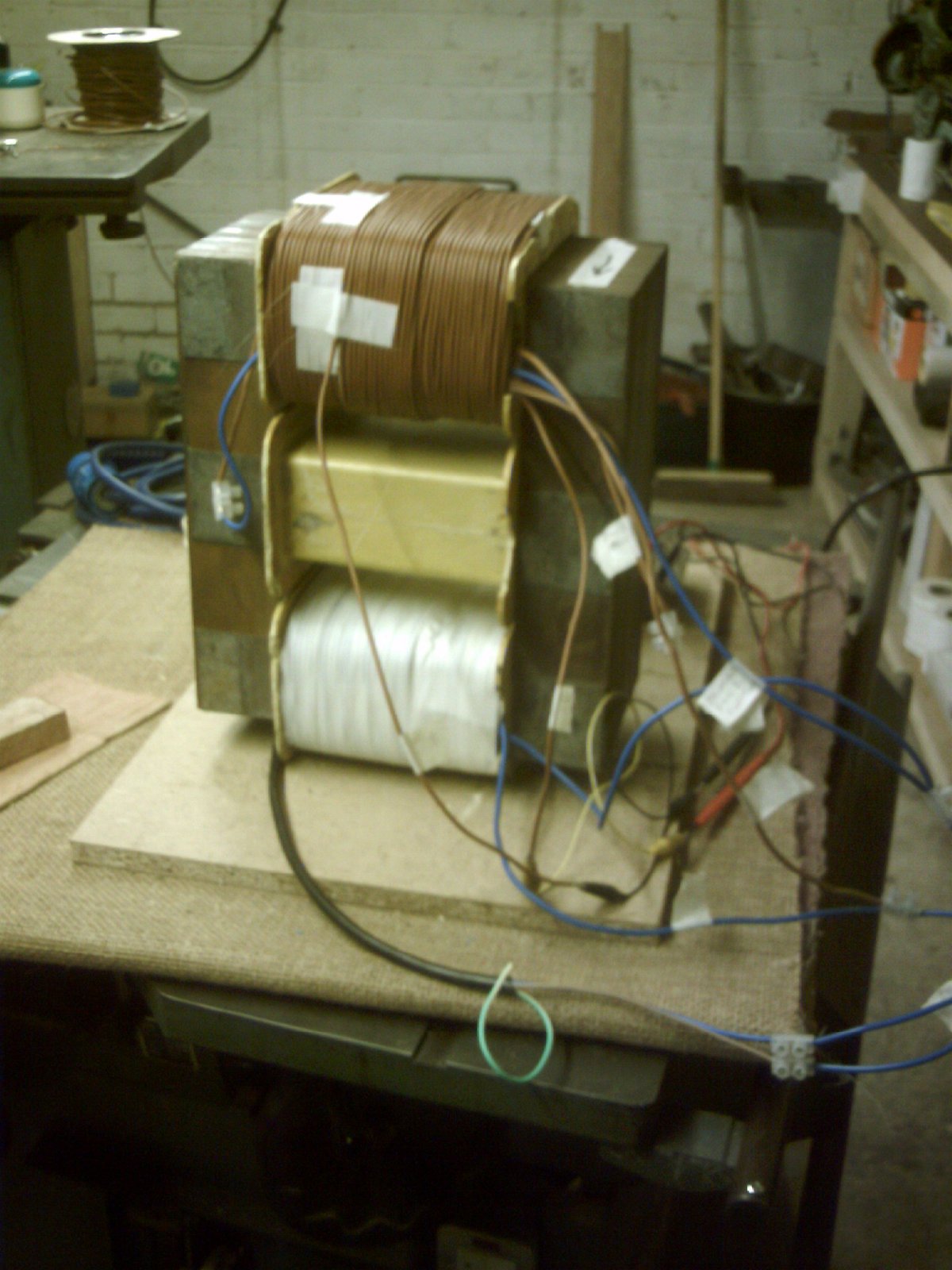

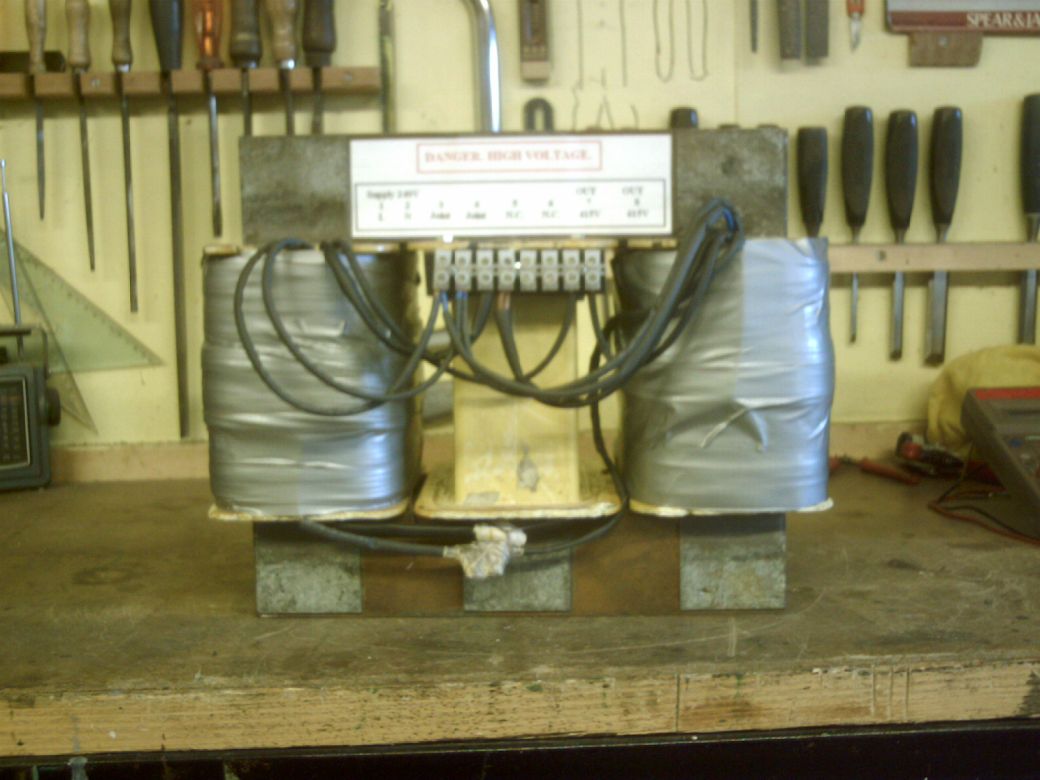

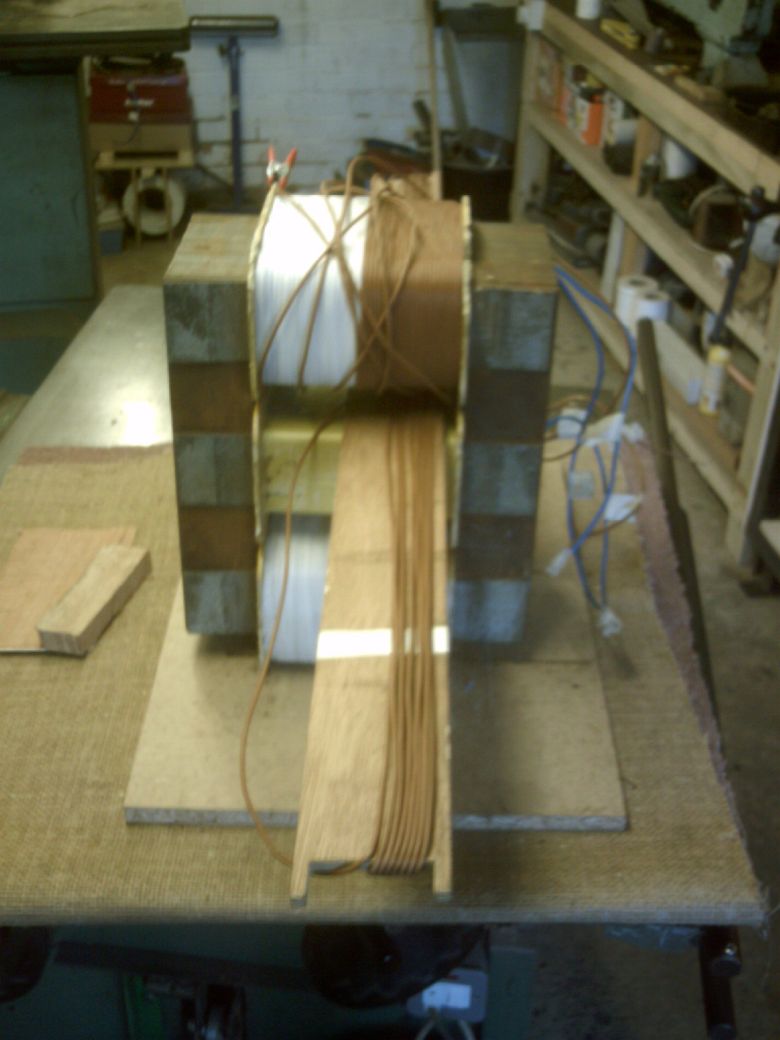

    Hi,
    I ran my own 3 phase 415V installation for about ten years it costing under £120 to install; the transformer weighed around 75kg. I found the details on eBay and spent £17 for the three instructional DVD's from America. It's called "unique3phase" and I must have been the first here in the UK to install it successfully; I used to run my big extractor and ten speed industrial bandsaw from it; this gave full power just like having 3 phase from the electricity company installed.
    I dreamt up using a "shuttle" to add the coils and I'm credited by Doug the creator for this. This big transformer was so quiet I added a large lamp to indicate it was powered up; at idle it only pulled 0.8A. When I had installed mine Doug put a guy in Wales in touch with me; this guy wanted to run two big heat pumps into his farmhouses; I suggested using Doug's transformer method but he decided to go with a big rotary converter; after he had installed it he emailed once again for my advice; the converter was keeping his whole family awake at night due to noise.
    I sold my big machines a while ago and sold the transformer to a friend who is a sparky so I was happy I wouldn't be electrocuting anyone.
    For full details please contact Doug;
    http://unique3phase.com/
    Kind regards, Colin.
    Adding coils using my shuttle idea.
    Rock steady 415V.
    75kg of beast.
    I won't discuss how this is done because it's so highly dangerous and I don't want to electrocute anyone. Please contact Doug direct if interested I'm just adding this to let members know it's available. Here it's on test under power.

    I read on another forum that everything on those DVDs can be found in an evening or two through google - how lazy are we, though?
    It's just a static convertor run from a step-up autotransformer, the "generated" leg is run at a higher voltage than the others to allow for the usual carppy static-convertor motor power loss by boosting the start and run capacitors' source voltages a bit. Nothing magical, not efficient.
