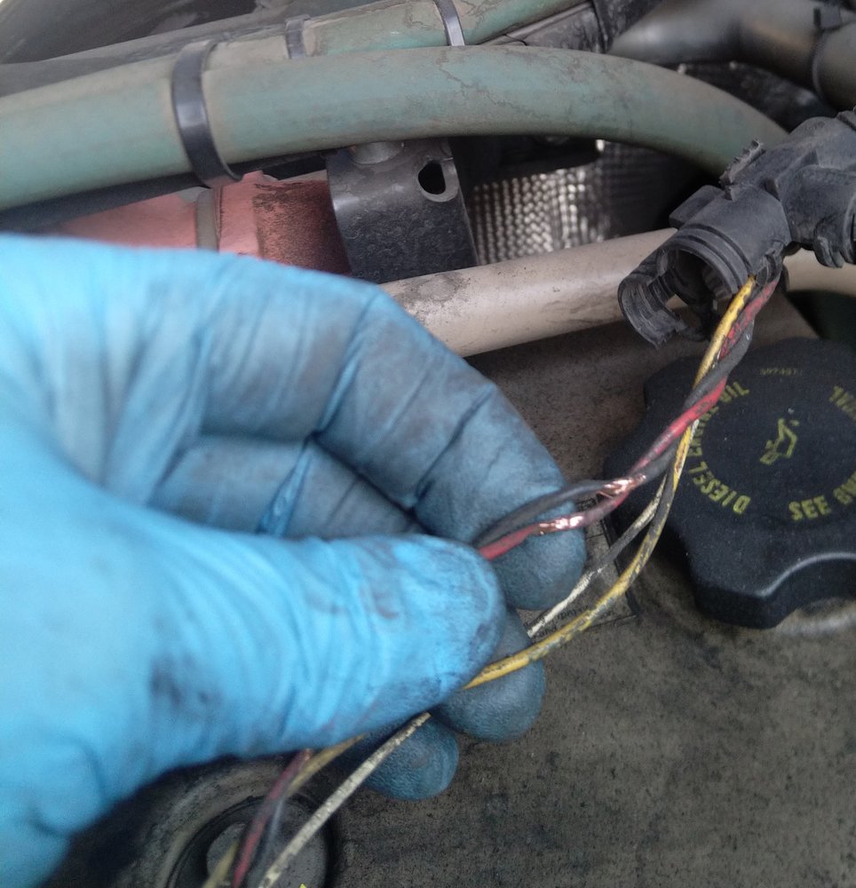

think yourselves lucky Toyota newish previas was £1000 plus job 4 sensors advised to fit all four at the same time due to conflicting data from old and new sensor not matchingMostly unless I fit both upstream and downstream NOX sensors as a pair - I cannot calibrate them.
Then they bring the EML on at a later date.
you been watching South main auto repairs ? mee tooI saw something like that on a US Youtube channel I follow, a dealer identified faults in 3 unrelated modules and quoted north of 7000$ to repair, the auto electrics specialist identified a corroded ground connection on the chassis that the 3 "faulty" modules relied on so cleaned the connection and cleared the faults!
It's all about having good diagnostic equipment, that tell you the actual meaning of the fault code, and the failure reason.Hi, I can just see the fault diagnosis flow chart now. -
