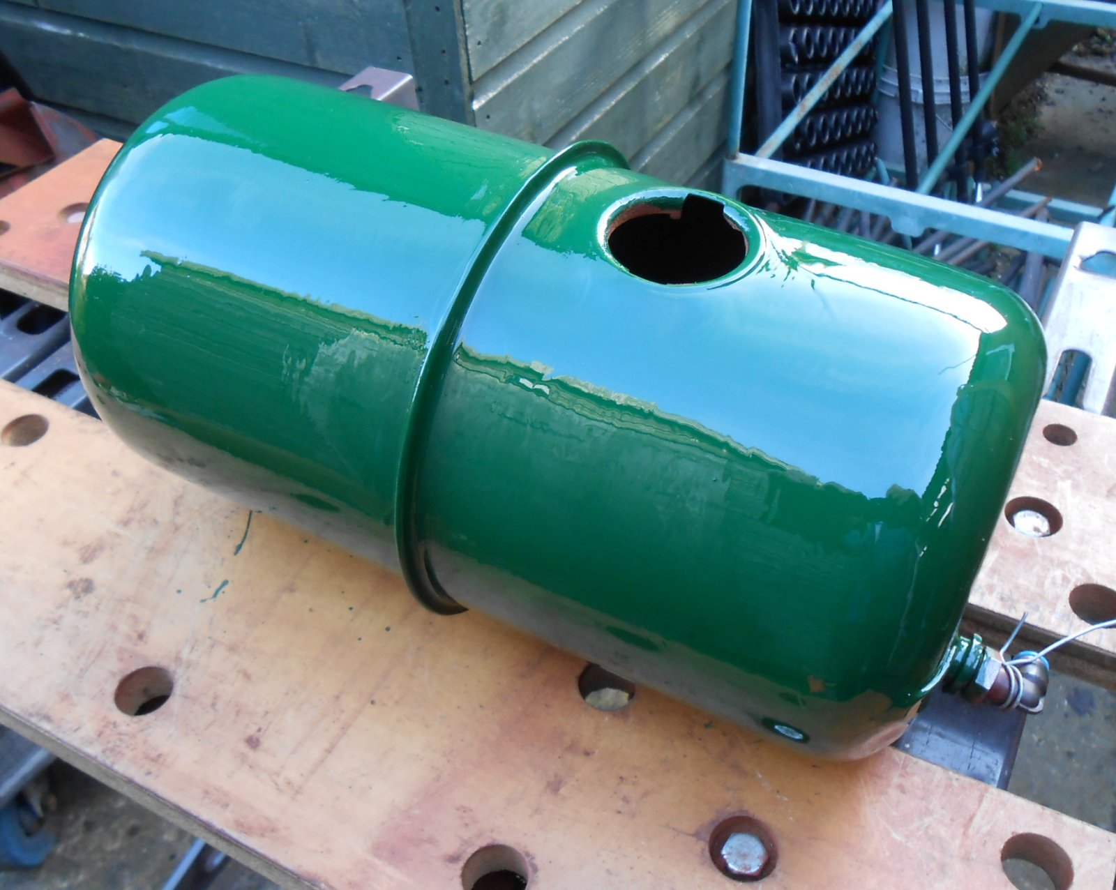

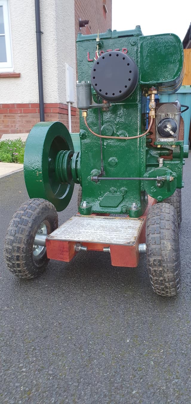

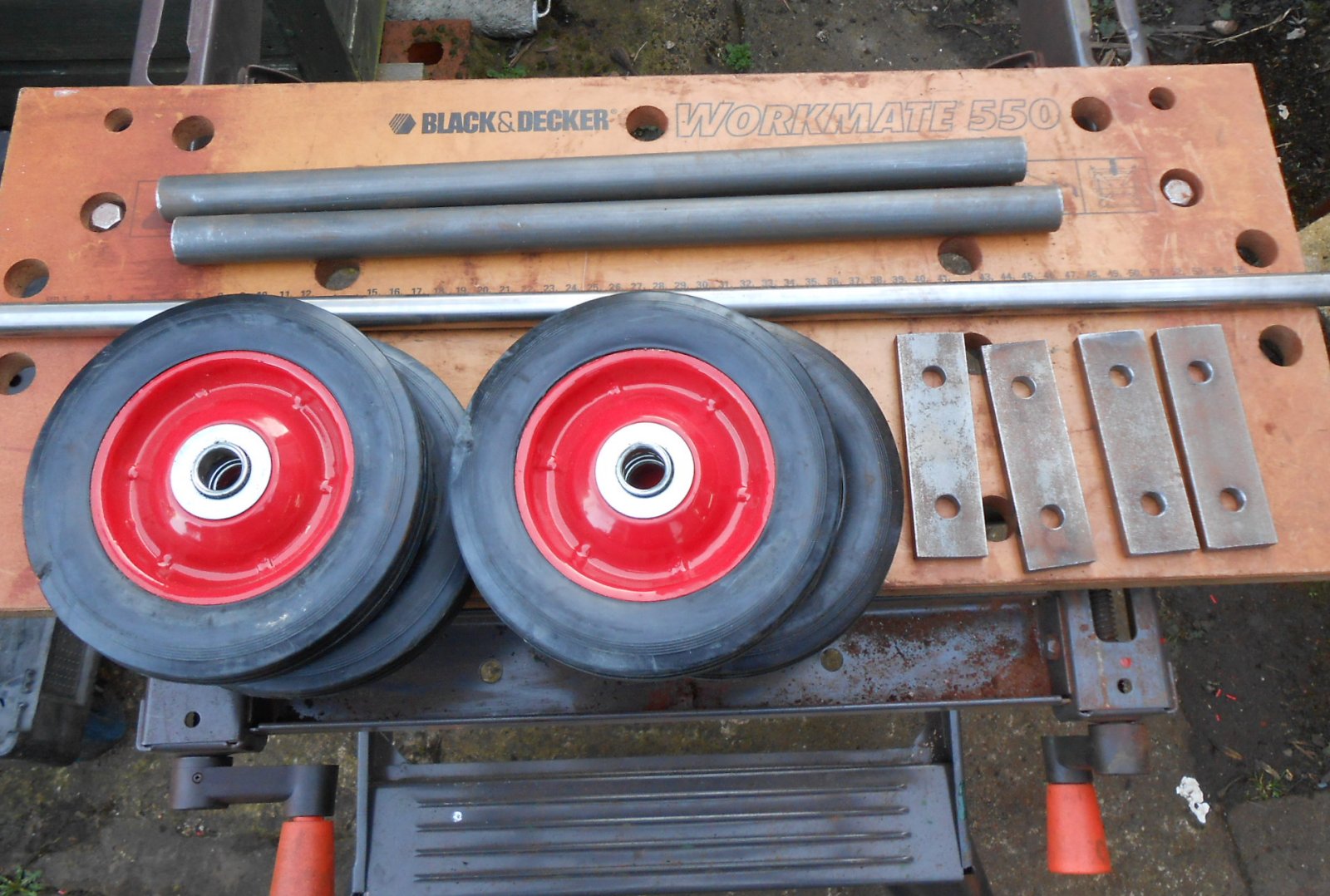

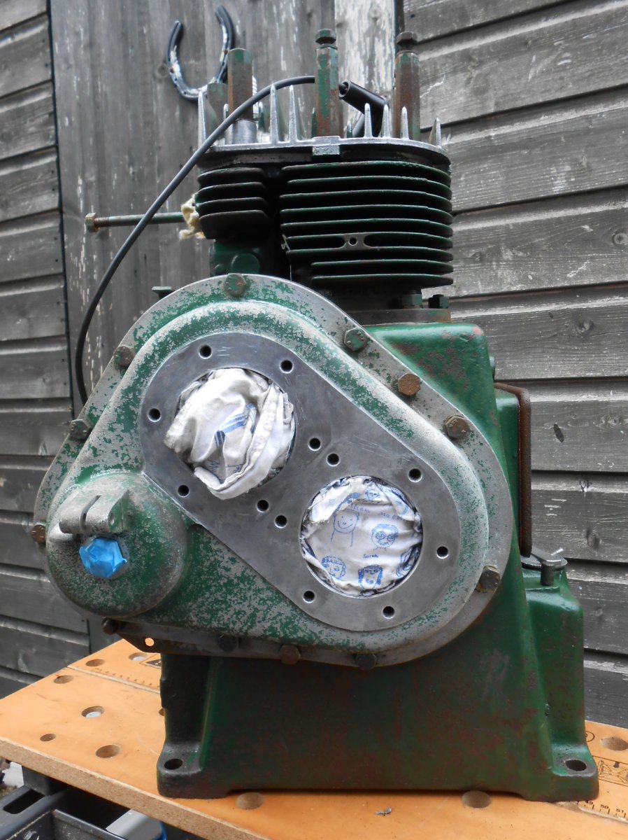

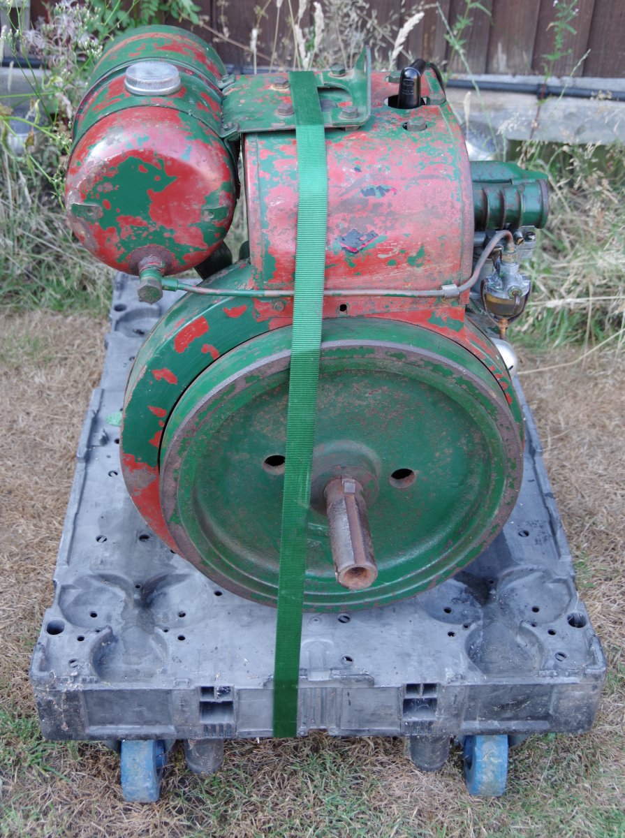

As I've taken lots of photo's as I've gone along I thought I'd do a thread about it.

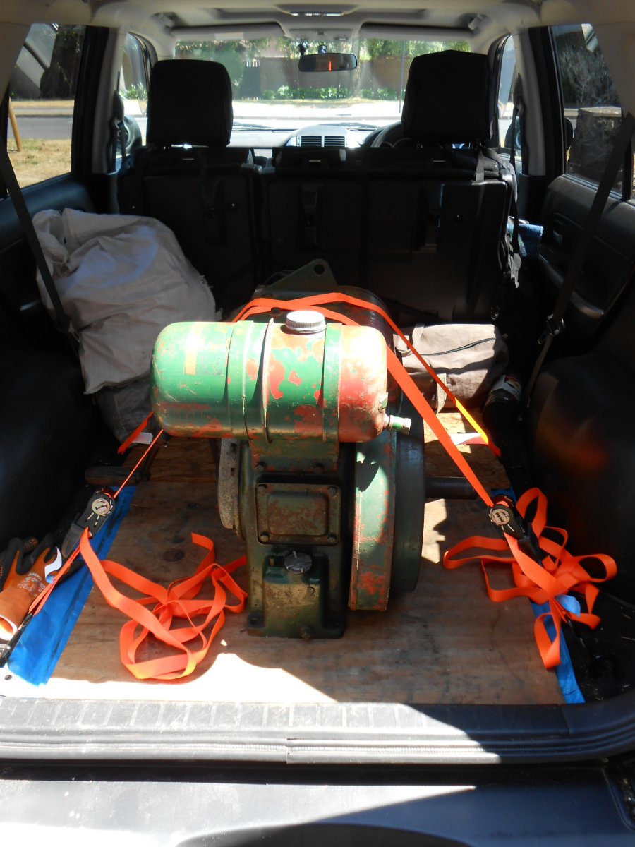

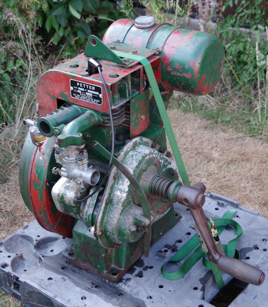

July 2018 - after about 12 months of looking for one at the right price and travelling distance, I found one

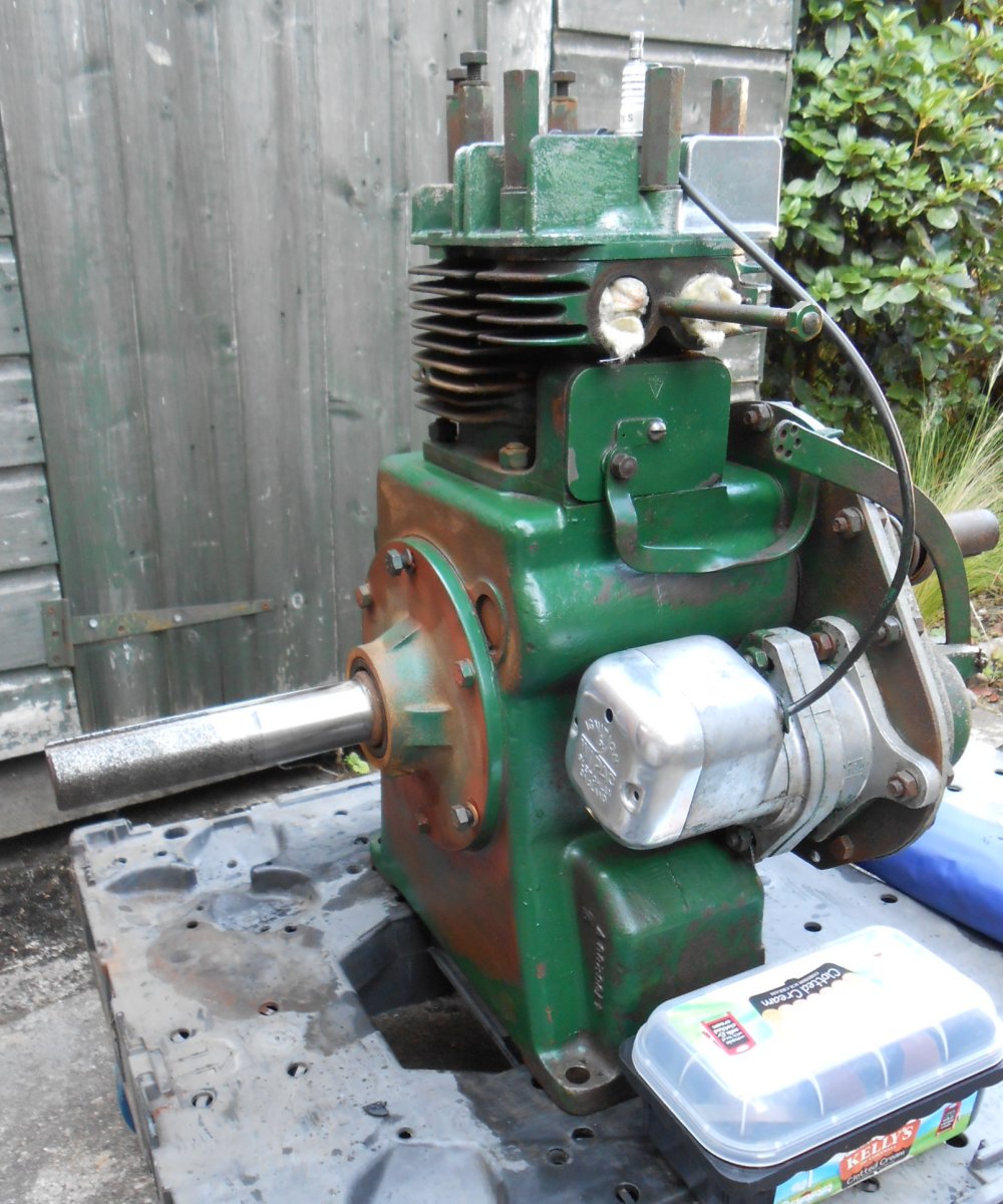

This is how it arrived from Leicestershire...

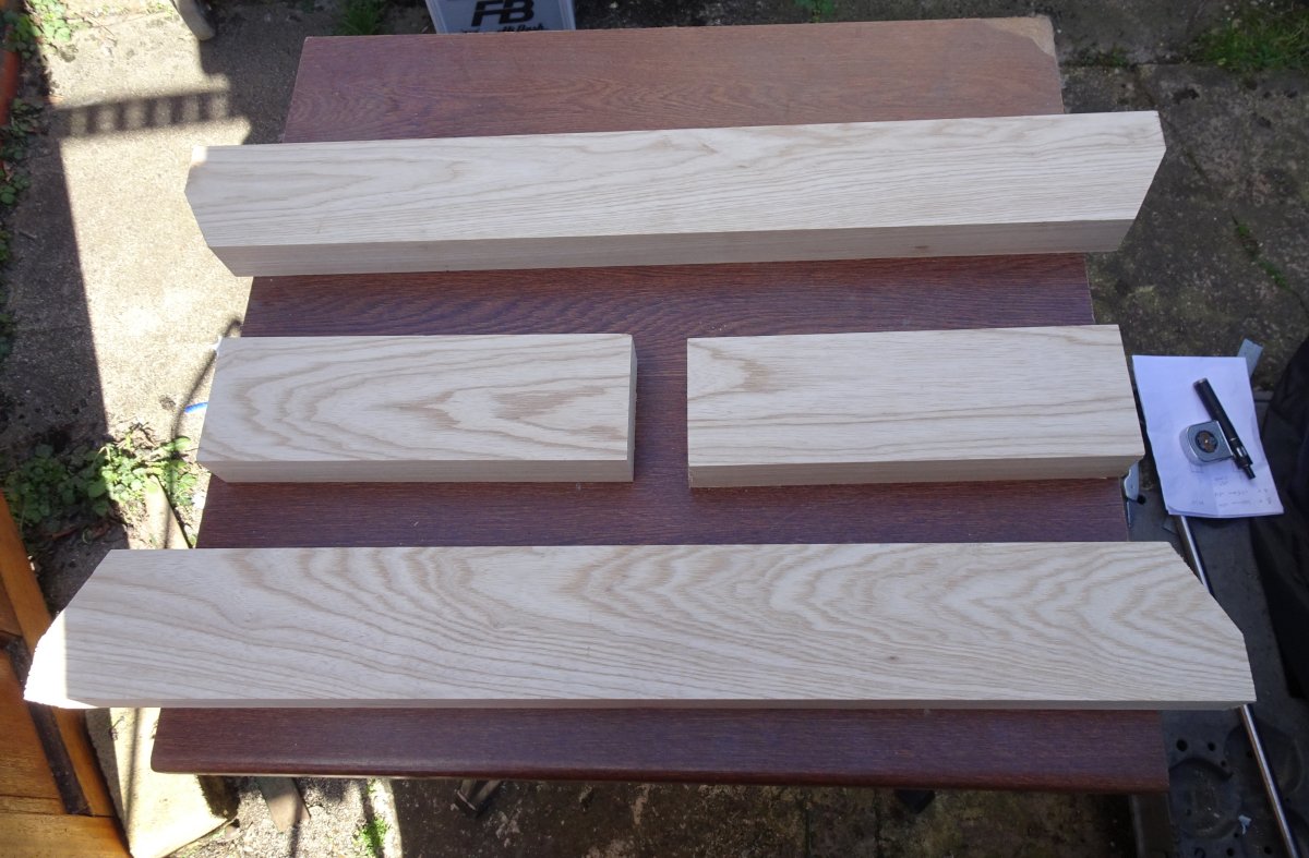

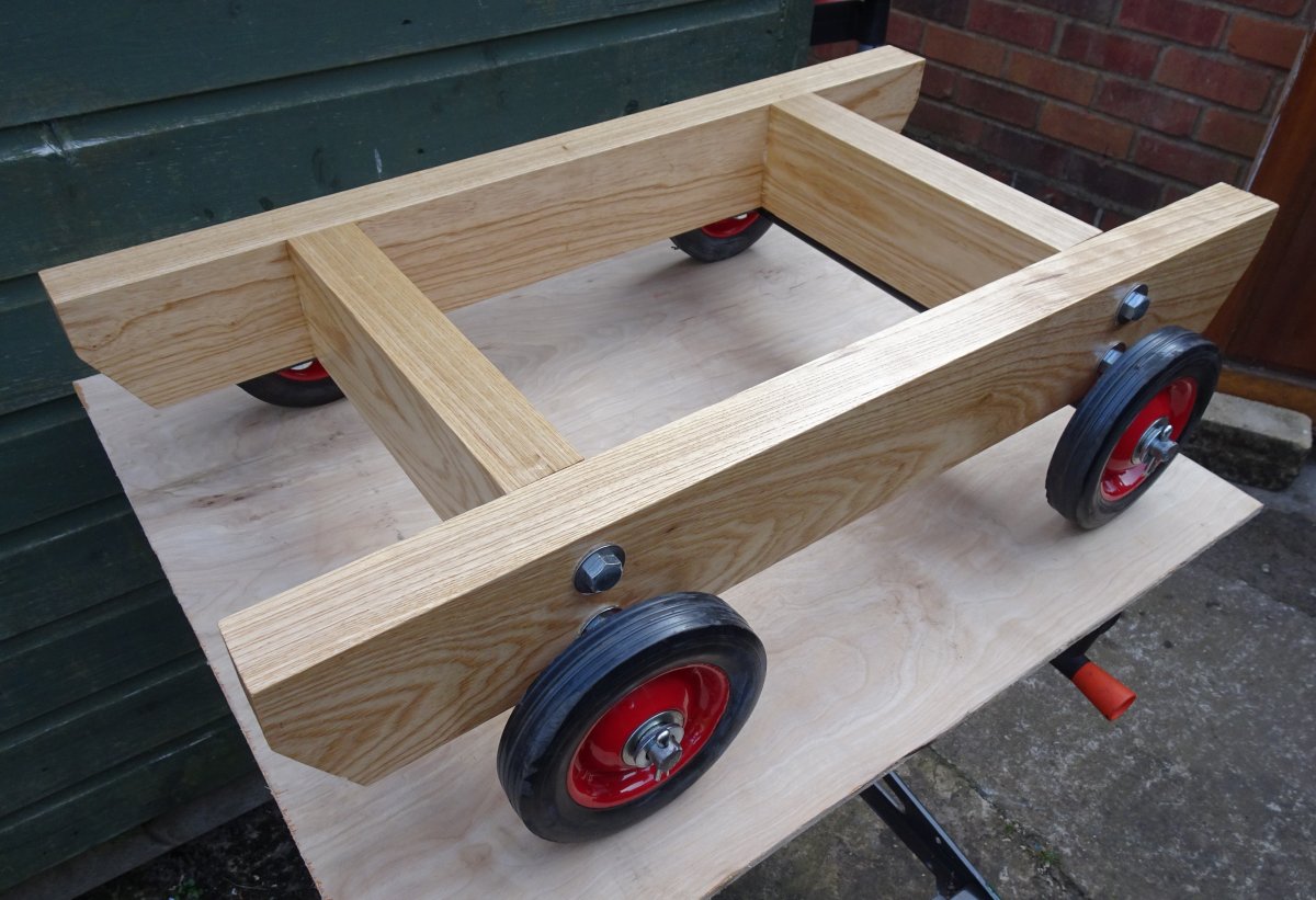

Unloaded onto a temporary trolley so I could have a good look round it...

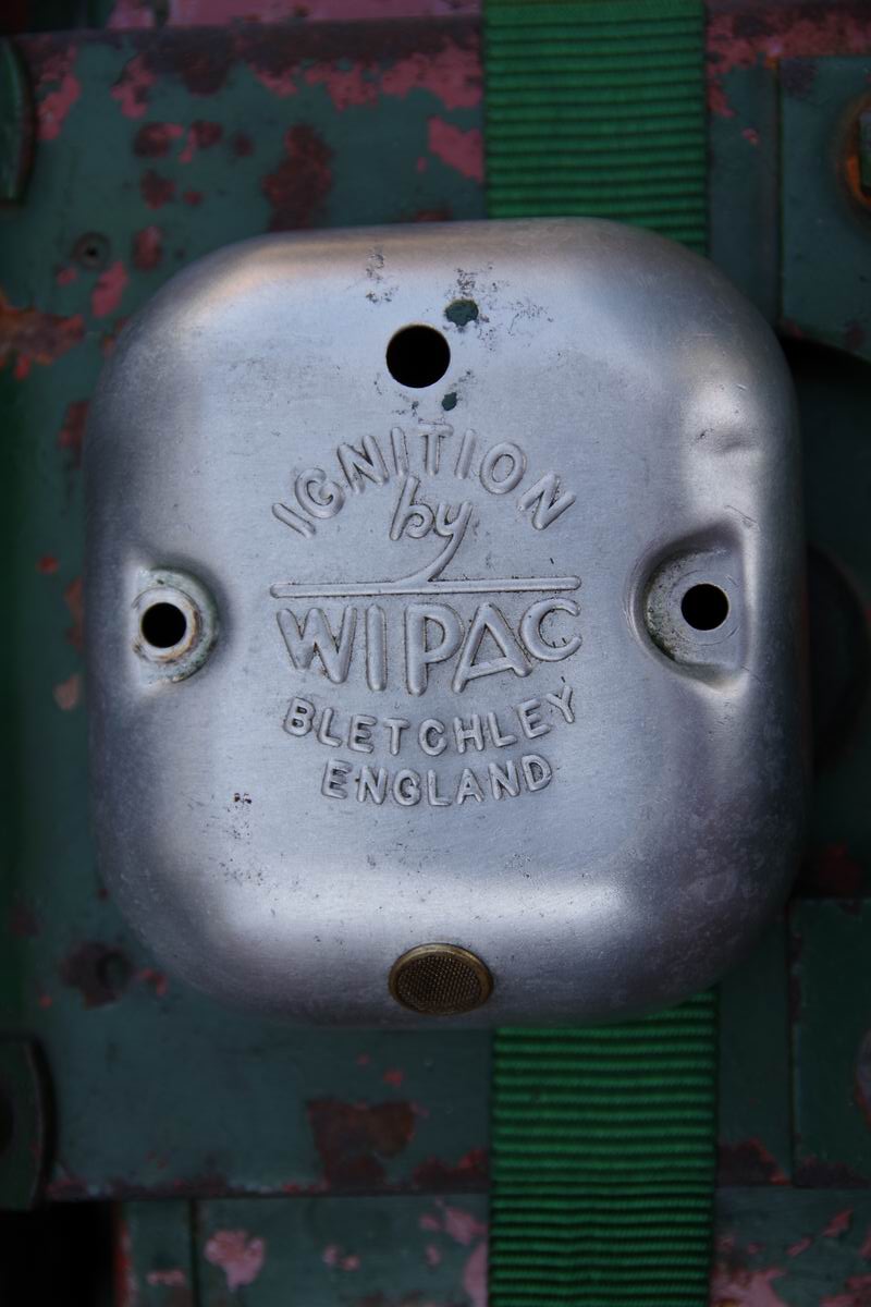

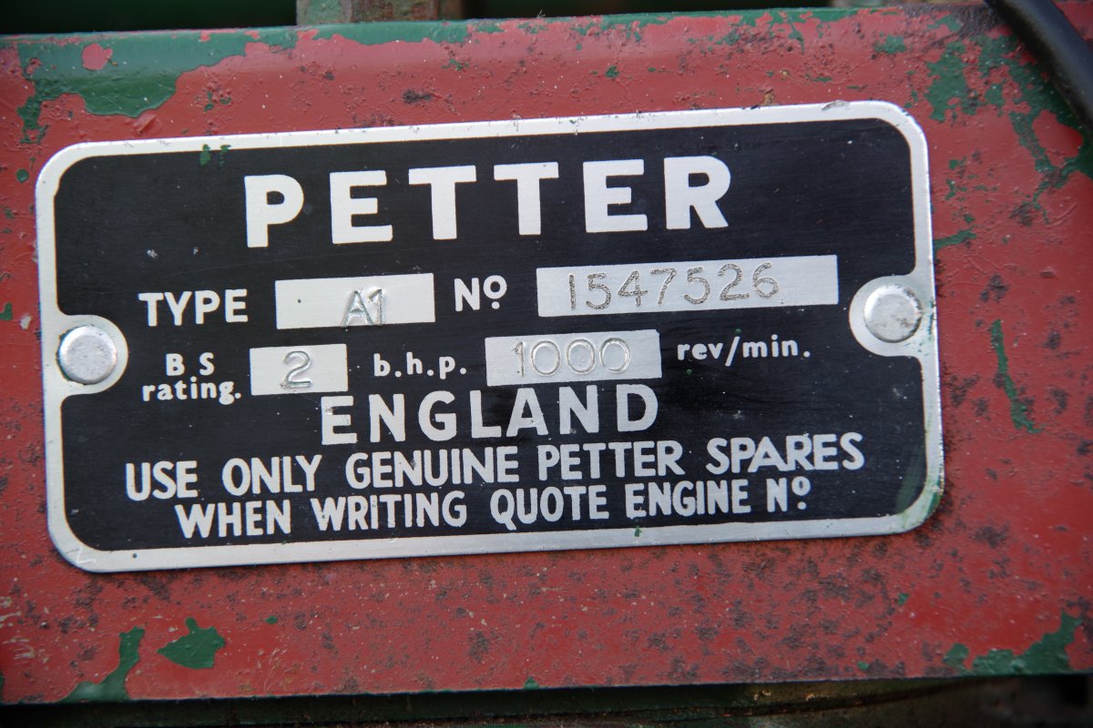

I contacted the Petter historian with the serial No., but he did not have records for the engine as it was built for Petter by J&H McLaren of Leeds...

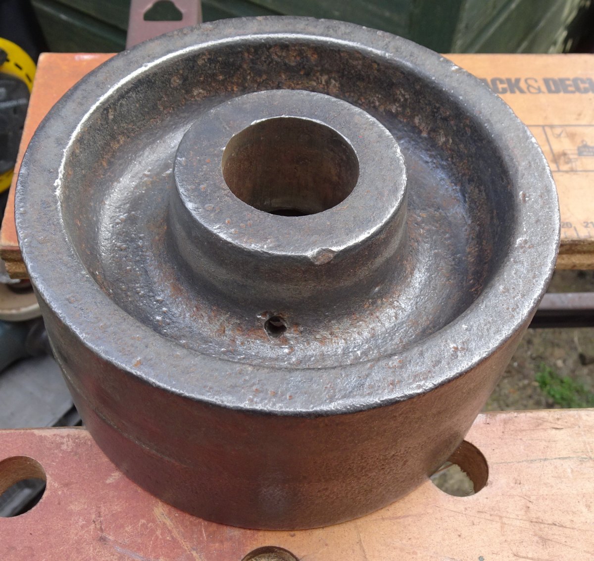

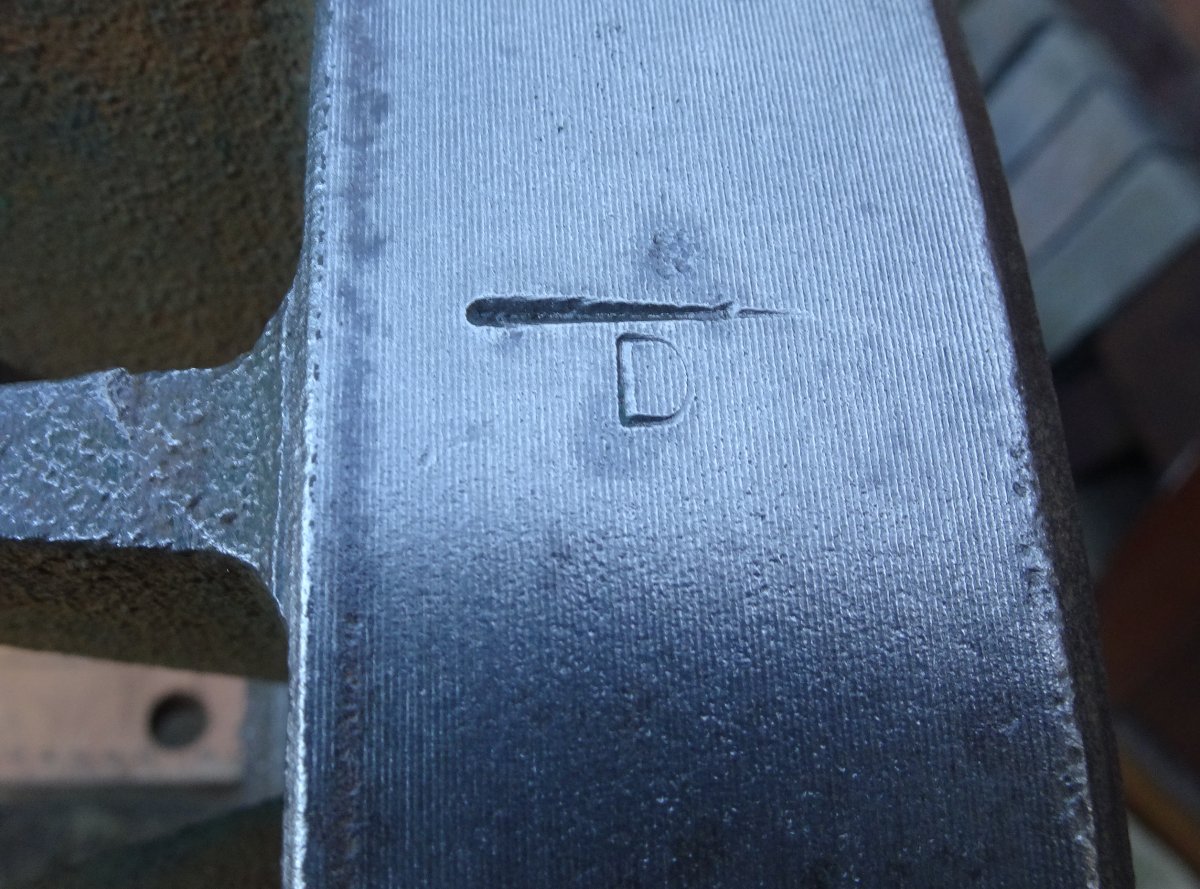

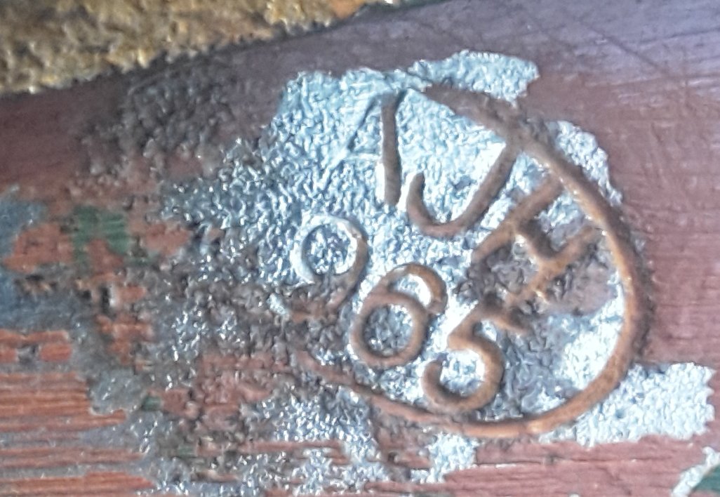

I managed to date it to 1965 by a stamp found in the flywheel cover...

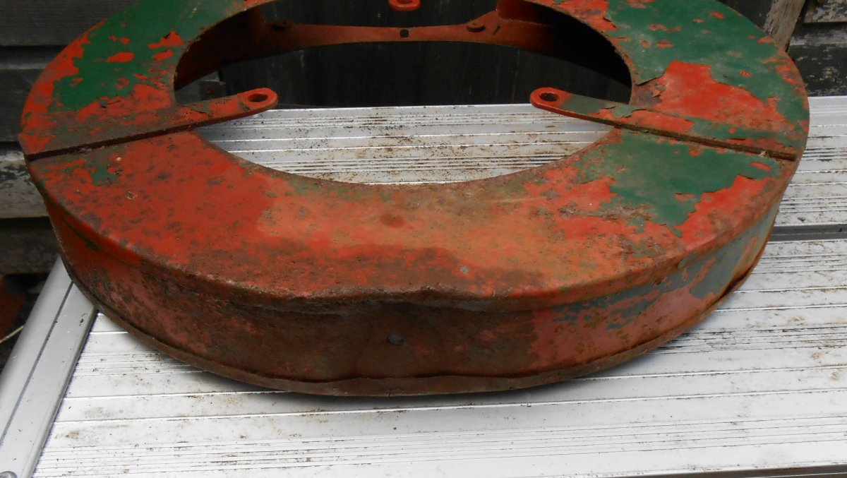

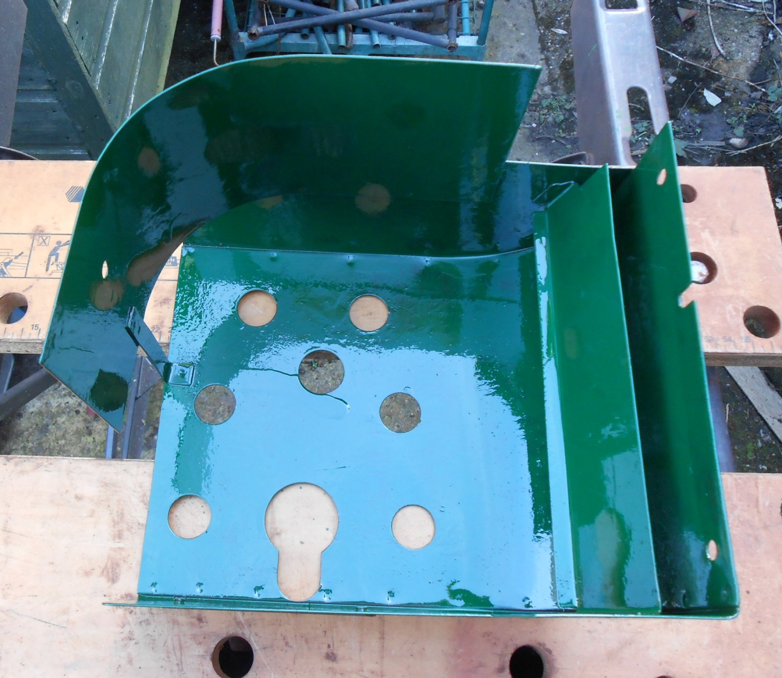

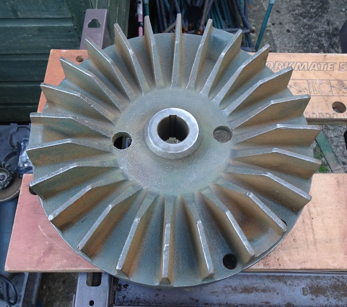

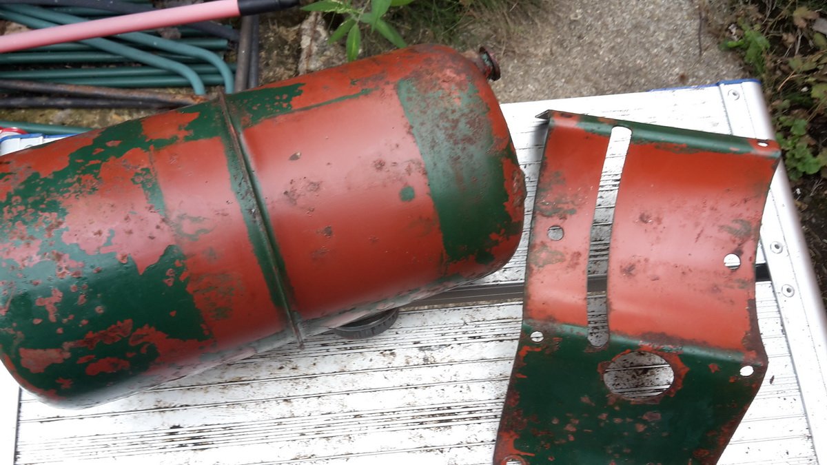

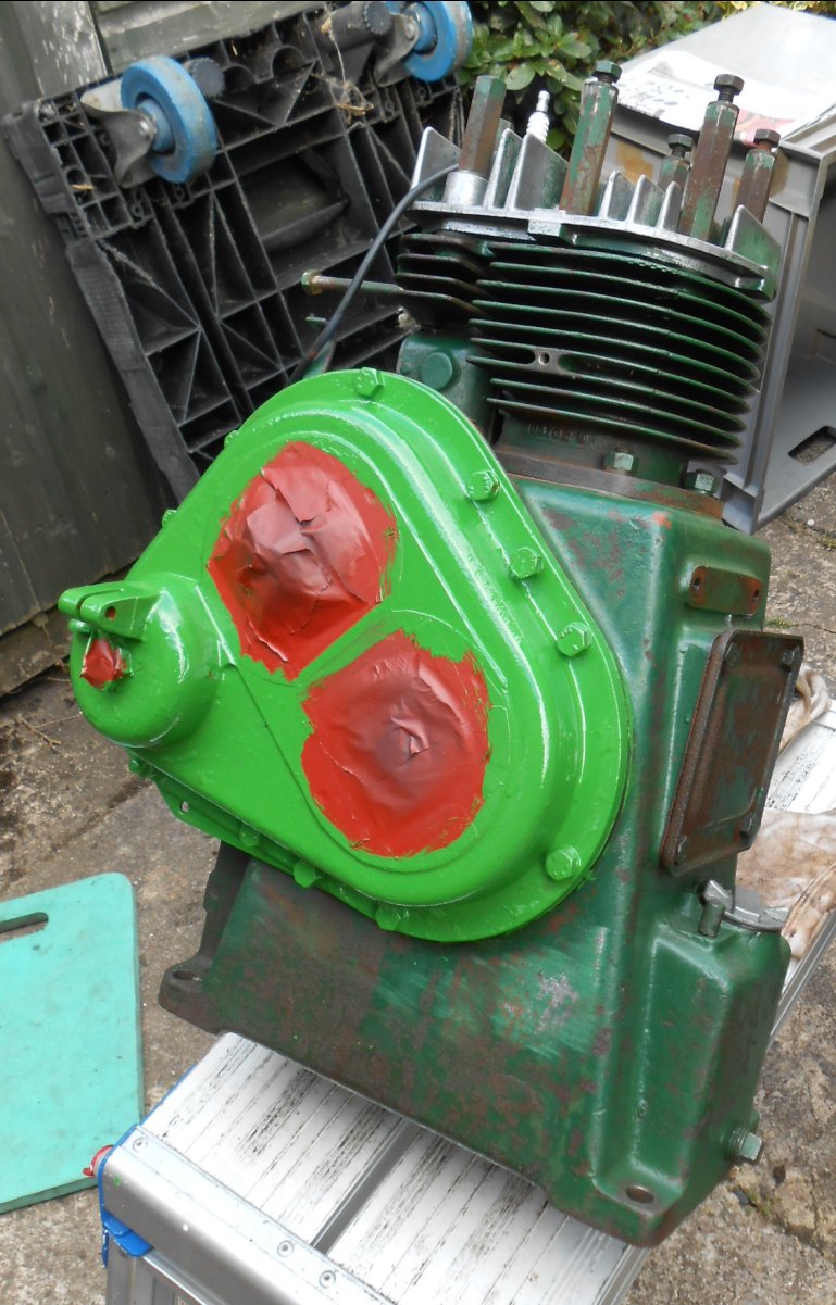

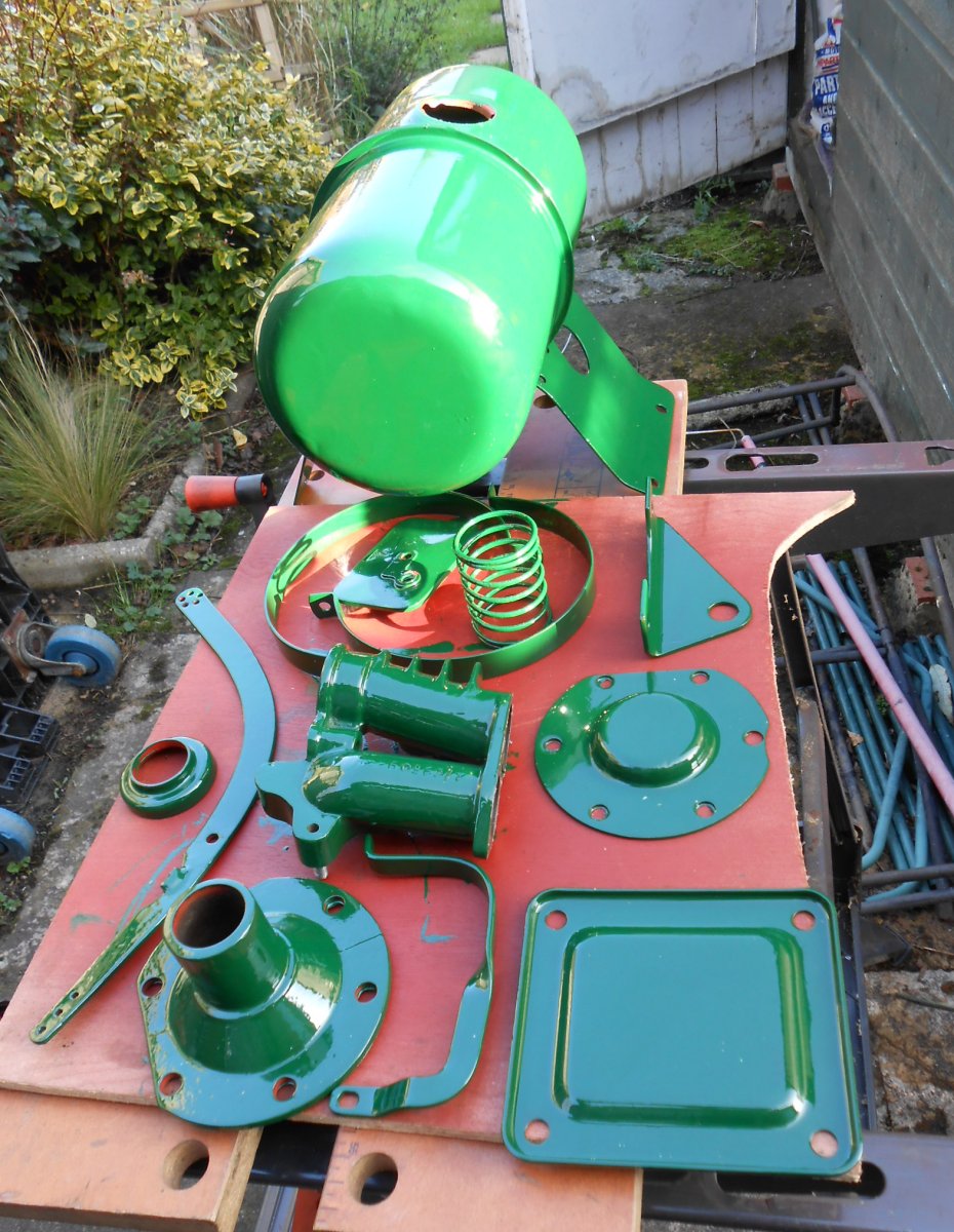

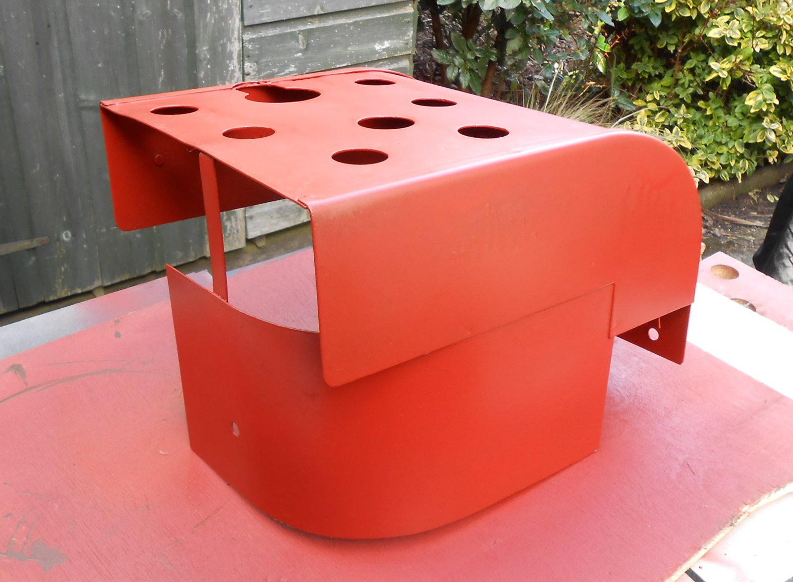

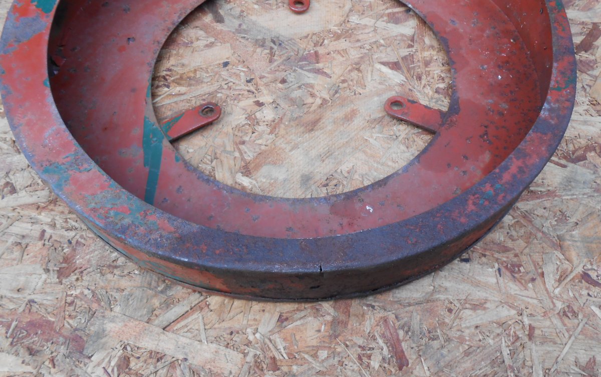

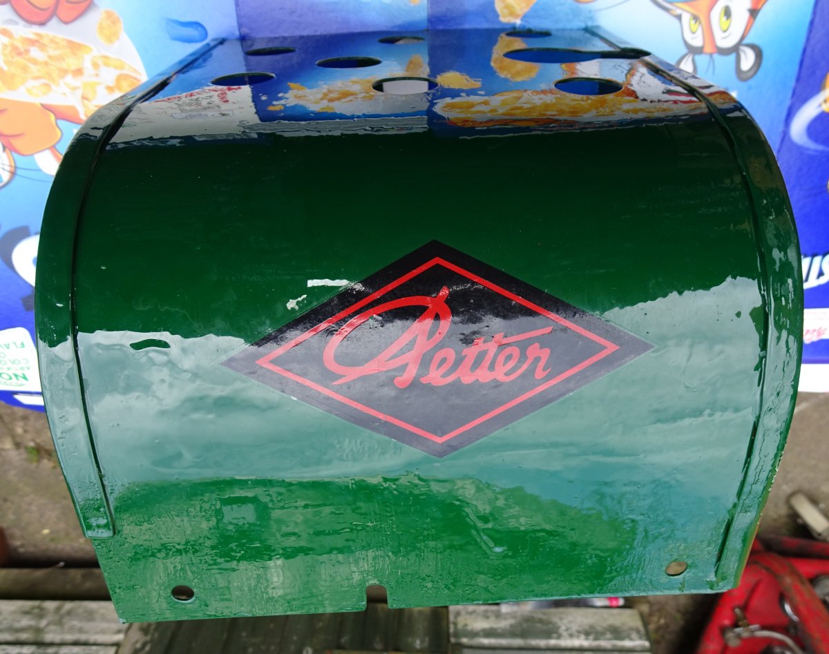

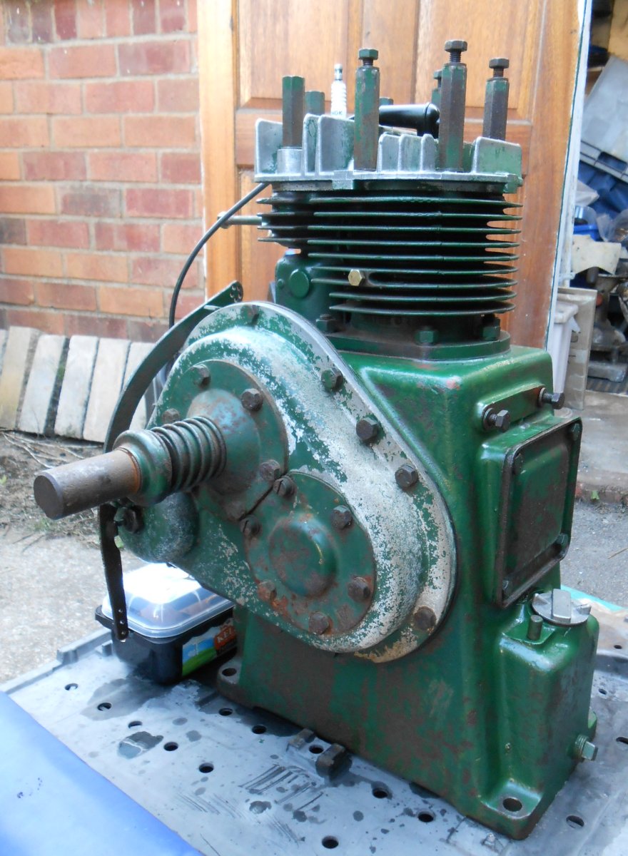

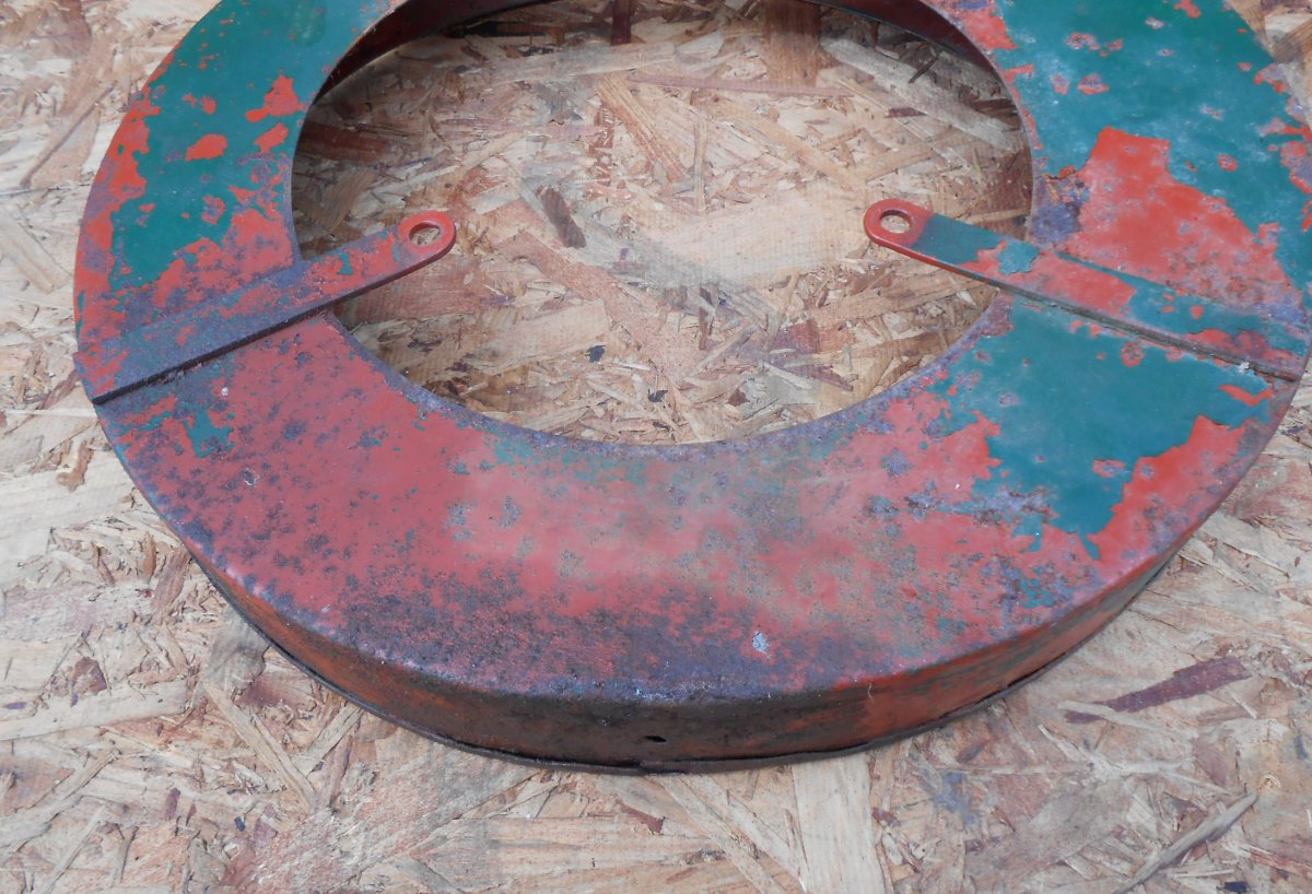

The original red primer was very well applied, but the next coat of Green could be scraped off with a fingernail...
