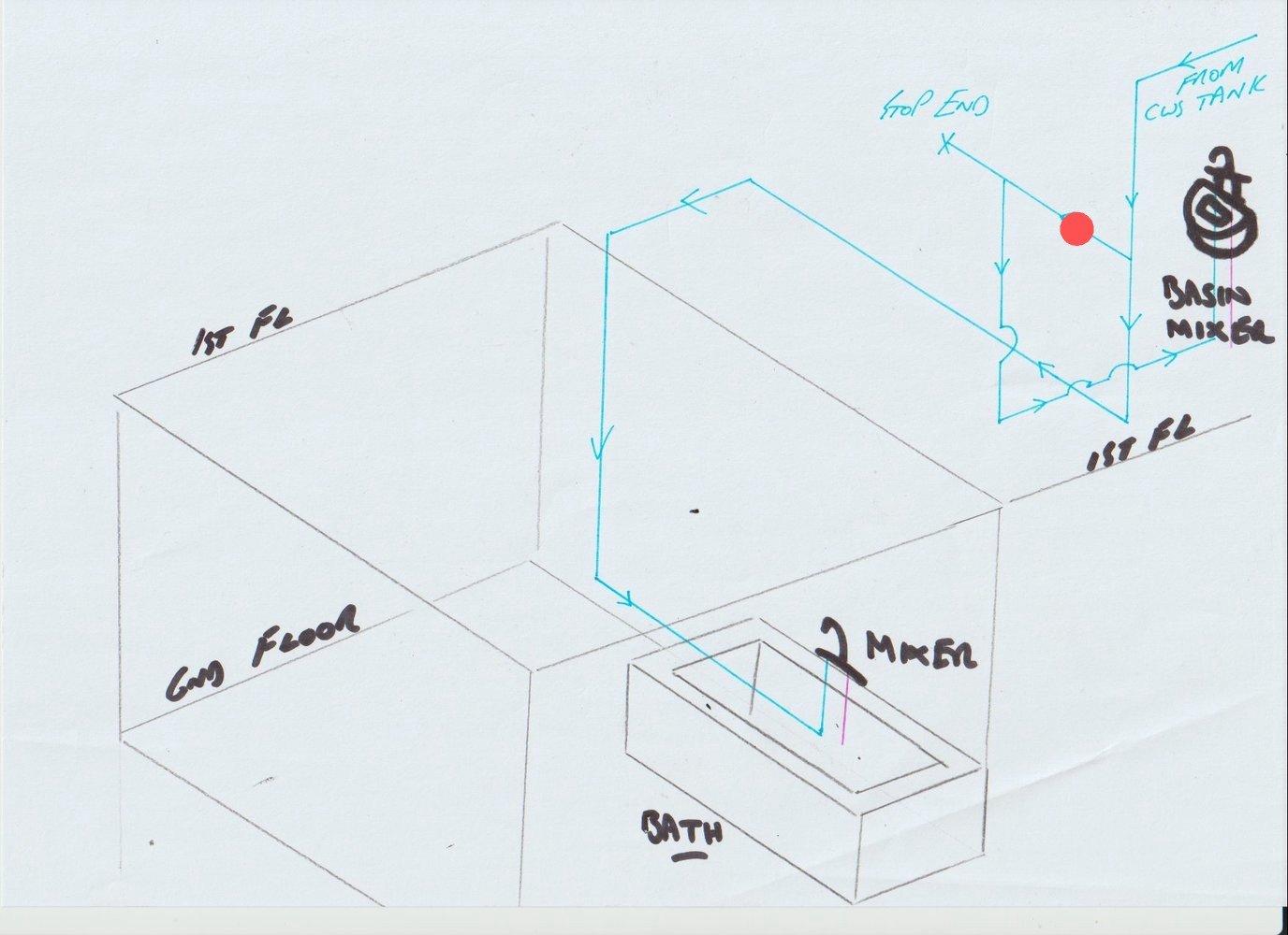

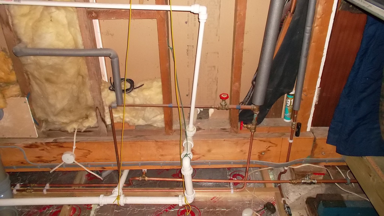

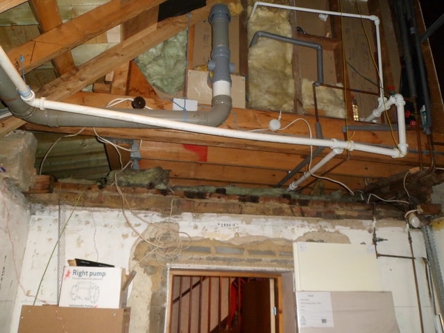

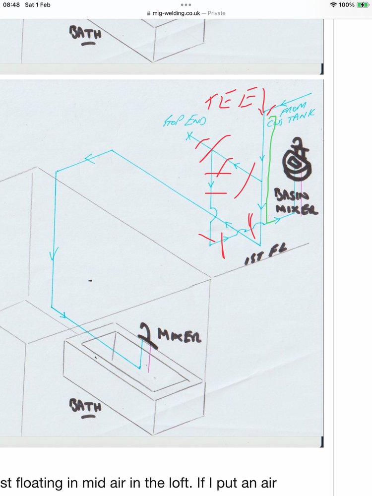

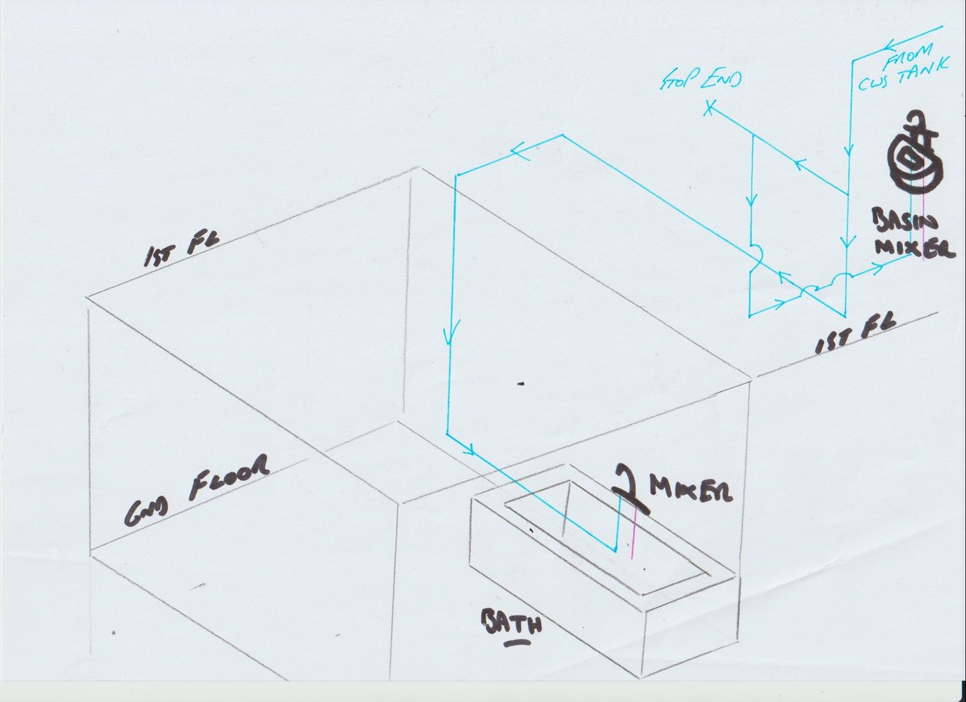

I've a cold water storage tank one end of the house that feeds a downstairs bathroom bath cold and upstairs ensuite basin cold.
It runs across the dormer in 22mm from the cws tank then drops in 15mm to a tee. It runs in 15mm to the basin cold via a ball valve, it runs in 15mm to the bath via a gate valve.
Periodically the upstairs basin cold slows to a trickle then stops altogether.
To get the basin cold going I have to run the bath cold, then the basin, then close the bath feed off after the tee and it clears the air to the basin tap.
Sometimes it's ok for months. I got it going the other night and it stopped again with 24 hours.

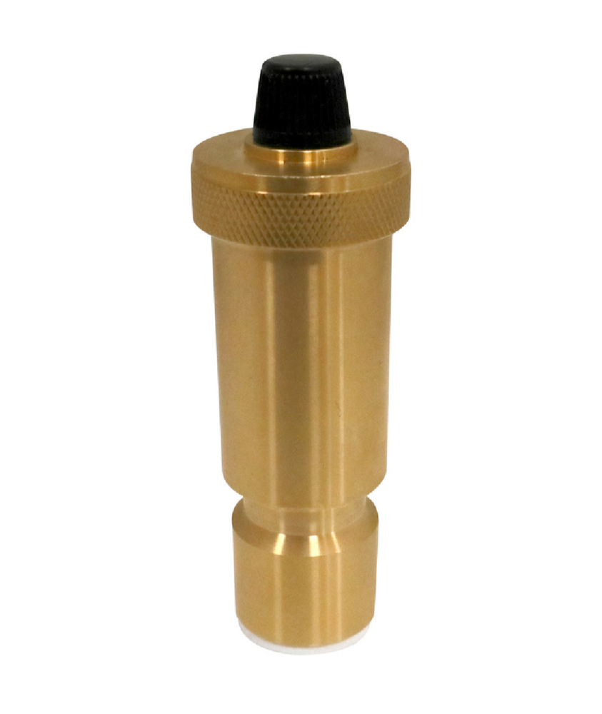

There's a stop end mark X just floating in mid air in the loft. If I put an air release valve like this there, would that alleviate the problem?

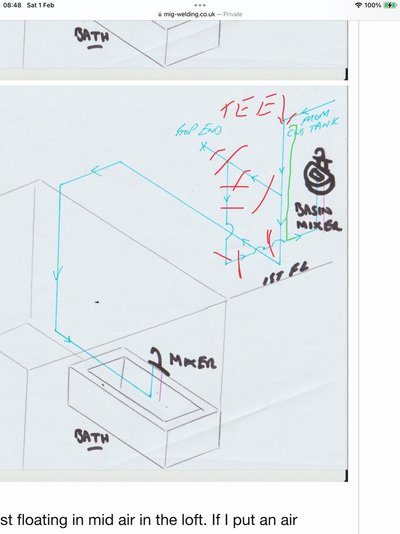

) would putting a tee at the top where marked help, and then an air admittance valve, although if it used to be ok maybe something else is amiss.
