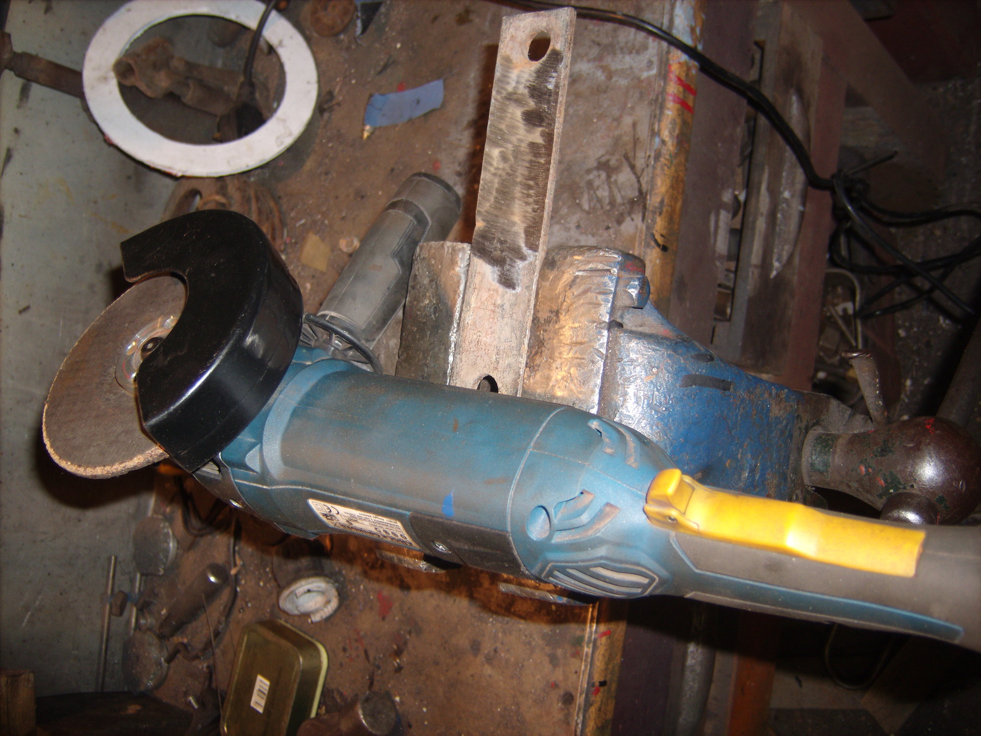

Must say I'm not the best at keeping receipts in fact I usually bin them on the way from the shop. On this occasion I kept the receipts for 2 angle grinders that I bought from Aldi in Nov last year. The grinders have a 3 year warranty.
Using one of the grinders one day, the disk stopped rotating although the motor was still running. I looked out the receipt and went back to Aldi complete with the grinder. Cashier there told me it was over 60 days so they couldn't do anything, but pointed out a tel number and email add on the box who I should contact.

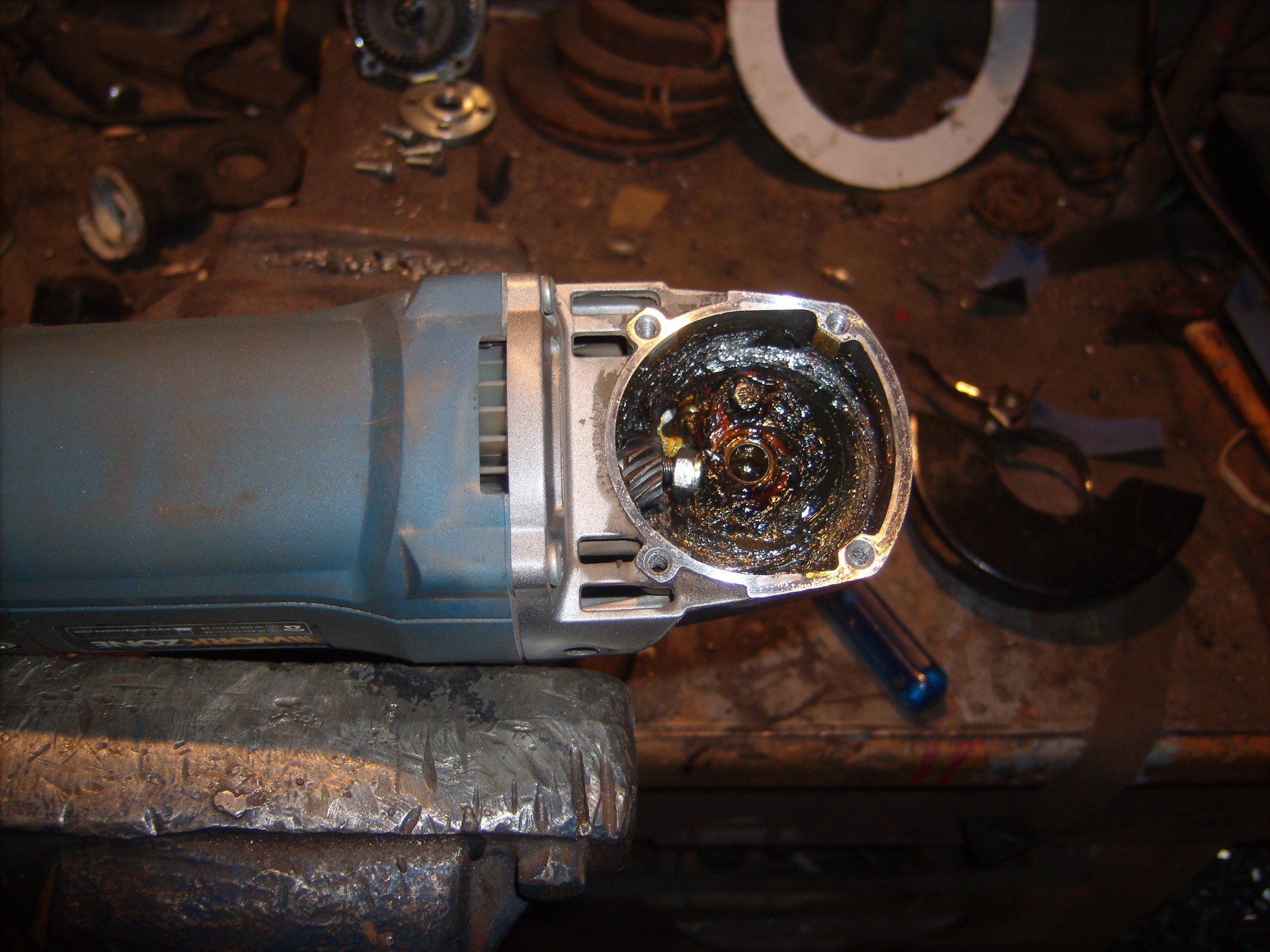

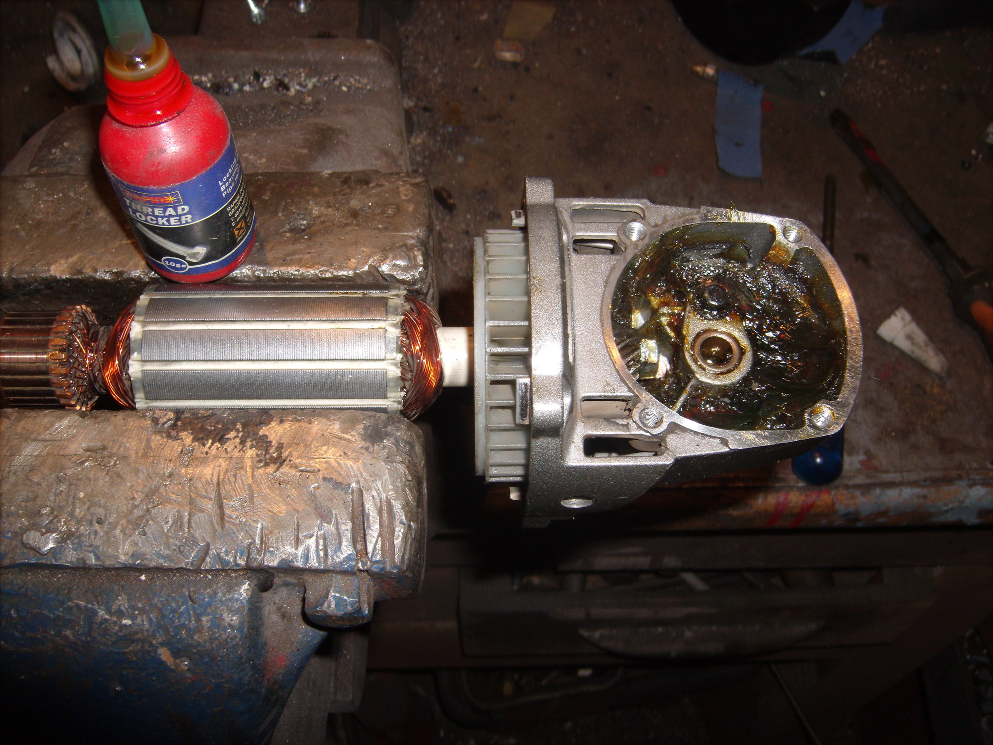

Nut holds the bevelled pinion on the shaft had come off.
Grease cleaned off shaft thread, new nut with some stud lock.
Working as good as new.
