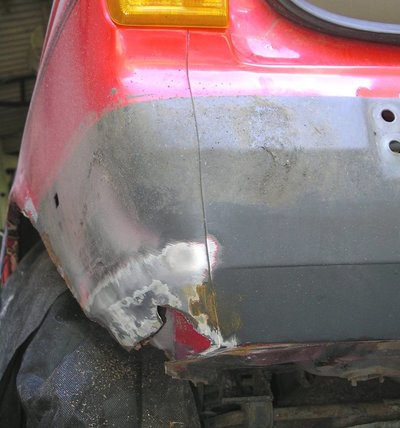

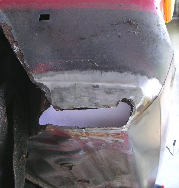

My Fiesta MKII failed it's MOT and needs 5 holes welded, so I thought I'd better learn how to MIG weld and do it myself.

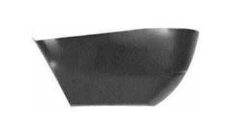

First I'm having a go at the rear lower corner (see pictures). I've cut back to good metal and removed most paint and sealant. Now, I don't know whether I should buy a repair panel or patch it with a piece. If I go for the panel (see pic), it's larger than the area to be repaired, so do I weld it as it is over the whole corner area or do I cut a section out of it? Or do I cut the whole area back to the same dimensions of the new panel and weld it in as it is? Or do I use a piece of scrap metal the same thickness and cut to size. In either case do lap weld or butt weld?
Sorry for all the questions. Thanks in advance
Regards
Dan
