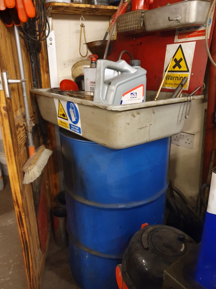

What's the score with these things? I have a big old Clark parts washer with a pump fed brush and when I bought it, I followed the guidance and filled it with detergent. But quite honestly, it's rubbish. I only use it for degreasing and I'm sure I'd have more success using parafin/kerosene or the like.
On the label on the inside of the lid it clearly states not to use flammable liquids (parafin, petrol, thinners etc) but what's the real reason for that? Is it just the fire risk or is it perhaps something to do with the pump perhaps?
So what are you guys using in your parts washers and what issues does it throw up?
