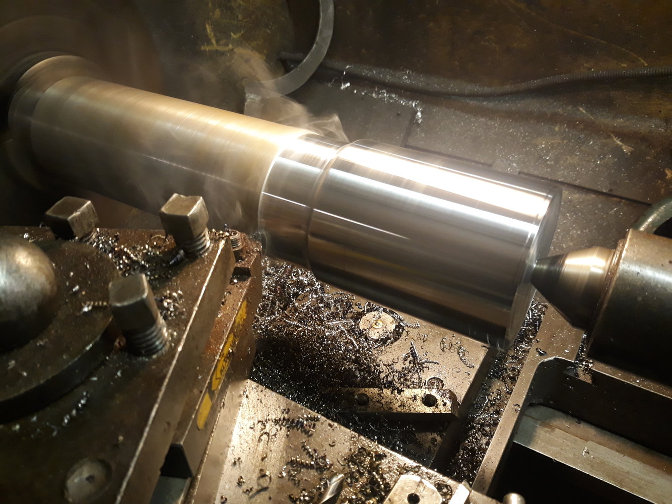

I have done it loads of times - perhaps I have just been lucky!Never use a tailstock when parting off.

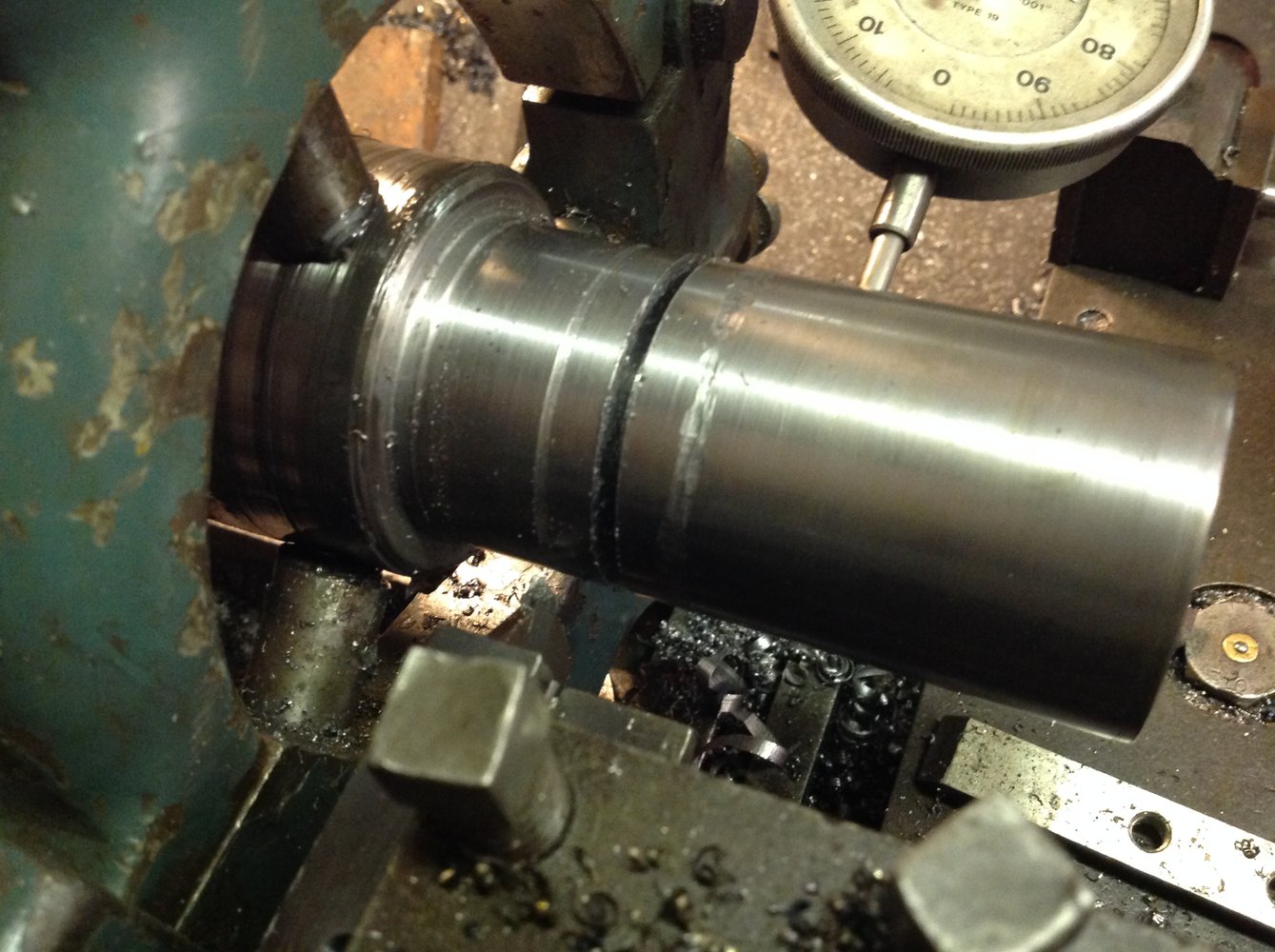

I tried to do it with a long part the other week. Resulted in a broken insert and me saying "i knew it was going to do that"

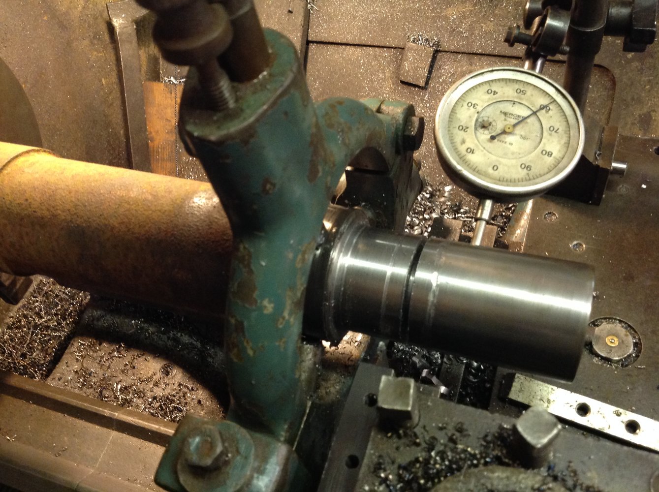

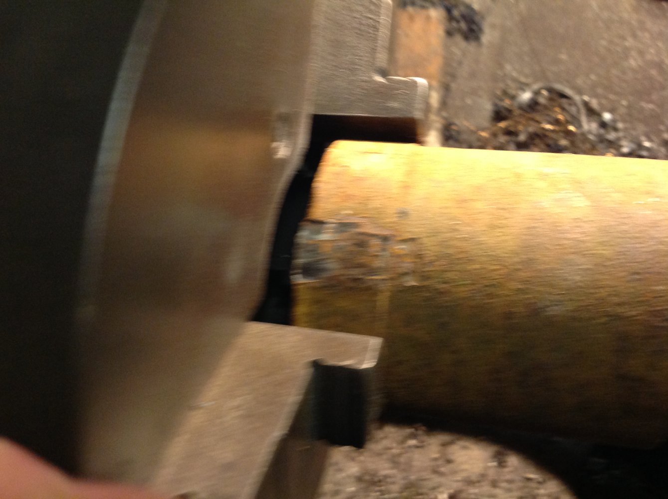

Should have used a 4 jaw for extra grip but L1s aren't exactly light and easy to change!View attachment 437687View attachment 437688View attachment 437689
Rescued it. Looks like the chuck survived, in the pics I had already straightened out the top finger adjuster. I parted the end close to the inch diameter I'd bored using the tailstock and live centre, then removed the tailstock to finish the part. It ended up slightly shorter, by 250 thou or thereabouts, still long enough for the bronze bearing it sits in.
That would reall have f***ed up the chuck. The job of the chuck was to hold it sufficiently to turn it. The job didn't fail at the chuck. Never sounded unhappy either, until it went bang.Mr Hindsight would have trued up the chuck end and then shoved it hard into the chuck face so you get max jaw engagement on something more reliable than heavy rust and an invitation to bell mouth the jaws.
This Mr Hindsight would have parted till it sounded unhappy then sawed it off and faced the part in the chuck.

Funnily enough there is no spring at all on my Holbrook H20. That might be due to the fact it weighs 5000kgIndeed, mostly yes but the spring pass is typically after a light finish cut. When you're hogging off material and especially when parting, there is a lot more deflection. A lot of that will still be in the tool and toolpost but also twist and deflection in all of the parts between the cutting tip and the headstock bearing. That is why you always want to keep those two points as close as physically possible.
I have them touching, but just. I adjust the fingers until I feel them rubbing slightly on the part. Works fine for normal turning.Touching, no gap and reset as temperature increases

So, I did a little test and my underwear is still clean(ish).I will give it a little test this weekend. Might even film it.
Fingers crossed I don't need a change of underwear after.
