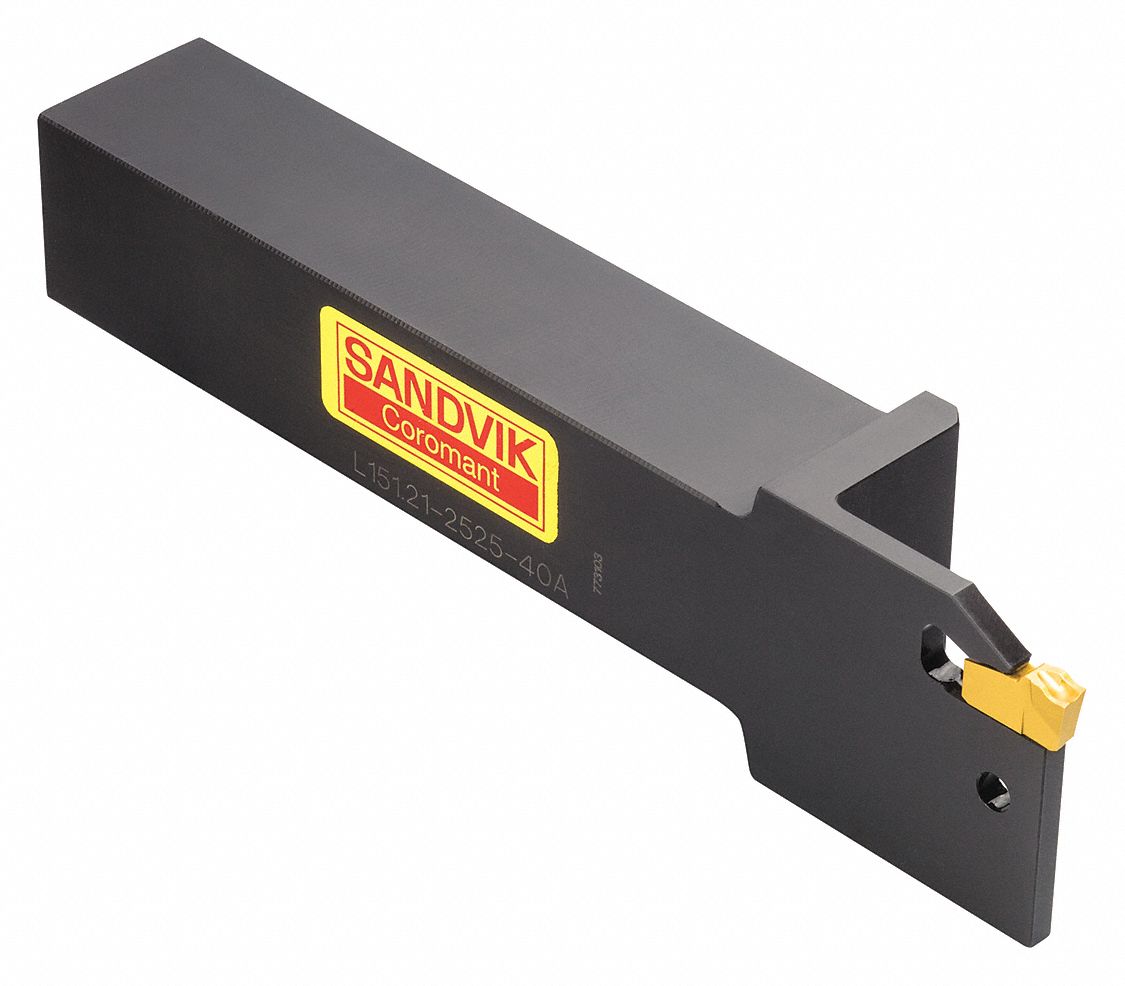

I think you need a very rigid lath to use the power feed on steel when parting, mileage may vary and all that.![]()
Have you got an indicator. Put the mag base on the chuck, indicator in the parting tool and run the cross slide back and forth. You need to be within a thou or two for a parting tool or they start to rub.
rear tool post simple enough to make.
have you got a threaded chuck though or a taper? Like L1 or L0? Camlock?
What kind of holder is it? Hard to tell from the picture but can't see a clamping screw so I am wondering if it is just a push in insert?
Have you tried getting the parting tool harder up into the tool post with less hang out ?

It's a Sandvik one, like this https://static.grainger.com/rp/s/is/image/Grainger/44Y631_AS01
On a Chipmaster, with that tool and insert, you should have no problem at all. I have same the system from Greenwood Tools. It means it is your set-up or your technique that is causing the issue.
The performance degrades rapidly if the insert is worn or chipped. Put in a brand new insert, set exactly on centre and try again.
Can you give us the code off the insert box. Sandvik make a lot of different grades and the inserts come in left, neutral and right, so that may influence things.
It's a push in insert.
" ....", Parting inserts normally should be set on centre and only occasionally will they require fractionally above.

Could you expand on what circumstances one might set the tool above centre, please ?

If your setup has any chance of dropping during cutting with the load such as a blade type parting tool with a large stick out or your X axis being a bit loose.
One blade type tool that I had great difficulty in getting to work was a Kennametal A2 it required that it was set fractionally above centre once I did that it worked well for the rest of the life of the blade.
