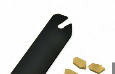

That's real skill....... I've had a chequered history with parting, Banned as an apprentice for endangering the life of the turner on the next lathe. Never really was comfortable with it over the pastI hated parting off until I bought one of the cheap Chinese blades with inserts. Mind you having a Colchester Triumph helps as well. It munches through on power feed no problem at all. I am still on the original tip as well which is amazing although my lathe only gets used once or twice a week.
