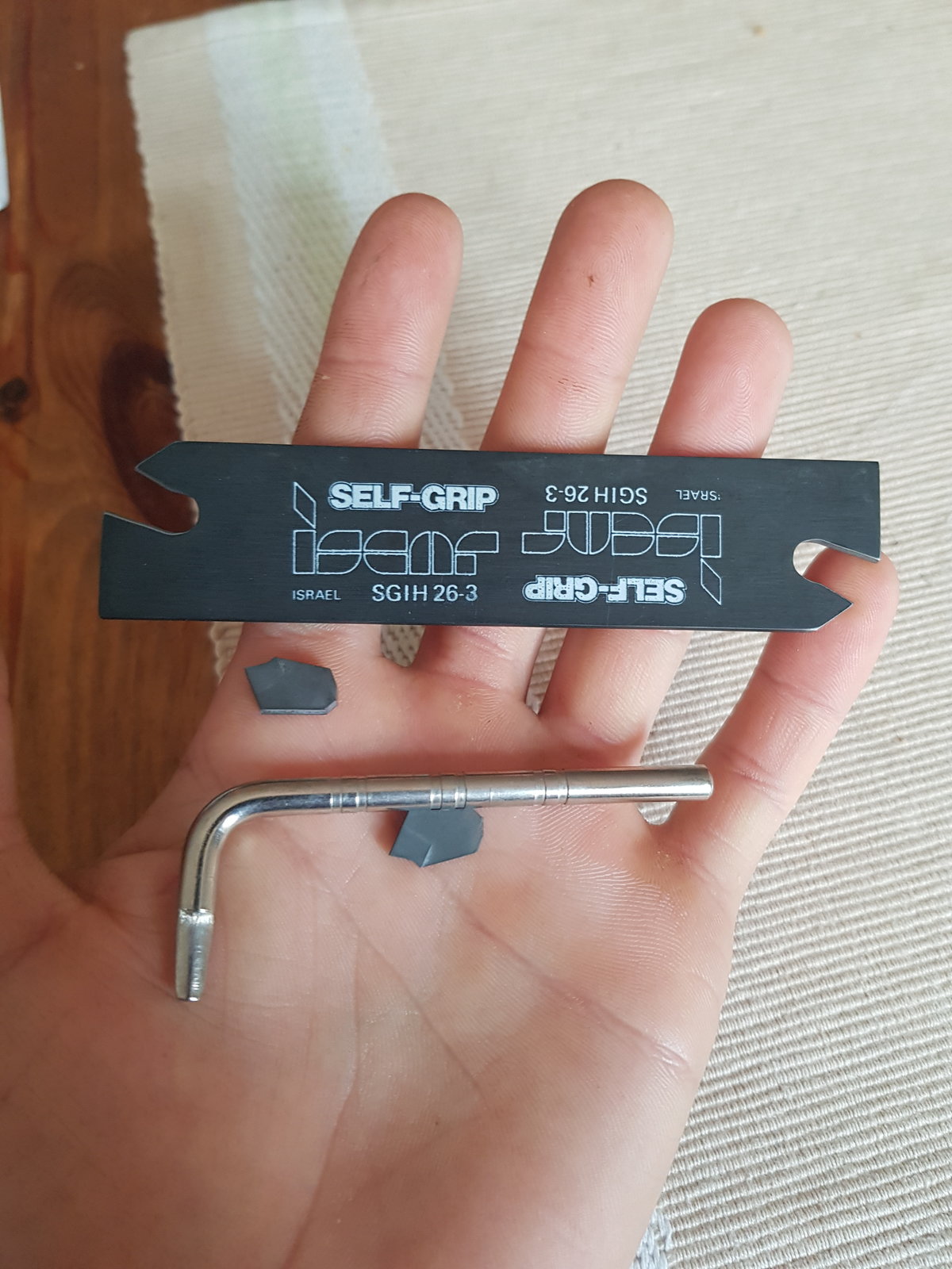

Well while we are on the subject can anyone identify these inserts for me...
Search for the number on the shank. You see that it is a shank for GAD? (last letter varies) endpieces, which are part of Iscar's Cut Grip system. 'iscar cut grip insert' will then find the inserts.
