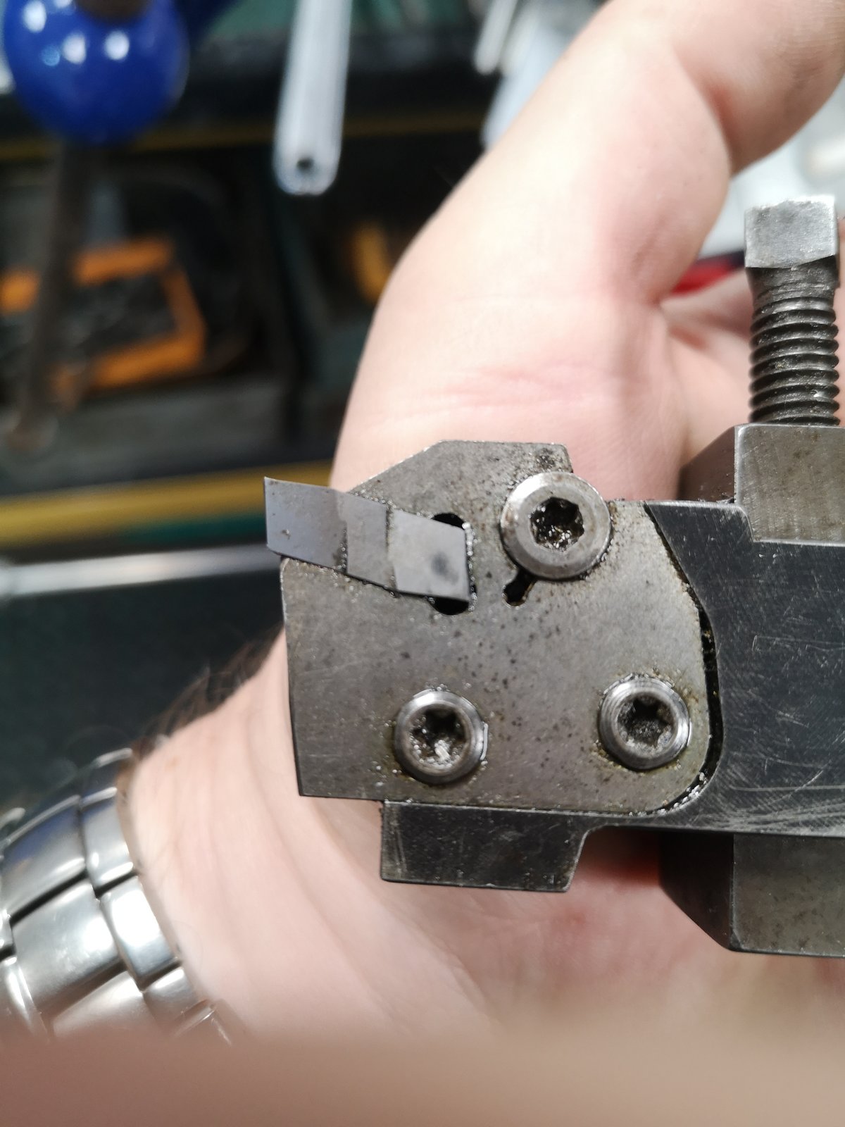

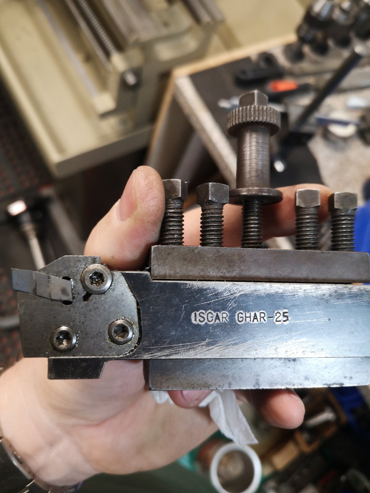

I'm a big fan of the Chinese tools and inserts but theres absolutely no comparison with parting inserts, the Chinese ones are ok but this iscar one is a beast!
Get some good Inserts and take your brave pills, parting can become a dream.
1" stainless, grade unknown.
1600rpm @ 0.12mm feed per revolution
