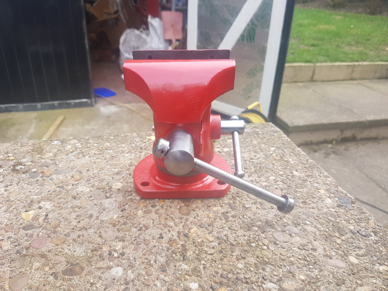

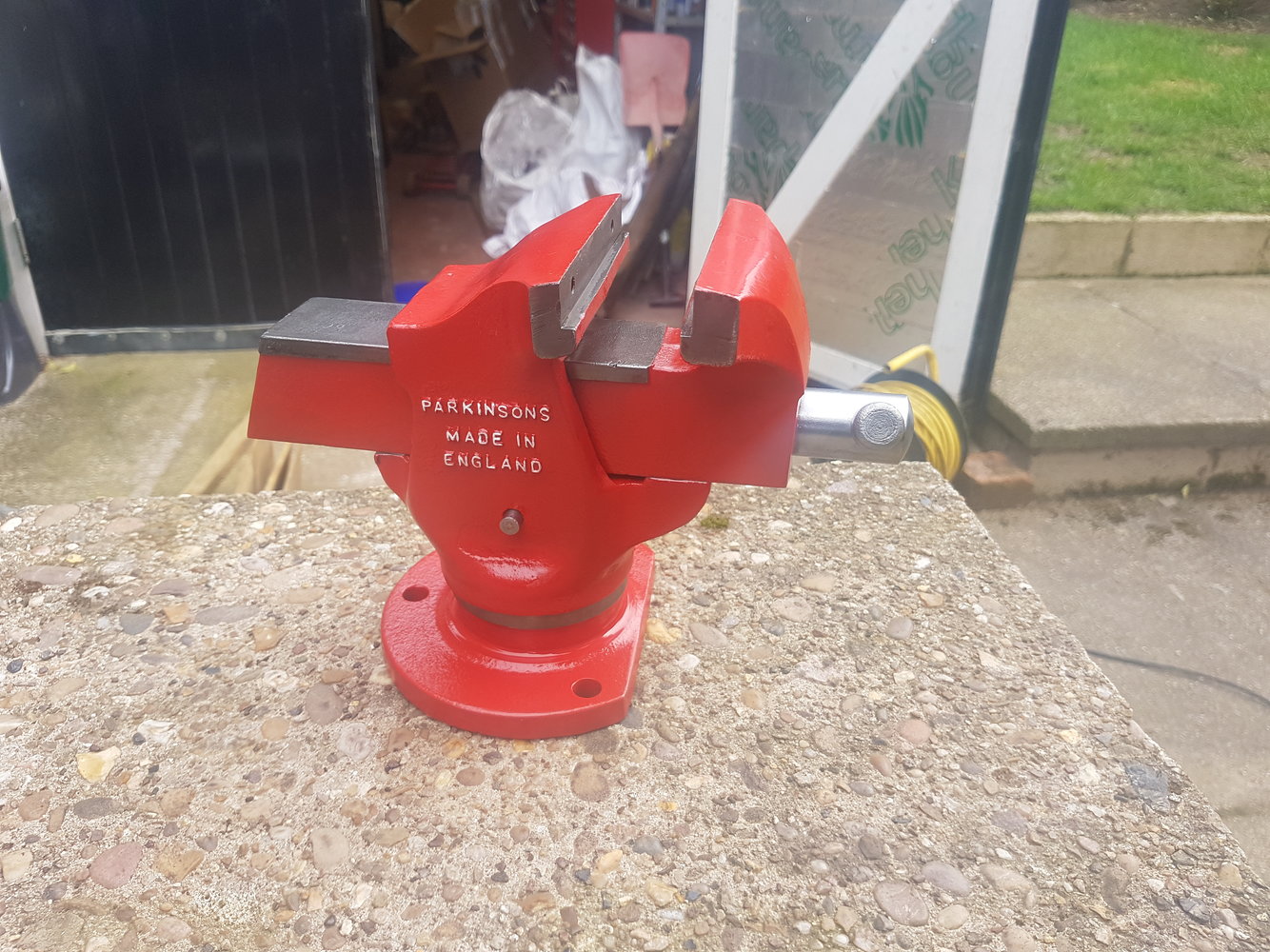

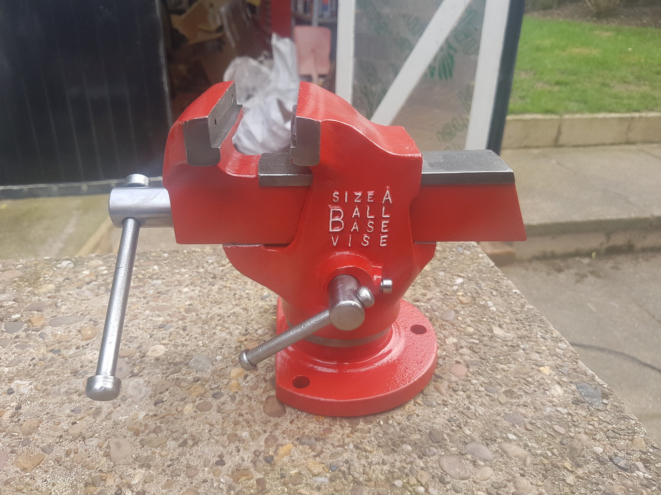

That would be fantastic, thanks!If you are coming through Belper in the near future I'll put some 8mm / 5/16" bar in the mill and knock you a couple up.
Now your spoiling me!Do you want the mounting holes drilling as well? If so let me know the dimensions.
3/16 24tpi, which makes them bsw! (I think)
The mounting holes are central top to bottom, and seem to be 64.5mm between centers.Do you want the mounting holes drilling as well? If so let me know the dimensions.
So 15mm tall, 8mm deep, 4" wide.
Mounting holes 3/16" diameter, 64.5mm between centres. What screws are you going to use? C/sunk, machine, socket head?
Really! Somewhere that actually stocks imperial fasteners!No problem, I have a pair to make for my Record and it's no bother to make another set at the same time.
Twiggs have 3/16 ww screws in stock btw.
