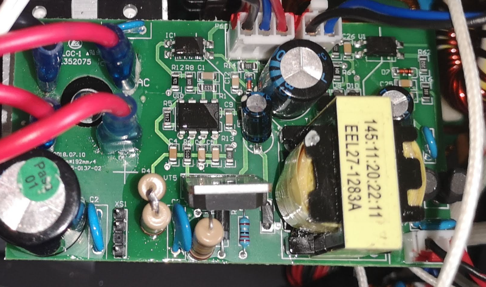

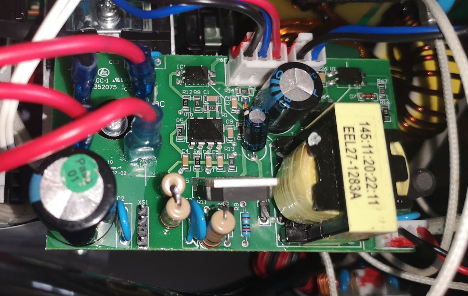

Overview #1- can see most SM components in focus(ish):
Overview #2 - opens up some more components:

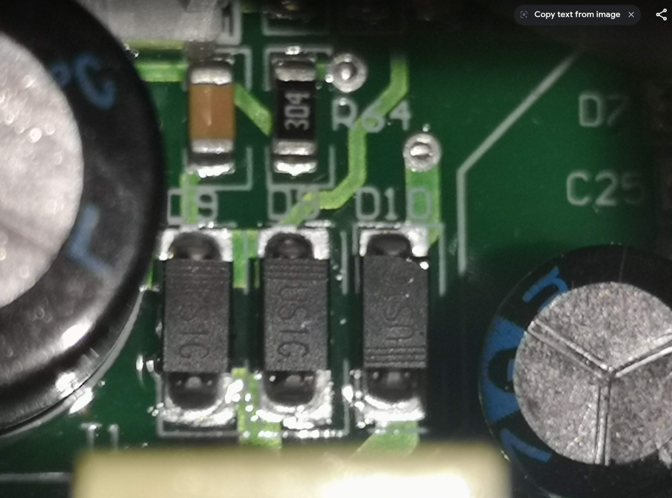

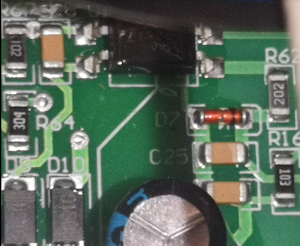

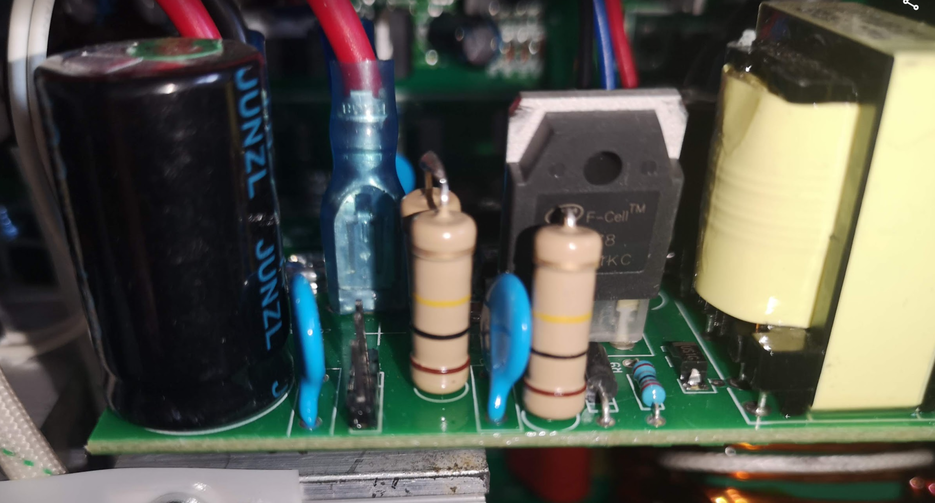

Close ups of the previously-hidden components:
A - Top right
B-just above the transformer
and C - showing some radial and axial components
In the above picture, SM diode (D3) is a US1G. It is glared out in the overview pictures, but I do have another shot similar to the above where it was focused.
The cathode band is towards the far end of the picture (i.e. the anode is nearest to the camera).
