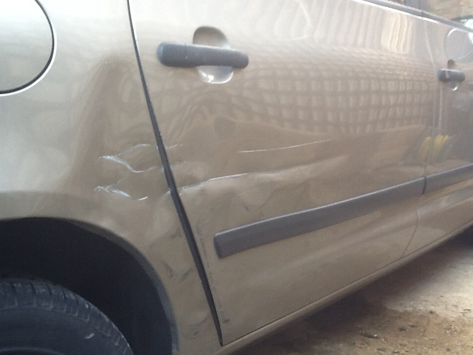

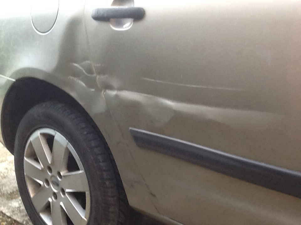

firstly don't do a thing until you have fitted the door so that you can see exactly what's moved and where it should be, as for the wheel arch you could possibly push it out back into line or as close as using a bottle jack and piece of wood, you may also be able to get some of the big dent out using a longer length of 2x2 through the inner panel, I wouldn't cut any holes into it
