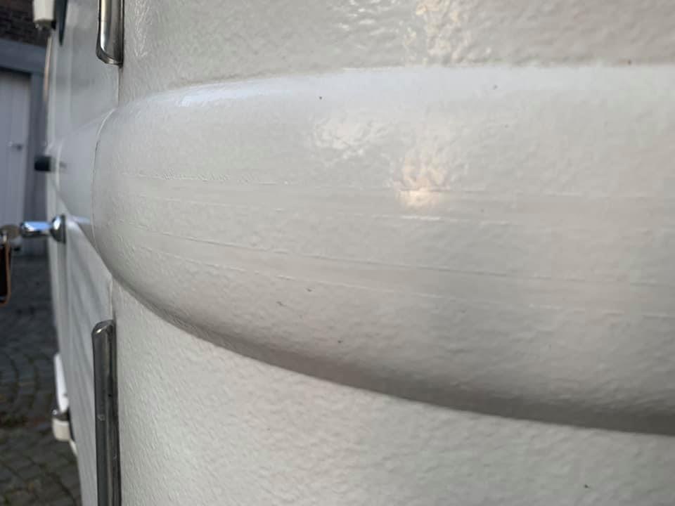

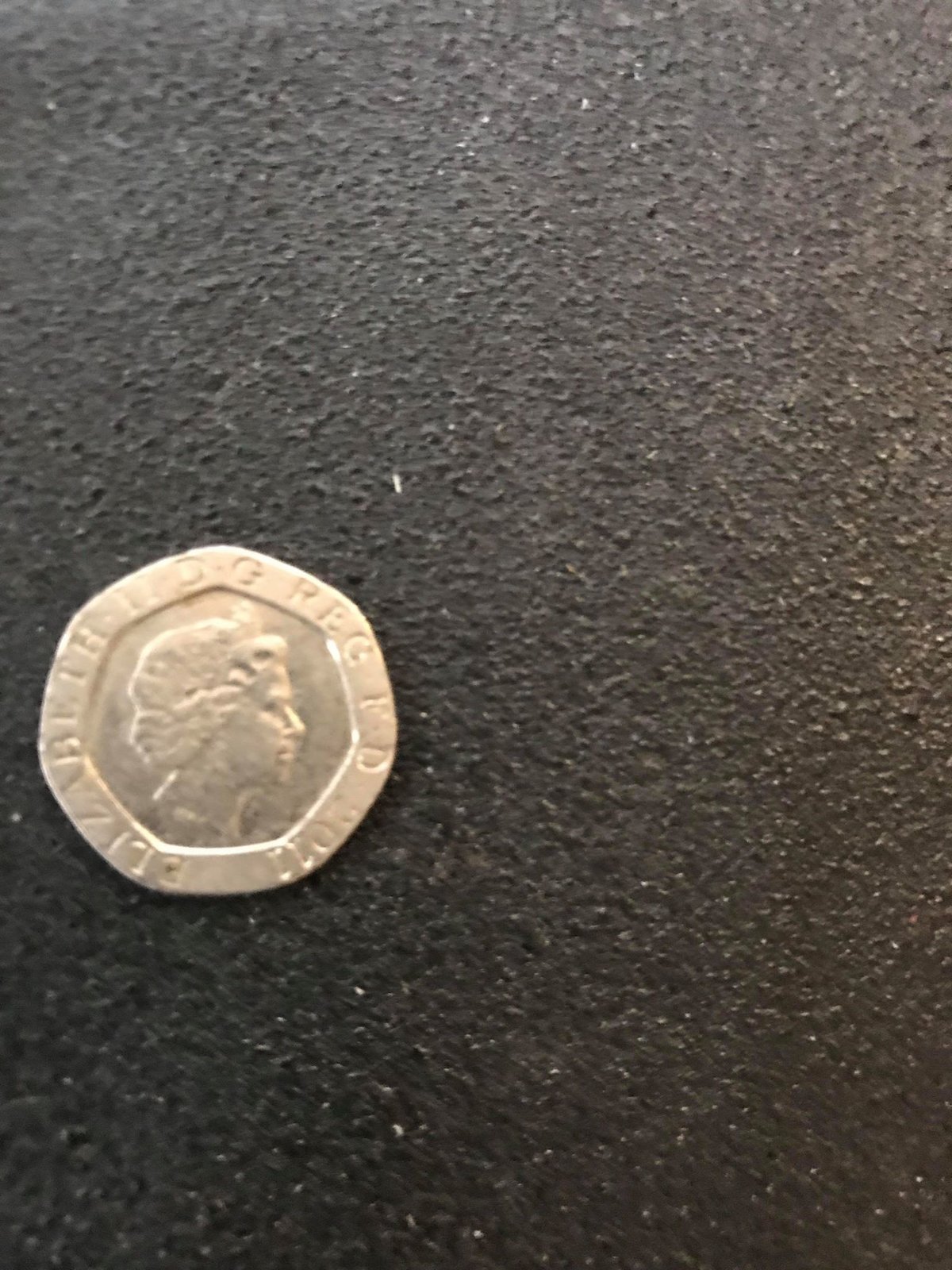

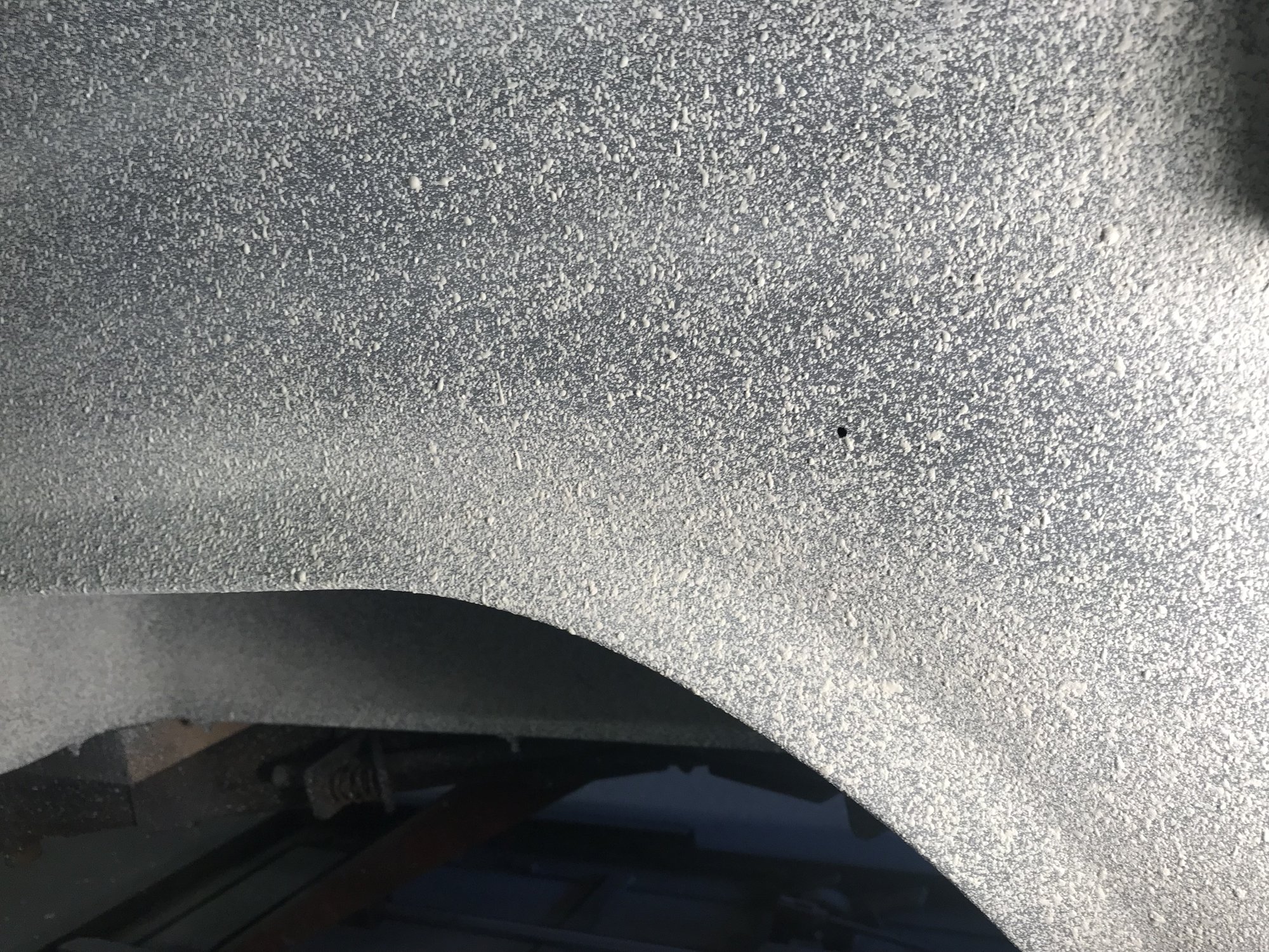

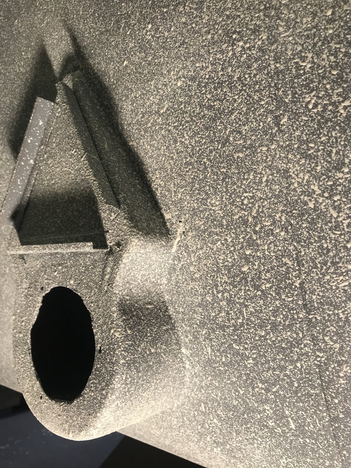

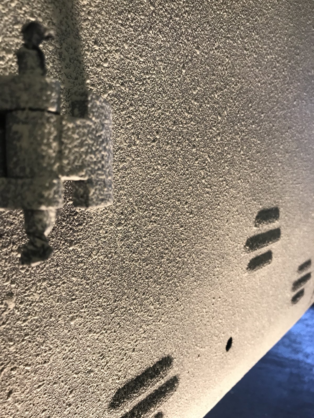

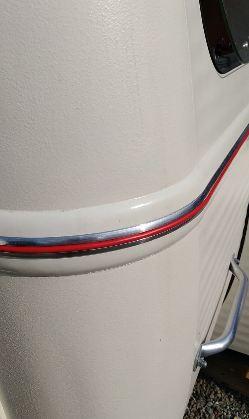

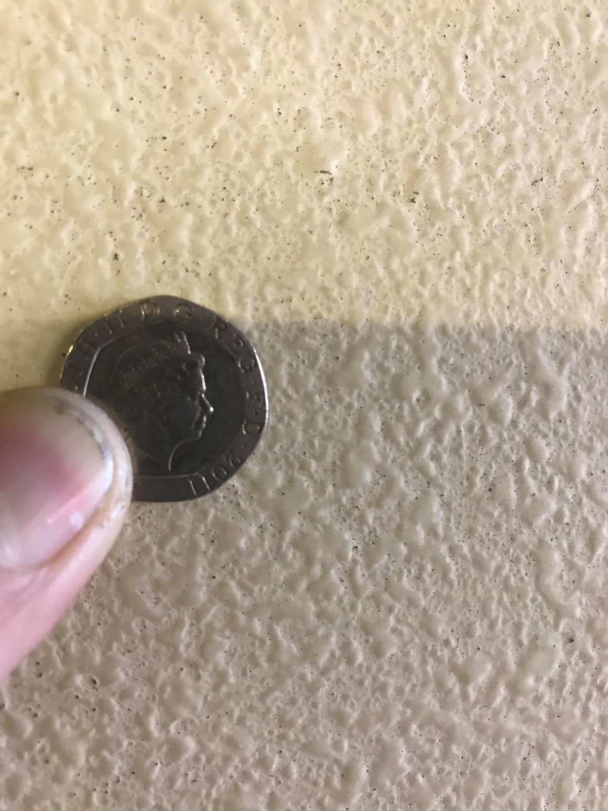

Hi, I'm restoring a 1960 steel bodied caravan which has a coarse stone chip/textured effect all over. I've flattened the texture and bare metalled it in places and primed it in cellulose all over.
Which brand of paint do you recommend to get the desired finish (attached pics). I've heard different opinions - Tetrosyl is most like the effect with large bumps, but supposedly doesn't dry rock hard so is there a theory that it attracts moisture to later rust? Gravitex is harder but it's not the right look!
Any help gratefully appreciated.
