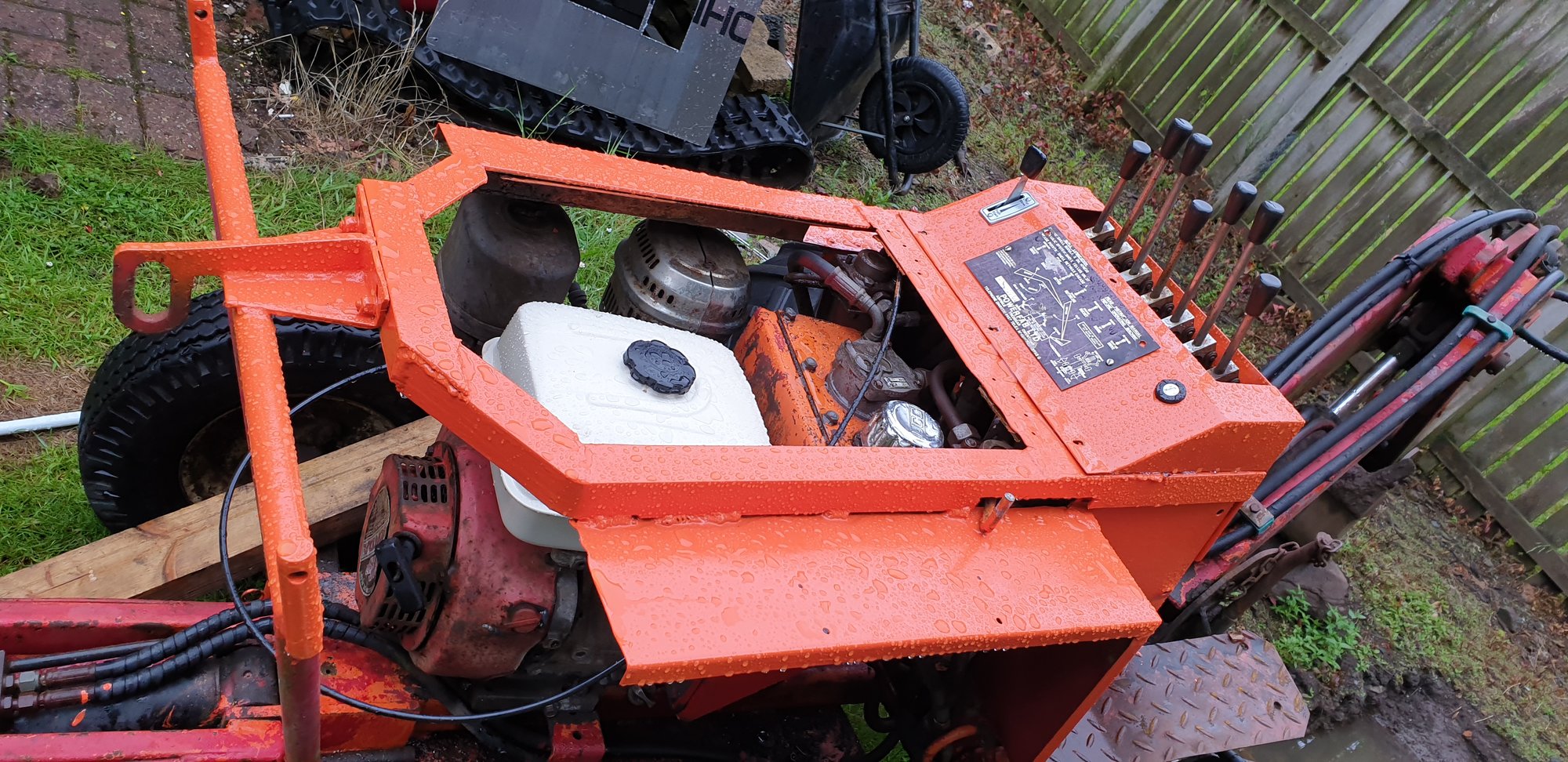

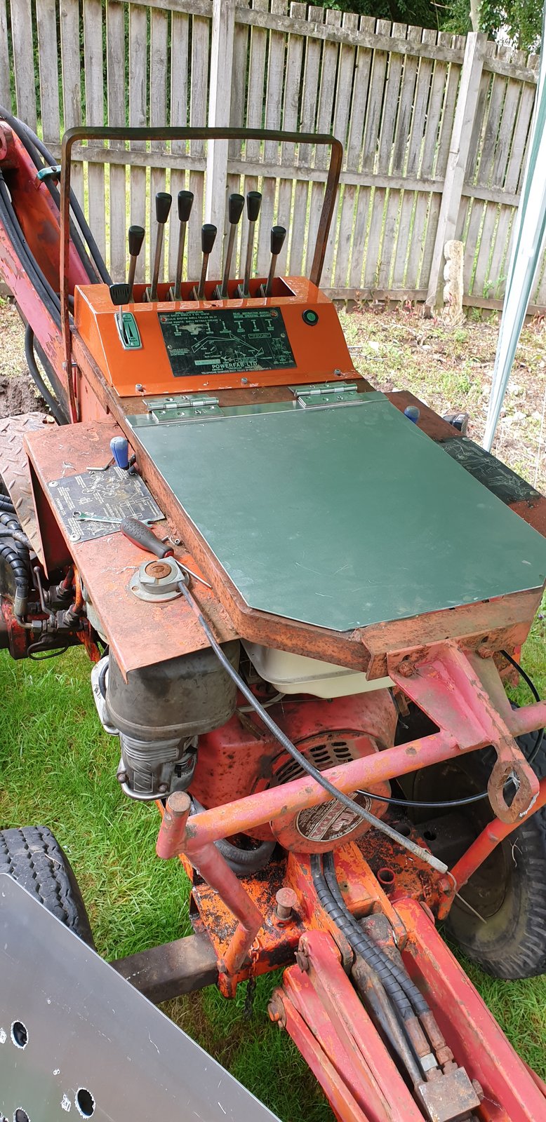

The rams were pretty bad, I've sanded the back with 1500 and 2000 wet n dry, used citric acid to de rust them and the J B Welded the pits and scratches. Filed then wet n dry papered them smooth. It's what the farm equipment used to have done, they went on for 10-15 years like that.
Oh yes to that list of purchases add a new exhaust and carb rebuild, I'm off to hide the receipts from my wife
