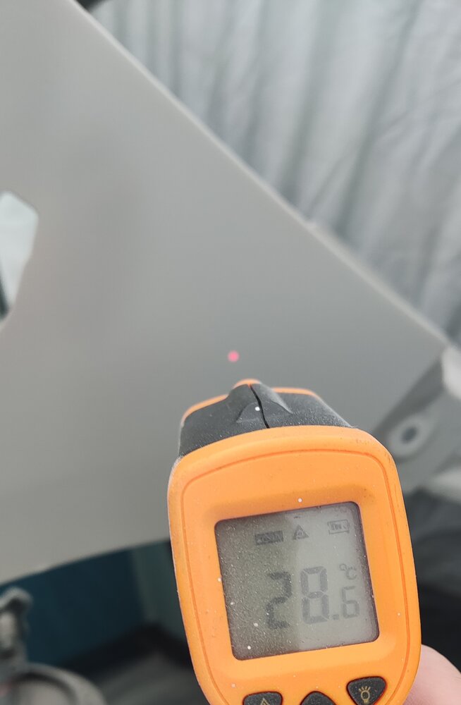

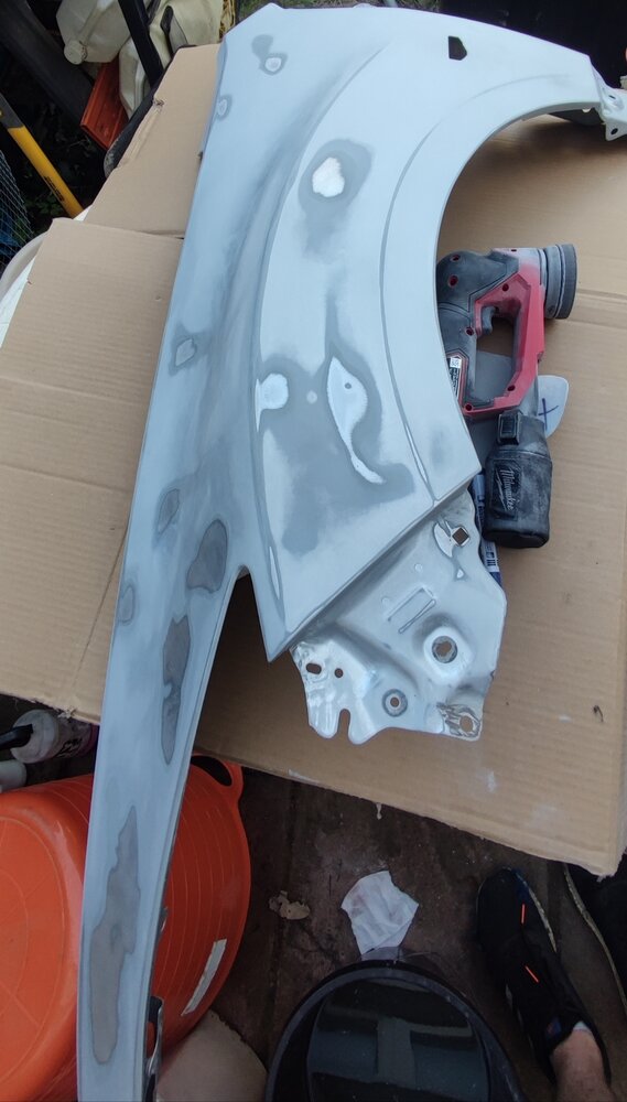

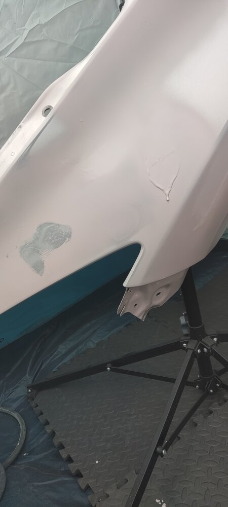

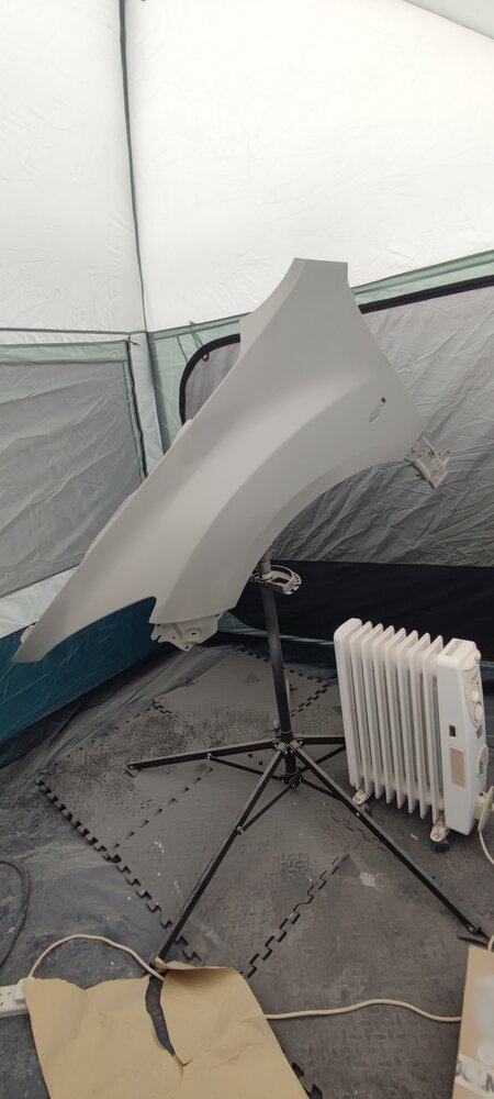

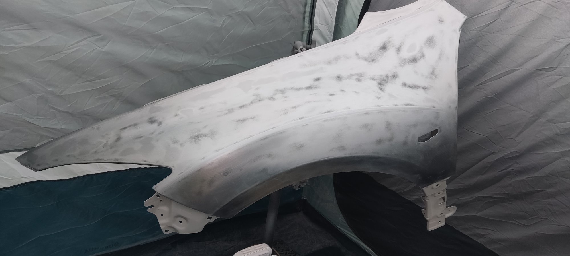

Most of the chips out, the rust spot on each was about twice the size than the chip in the paint.
Now to mannually key all the edges for primer.
To get a even thickness I was thinking to spot prime all of the metal areas before a full coat or two. Is that wise?2k filler primer (or epoxy) 2-3 coats
I almost want to put a 120 disc on and take all the visible areas back to metal.
