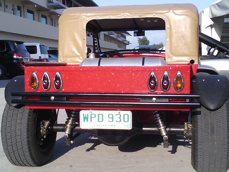

I know next to nothing about paint, so I made it up as I went along.But I‘d seen lots of TV car shows, so I knew what not to do.
This was done in acrylic, because that was what the paint shop sold. I had a £30 HVLP spray gun, and experimented until it looked okay.
Then the final touch, kiddies glitter mixed into the clear coat, as ‘real’ metalflake was not available in the Philippines.
It did the business, glittered nicely in the brilliant sunshine.

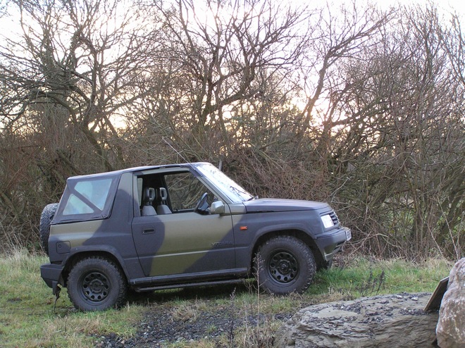

You might at least have given them both the same colour paint .Kids wanted to paint my old Vitara
Aged 6 and 8, cost paint plus a bag of sweets, did a great job

They had both colours one did the low down stuff the oldest did the higher up bit.You might at least have given them both the same colour paint .
