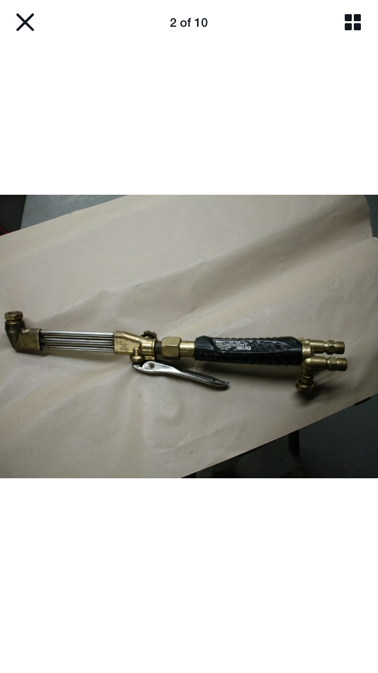

Or could I buy this torch then take the cutting head off and put this rosebud tip on it ?

This is what i use
https://www.thewelderswarehouse.com/cgi-bin/sh000001.cgi?WD=oxy torch propane&PN=LD-oxygen-propane-torch.html#SID=424
in use at 11.30
