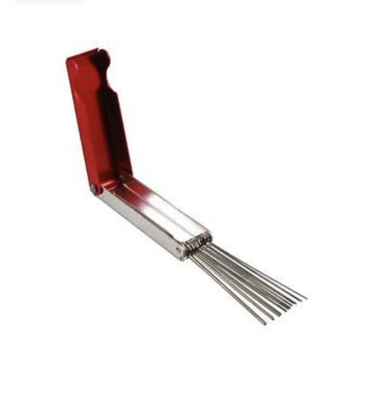

Go on, what are they ? For cleaning the nozzle ?
Forgot he was using propane, my badThose nozzle cleaners are only for acetylene cutting and welding torches (not carburettor jet cleaners as one ebay seller claimed). Propane tips you swap out when they are spent.

what dick would use them for cleaning jets out on carbs there a bloody fileThose nozzle cleaners are only for acetylene cutting and welding torches (not carburettor jet cleaners as one ebay seller claimed). Propane tips you swap out when they are spent.
