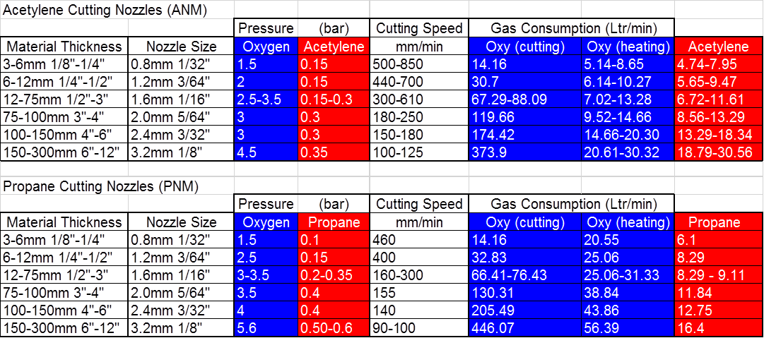

Is there a table where you can see what kind of pressures to use depending on what you doing?
or a rule of thumb? like there is for amps when welding different thickness metal?
something like, Oxy at x pressure, Propane at x pressure - for quick focused heating..
something like that?
