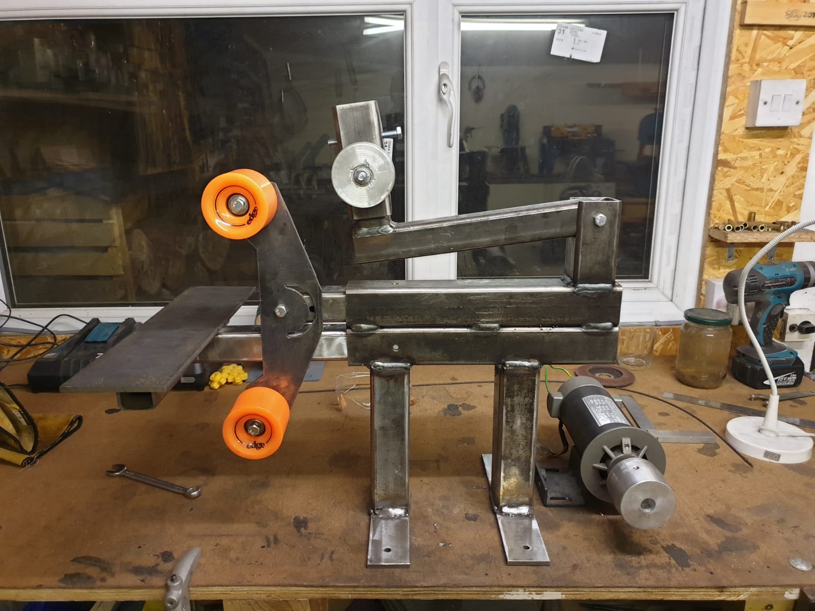

This is a bench grinder under construction at mo.
Try youtube,you should know howwould considering making one if there is enough information on how to go about it around the web.
Try youtube,you should know how![]()

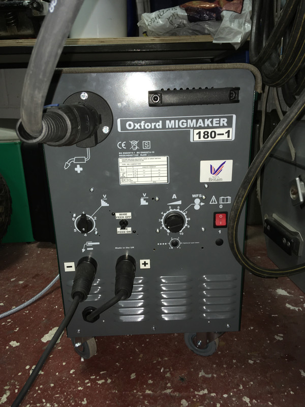

Hi baldy I have just got my 270 oxford just wondering are you using gaslessI ordered an Oxford Migmaker 180-1 from Technical Arc via Welding Supplies direct , Ive dealt with Tom and Jack to order the machine, which was quoted at around 2-3 weeks. Oooh the waiting,Its like looking forward to Christmas! .Tom is on the forum
Next day the BINZEL Mig Torch arrived along with the wire and a few more bits a, i opted for the genuine Binzel torch and wasnt disappointed, a quality feel to the item,a 4 metre MB15 pro evo which suited me fine.
I also ordered the machine with a 5 metre power lead , a 4 metre earth lead, and 3 weeks down the line decided to upgrade the build to inc the polarity conversion kit for gasless wire.I didnt order the spot timer as ive no need for it.
I also added a piece of old trim i had lurking on the front to stop the load door chipping off the paint.
Also i ordered a switch to disable the wire feed for when purging the gas out which always did my heeed in on other machines. I do like the way in which you can specify what you want!

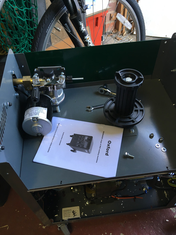

The machine is a top loader with the reel laid on its side.

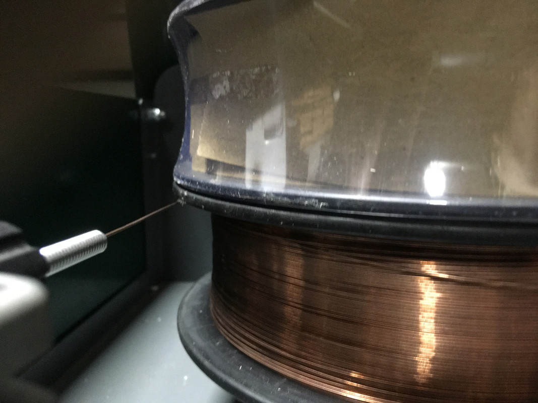

The Eagle eyed amongst you will notice 2 rolls of wire, one is 0.6 and one is 0.8. I modified the reel retaining nut with the bench grinder so that when two rolls are fitted the lid will close and ive both sizes at my disposal without searching for stuff,also in the brown box are the mig tips and spare shrouds.

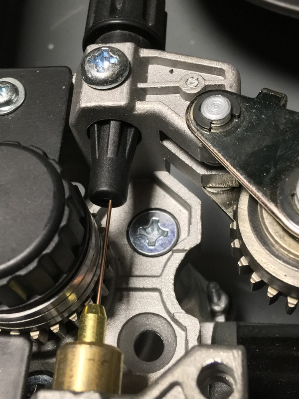

It also has a quality wire feed with geared rollers and dual size 0.6 and 0.8 mm
Heres a shot of the modded arrangement for the dual wires
You can see that the feed wont be a problem from either reel.With the feed originating from the centre of both reels.

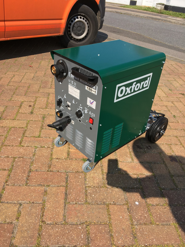

Heres a nice picture of the machine in the sunshine.Sorry about the van photobombing the picture.
It also has the capability to add a mig bottle on the rear with the usual chain type arrangement.
The instruction book if im honest..... is pants.Its a basic pamphlet with just generic stuff and tbh Oxford you could do better.2/10 sorry.Pull your socks up!!!
Also i note the rear axle looks like a bare steel tube. i think ill take that off,and paint or laquer it.Im not sure why it wasnt galvanised for an extra 50p
