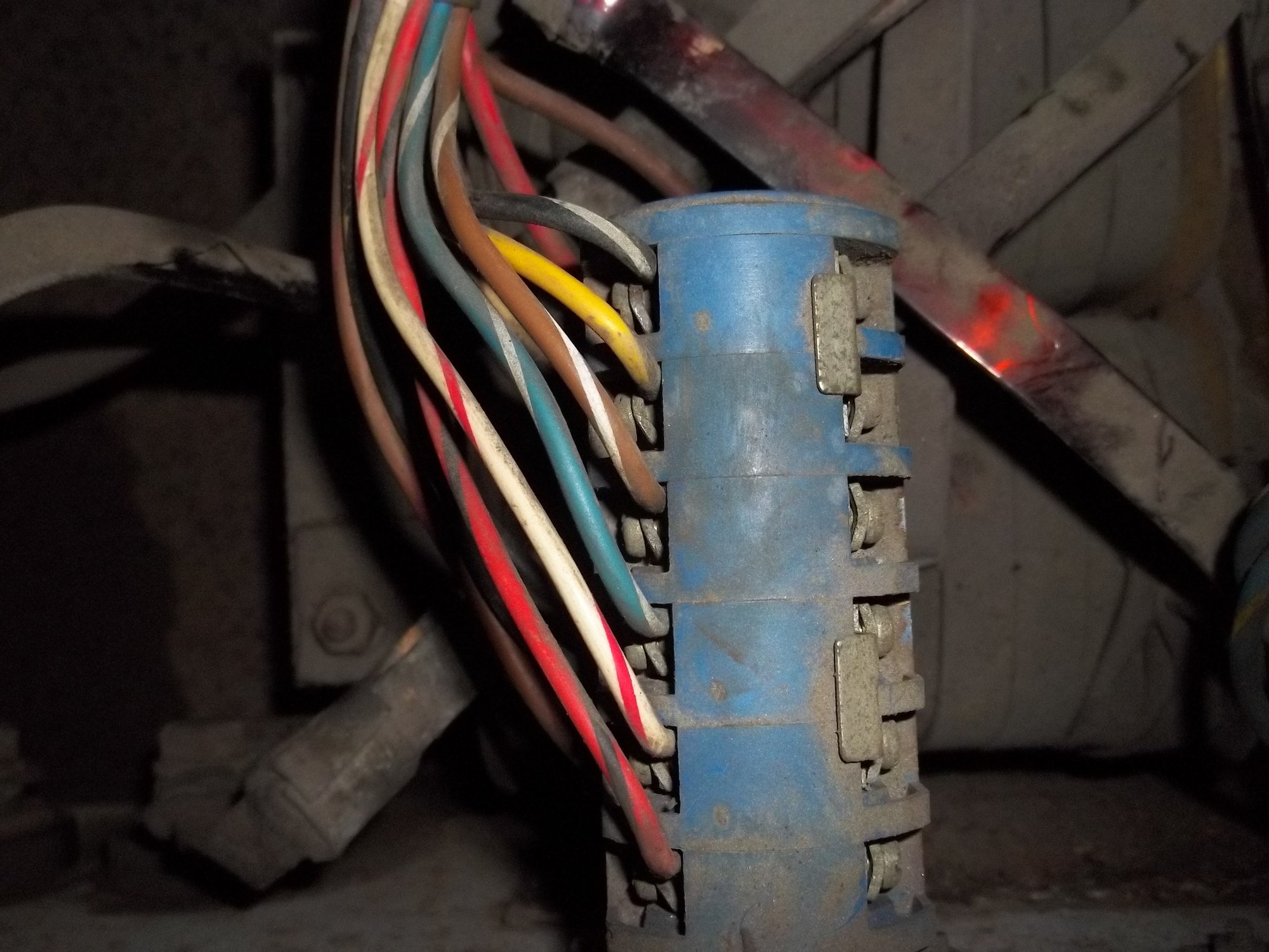

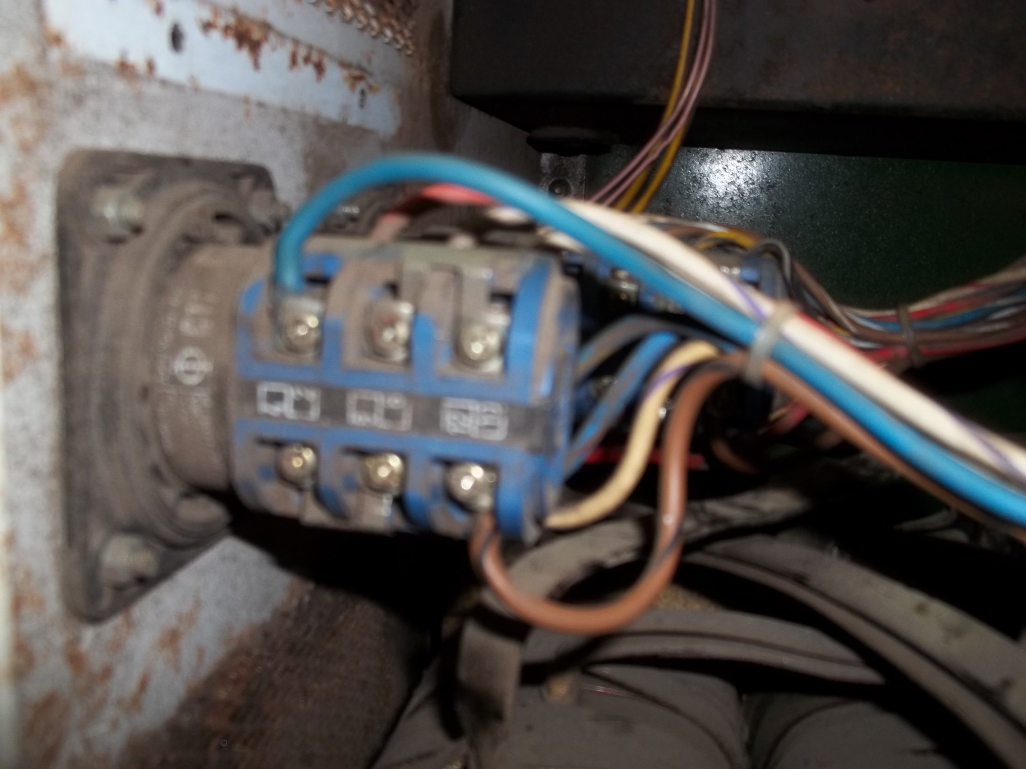

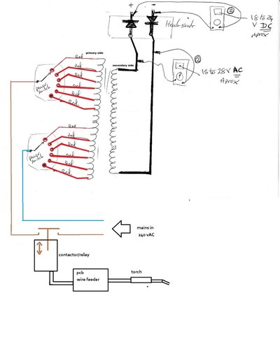

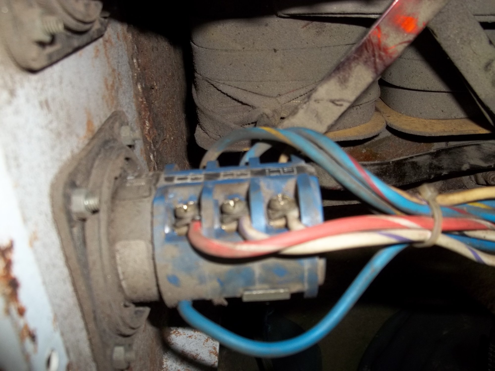

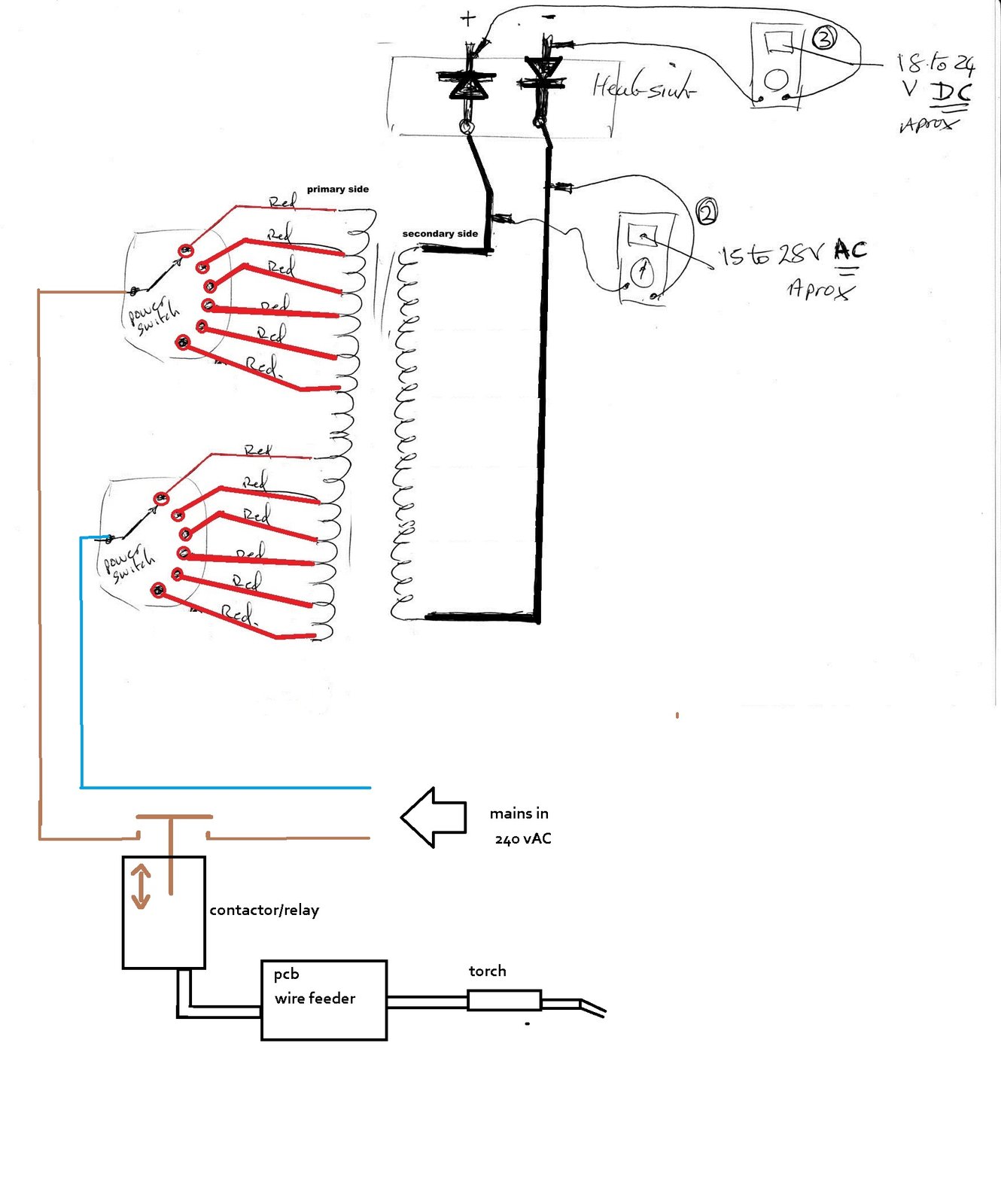

I disconnected the terminals as suggested, did not trip, reconnected them one at a time, did not trip until I got to 7 & 8 (reading left to right) on the lower row then it tripped every time. so that is it, the lower transformer is shorting internally and as you say not worth repairing, shame.
