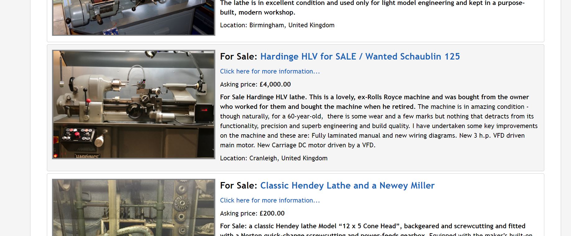

That has been up for sale for a very long time. No wonder!Was browsing on lathes.co.uk under lathes search and thought I saw the lathe for me...
I contacted the seller who confirmed he is looking for over £6k for the Hardinge![]()
Be warned - they weigh around 900kg and are a bugger to move. Cant sling off the bed has to be straps under the tray.Was browsing on lathes.co.uk under lathes search and thought I saw the lathe for me...
Thanks, I knew a decent Hardinge was outwith my budget.Be warned - they weigh around 900kg and are a bugger to move. Cant sling off the bed has to be straps under the tray.
I know the sellerWas browsing on lathes.co.uk under lathes search and thought I saw the lathe for me...
The one on lathes.co.uk does look almost too clean, new control cabinet nicely done.Edit; could be wrong, might be another HLV owner. He wanted similar money but I know it had two full boxes of collets, squares, rounds, hexs, etc.
