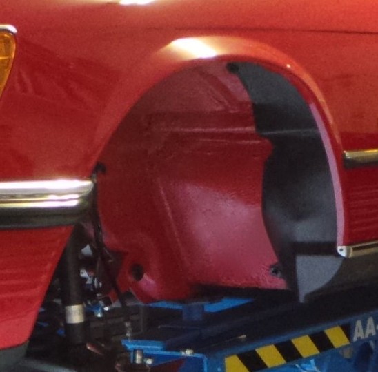

What do you guys use/recommend? I normally use gravitex but am looking for something a bit more meaty for my inner wheel arch.
Can you get moulded front inner wing protectors, probably the best bet for protection.
I saw Langy's chassis he did with raptor, it looks like a 2k version of Gravitex but I think the minimum you need to spend is about £90 for about 4l + 1l of harner.
I was wrong, £21 for a 1l kit of tintable inc the hardner, that would probably do both wheel arches.
http://www.ebay.co.uk/itm/UPOL-RAPT...767523?hash=item1a13870d23:g:CYIAAOSwxfNXNjot
Could I just add my normal blue base coat to tint?
