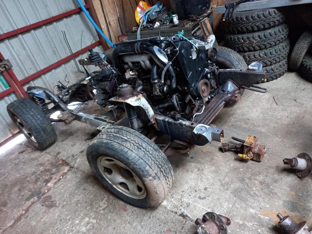

well thats a game changer then i based my idea that hydraulic was the way to go on a couple of big tractor mounted flail hedge cutters, i can see what you mean about the difficulty of getting belt drive up to the cutting head, dam near impossible i would think, so are we saying belt drive will stall less than hyd ? i certainly dont want a finishing mower, sometimes if im busy and i havent had time to mow the grass can be 6 or 8" long, as i havent started the cutting deck now is the time to jump ship, how would you drive the cutting deck ? straight off the crank pully to the deck like a ransomes or would it make sense to chain drive side ways from the crank pully to a shaft that runs front to back so i can have pto's at front and back so i can have a flail on the rear too ?

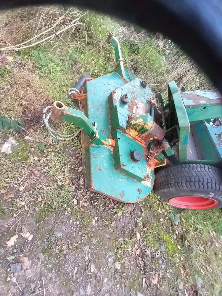

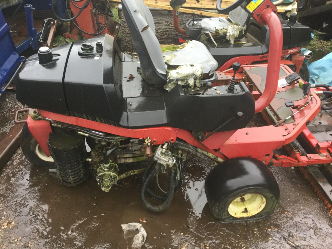

Could well be, where abouts are you ?@Baloo , I have three diesel Toro out front mowers kicking about, would they be of any use?
Are either of those 2 machines actually cutting grass???

dosent really look like they are doing much does itAre either of those 2 machines actually cutting grass???![]()
Something else I though of that would probably be helpful depending how far into the build you are is if you flip the diffs you can have the engine and steering at the rear like the Kubota in the original picture giving better view and manoeuvrability whilst maintaining multiple forward speeds
Would also mean a pro straight off the crank to the rear is easily done then hyd to the deck at the front along nice long metal pipes for cooling.

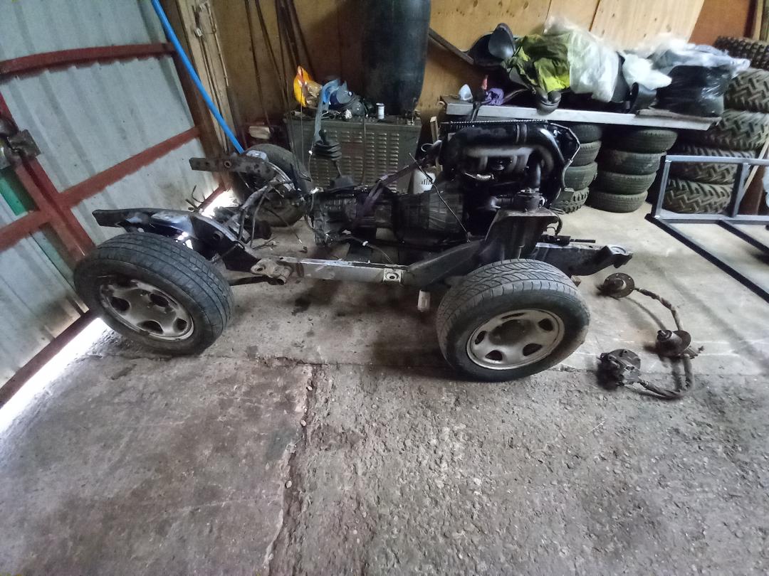

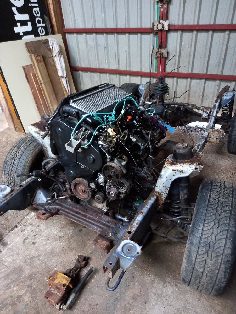

i did start off with 4w steer in mind by welding 2 vitara front halves of chassis together then something like a transit connect engine and box low down in the middle but i decided to keep it simple for now, a lwb vitara makes it round where i have to mow so im sure an extra short wheel base one will too
i need to make a decision on the cutting deck next im being drawn to hydraulic as i would like the deck to lift up on 2 rams to allow me to get to the blades to sharpen them,
i also might have to change engine and box as the vitara box has the rear drive output high up in the centre not a problem on a lwb as the angle of the prop going down to the axle is fine but on my extra short wheelbase the angle of the uj's needs to be better than 45 deg and i dont think that will work, some thing like a landrover has the rear out put down low on the same level as the rear axle, brain is still working overtime![]()
