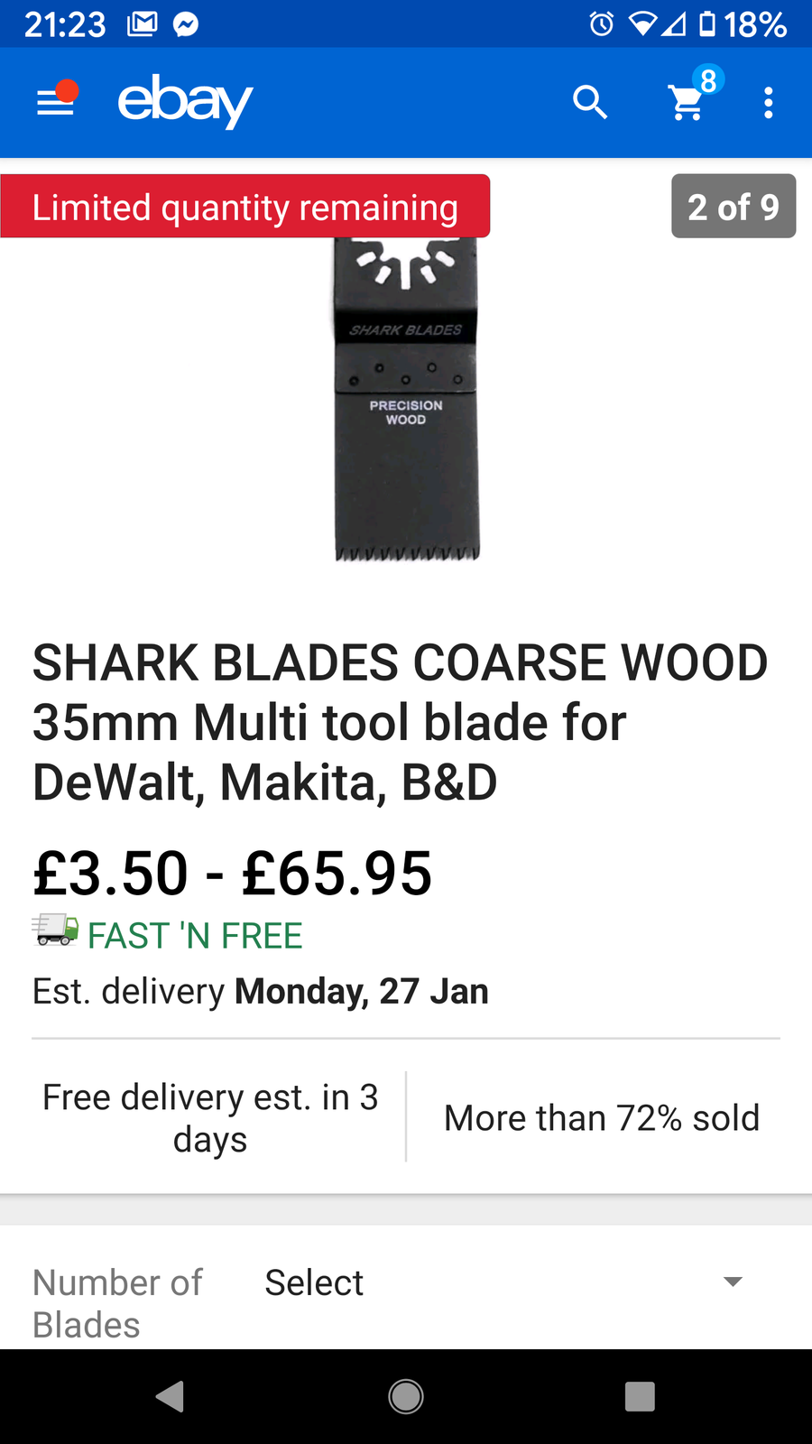

Shark or Saxon blades on eBay do the job.
The Fein blades are stupidly expensive over here.
Are the dewalt ones as good quality and prices?
Thanks @eLuSiVeMiTe for clearing that up.
Won't fit the DeWalt. Well. Not the qr anyway.I was using saxton blades but found these even cheaper still on eblag there called Japanese blades cut well and last ageshttps://www.ebay.co.uk/itm/10-x-Coarse-Cut-Blades-for-Fein-Multimaster-Bosch-Ryobi-AEG-Multitool-Multi-Tool/183332034175?ssPageName=STRK%3AMEBIDX%3AIT&_trksid=p2060353.m2749.l2649
Dewalt need the open loop to use the qr.they fit the mac alister bosch and some others
