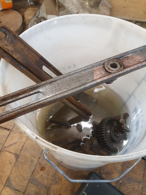

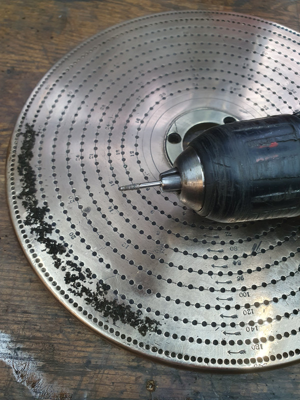

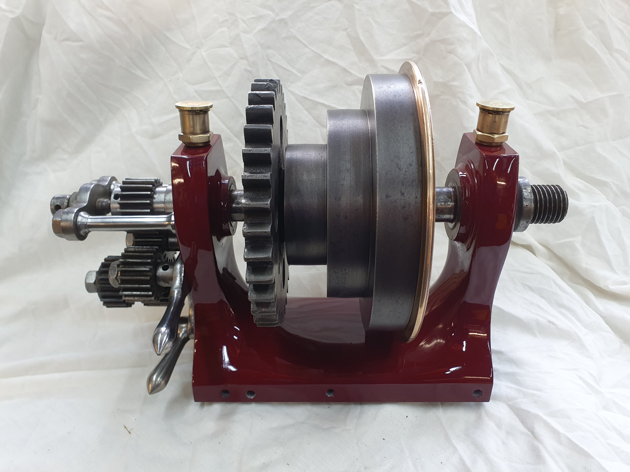

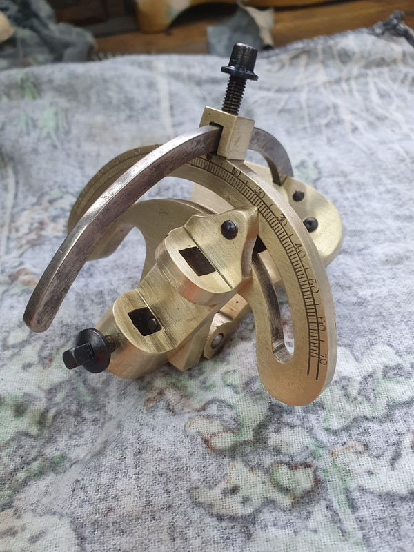

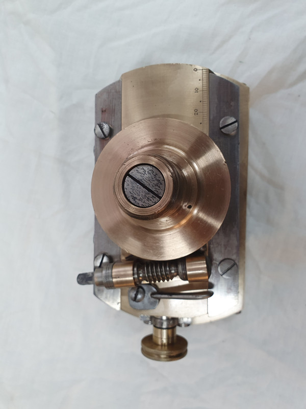

A bit progress. This took ages to clean the holes out.

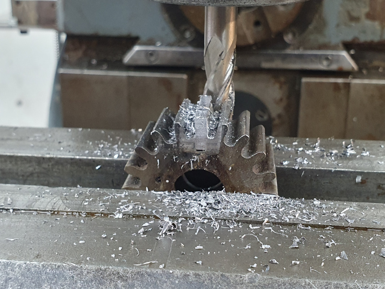

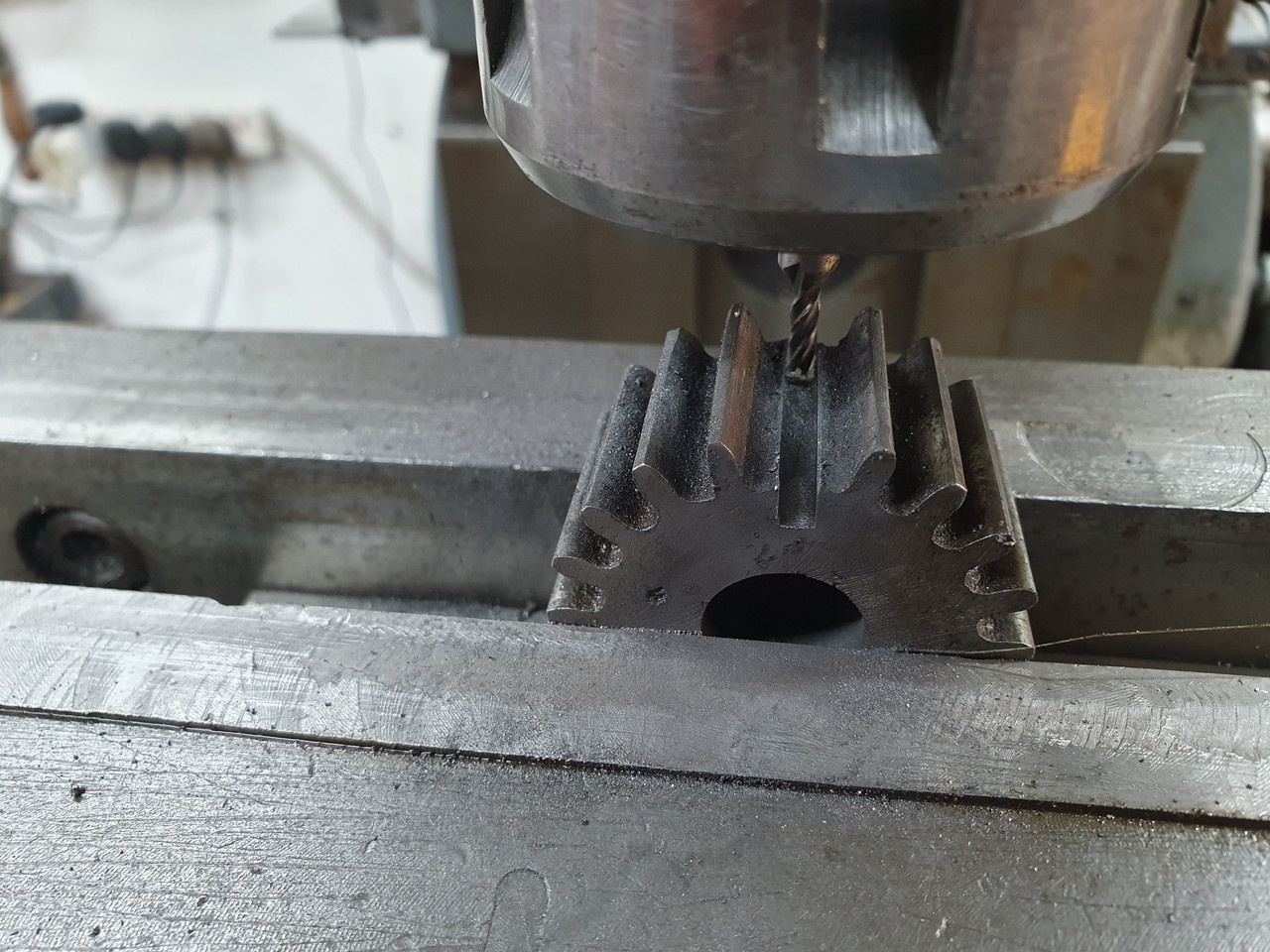

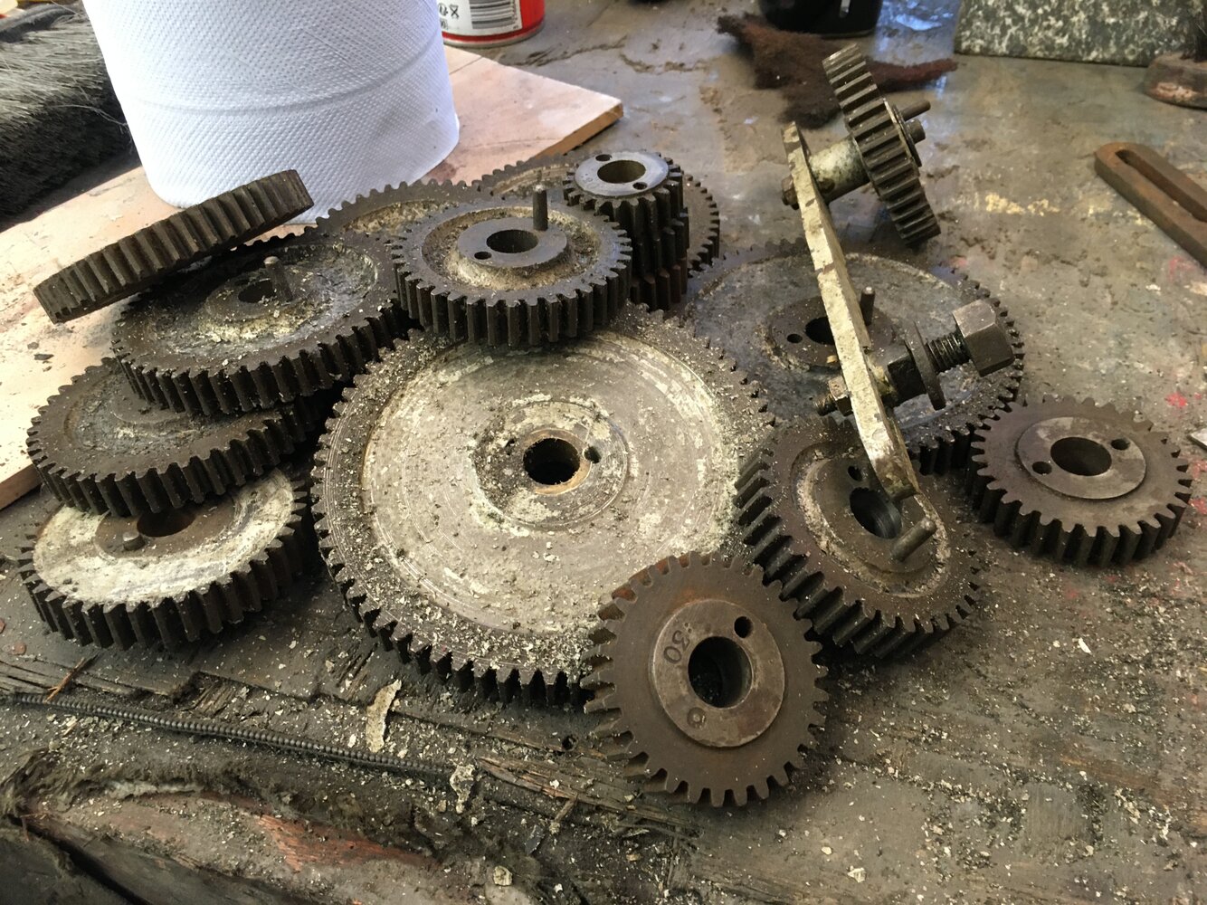

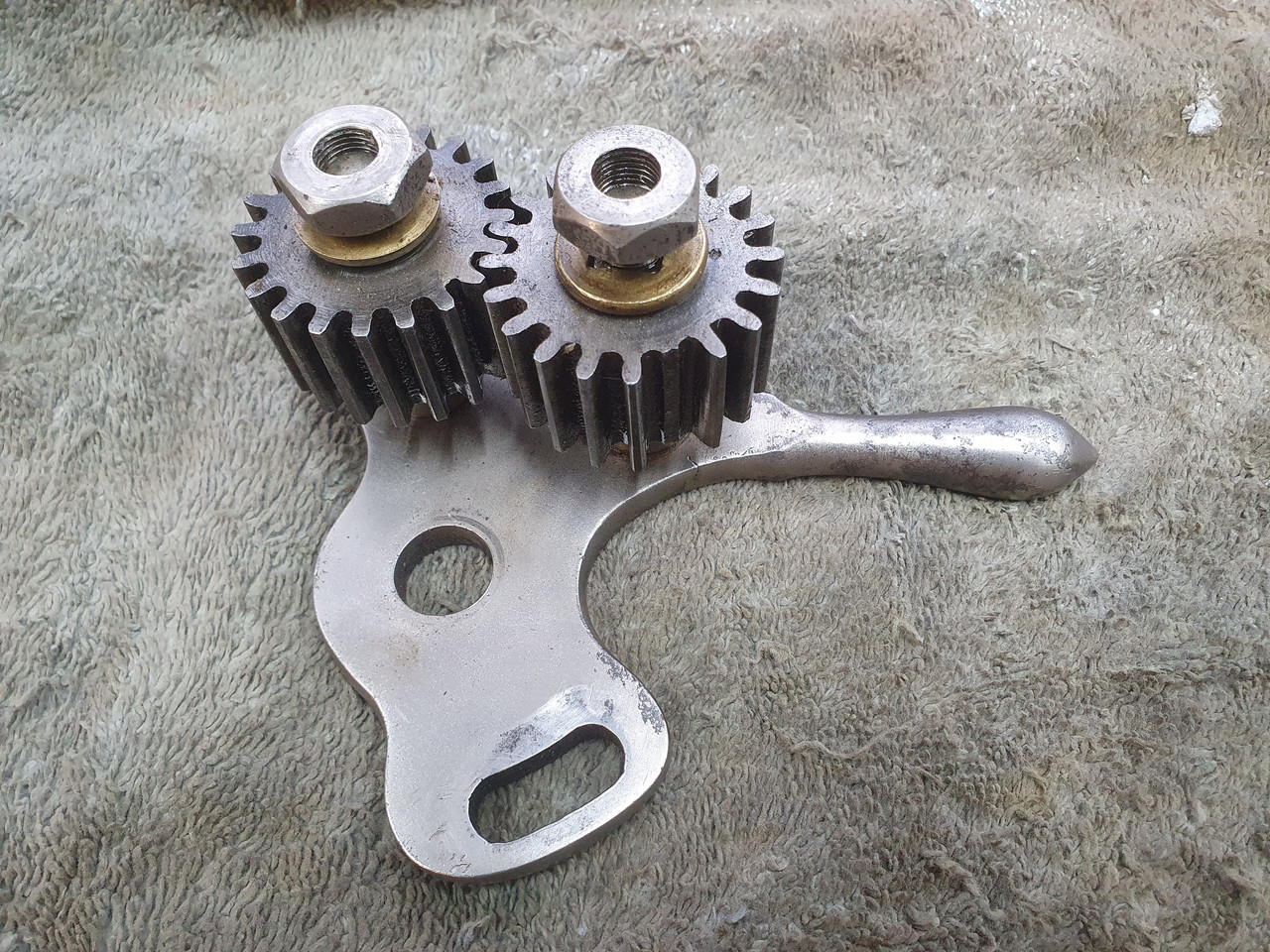

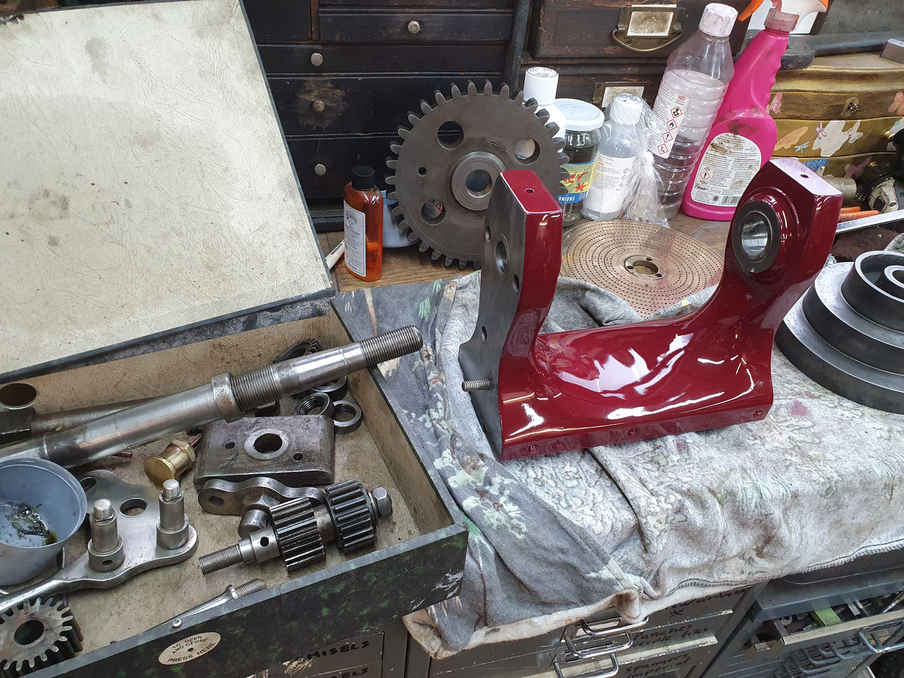

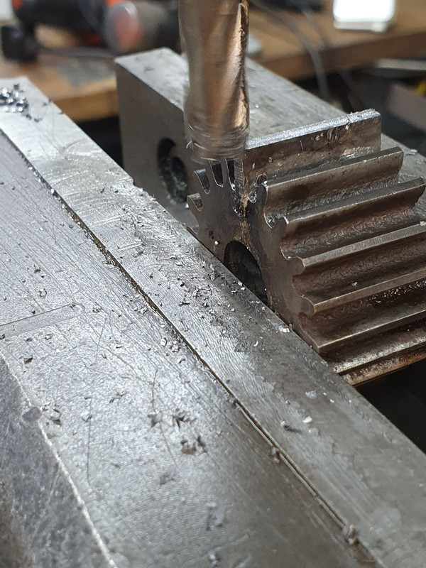

A gear has a tooth missing,
Finished off with a file

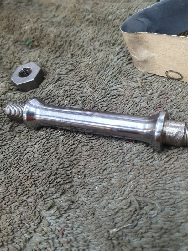

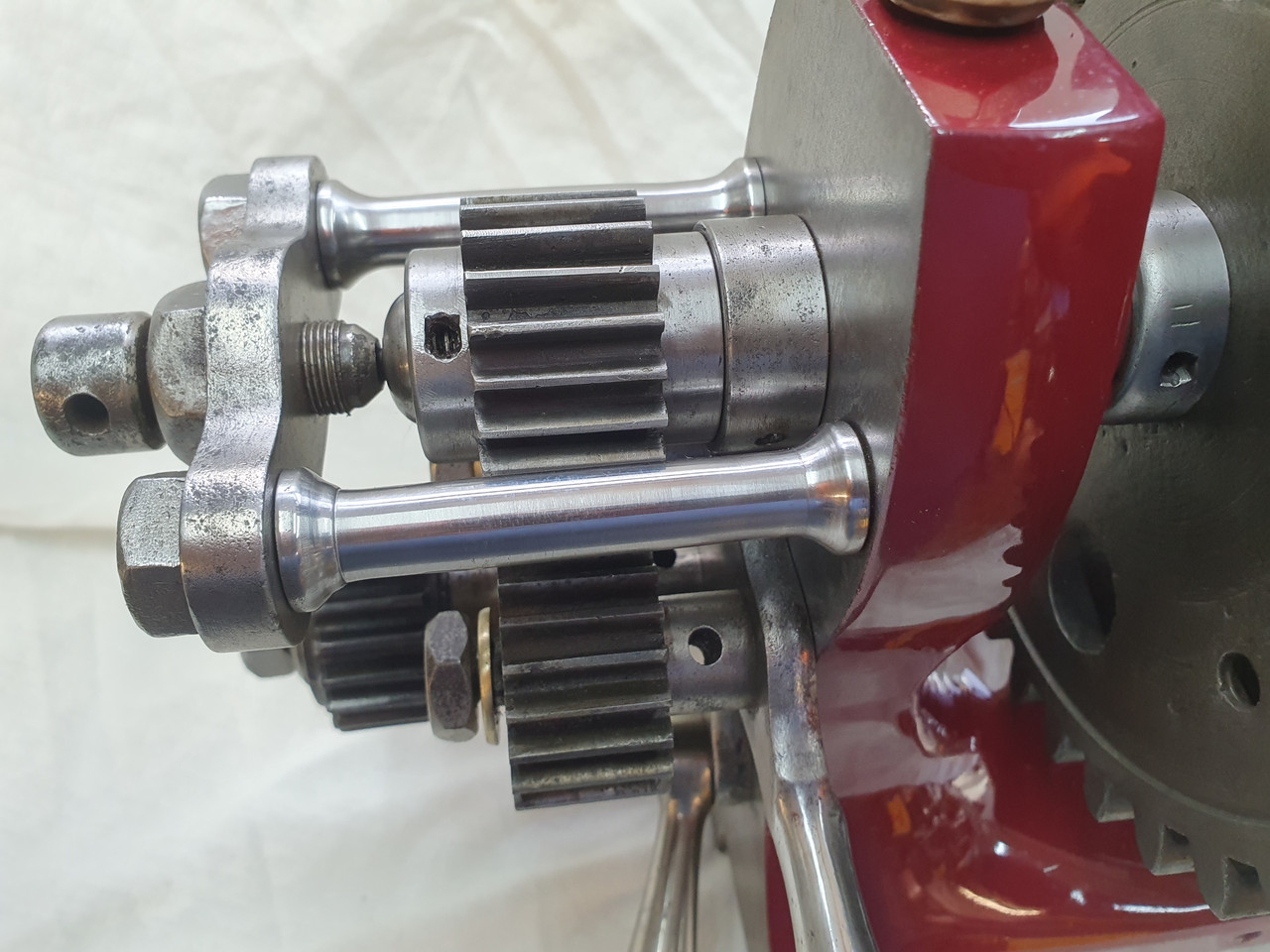

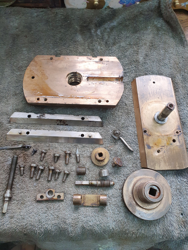

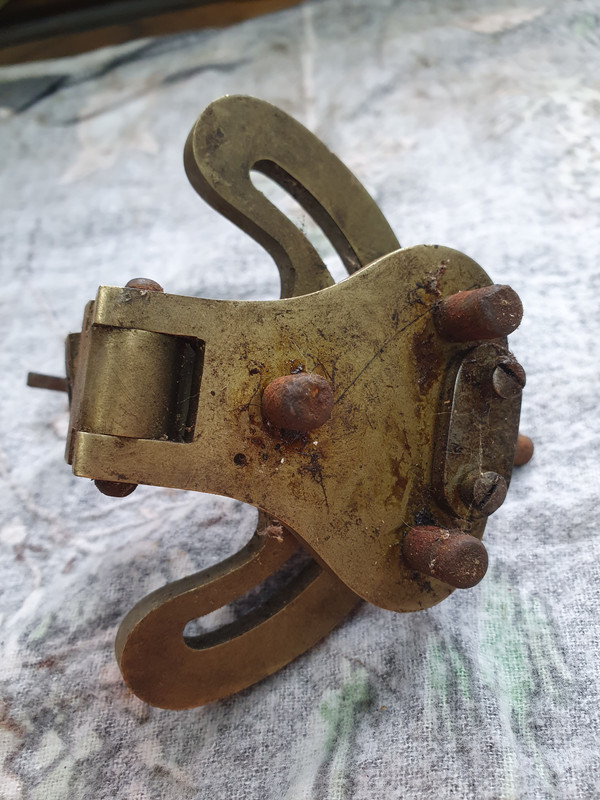

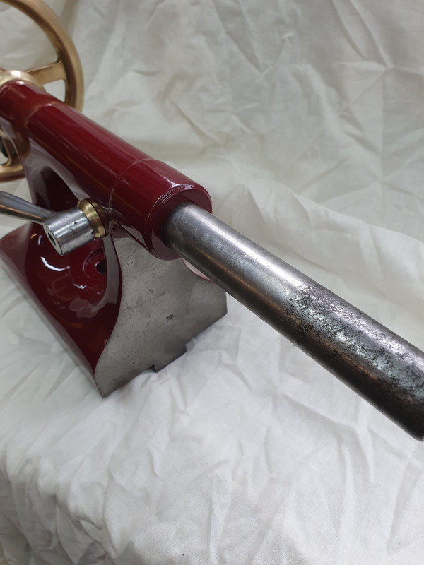

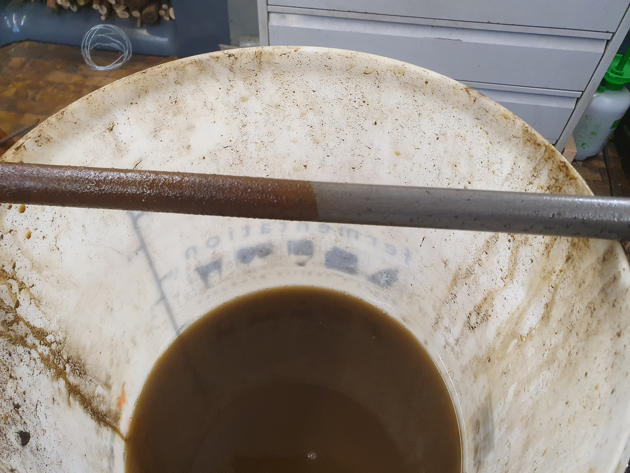

This piece from the tail stock was very pitted, so I removed the nickel finish. Alot of pieces have been copper plated first.
After nickel plating and polished

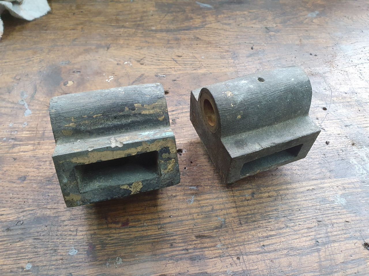

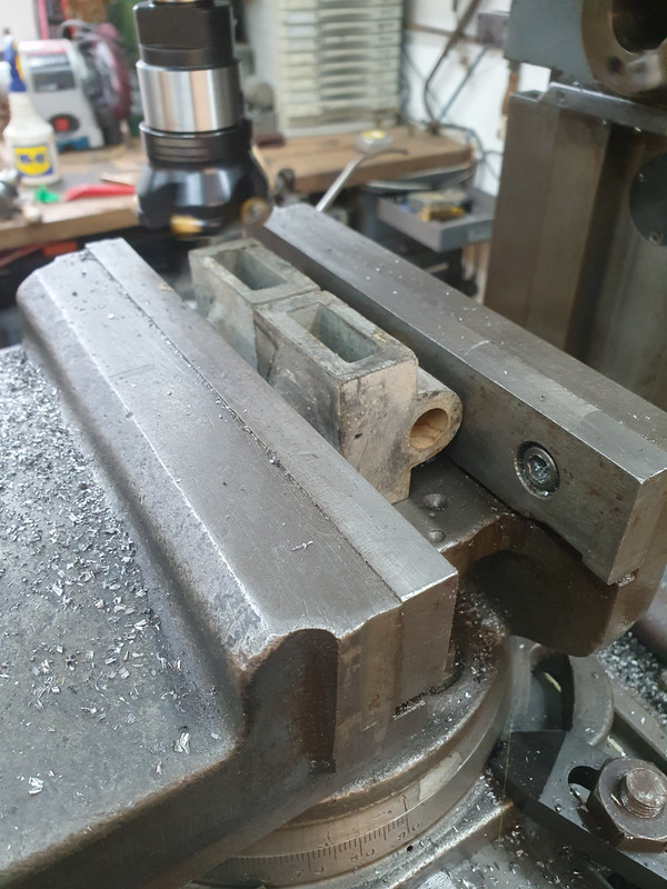

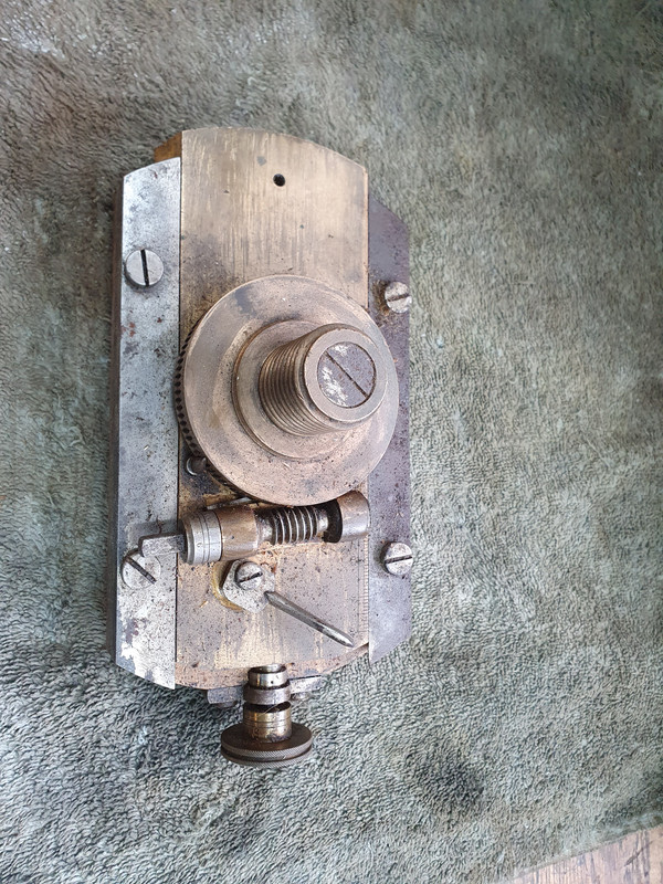

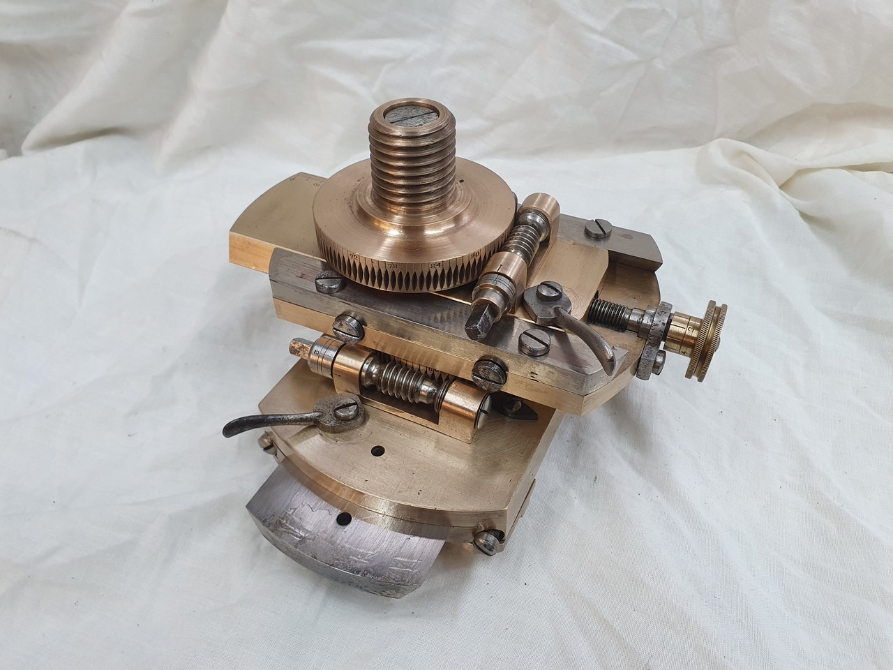

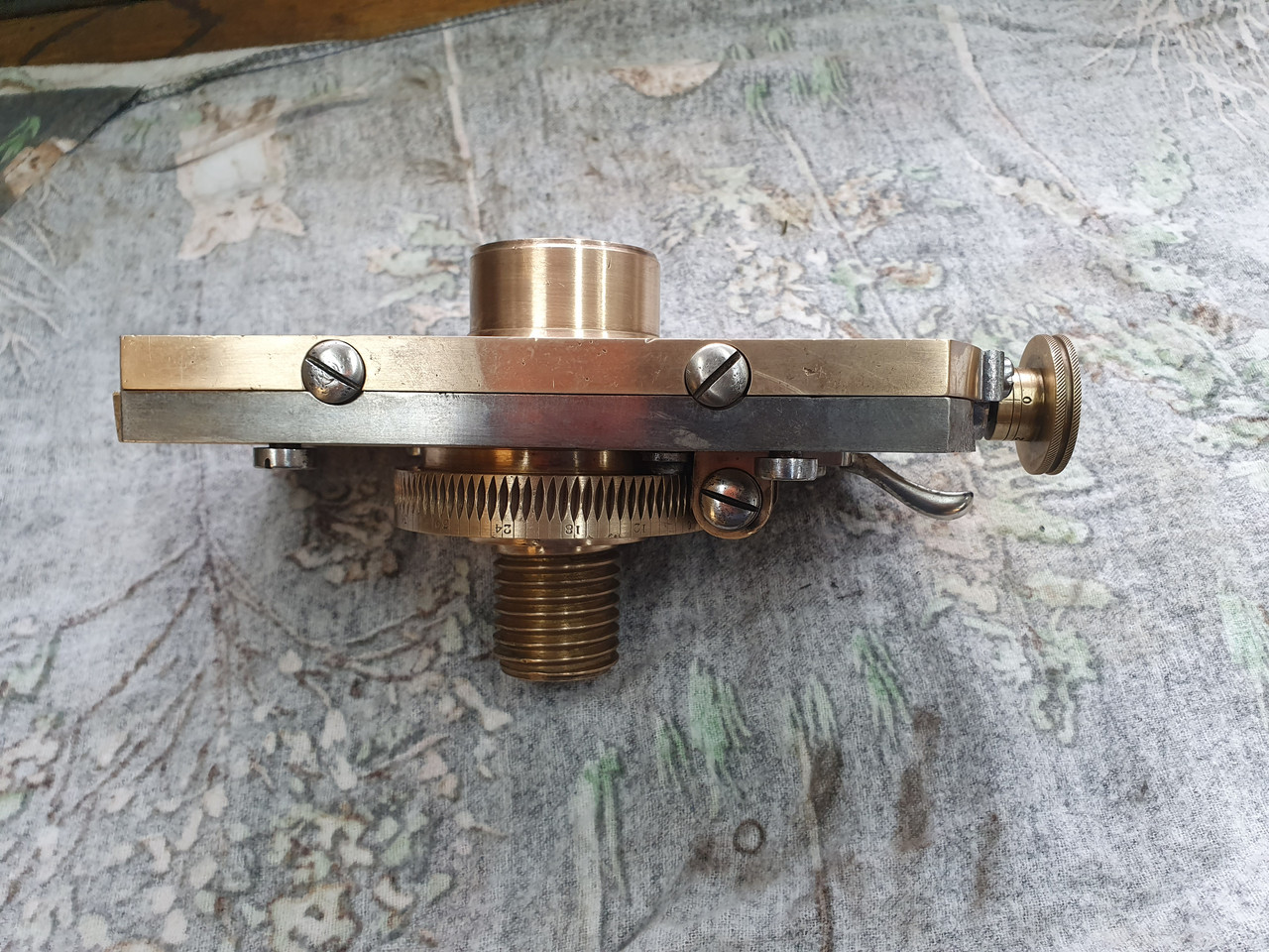

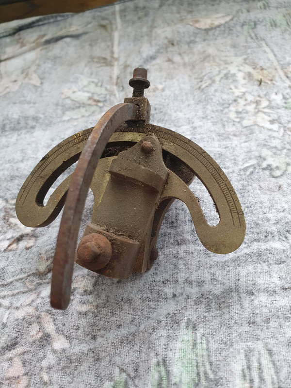

This is a eccentric chuck
A bit crusty

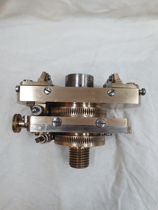

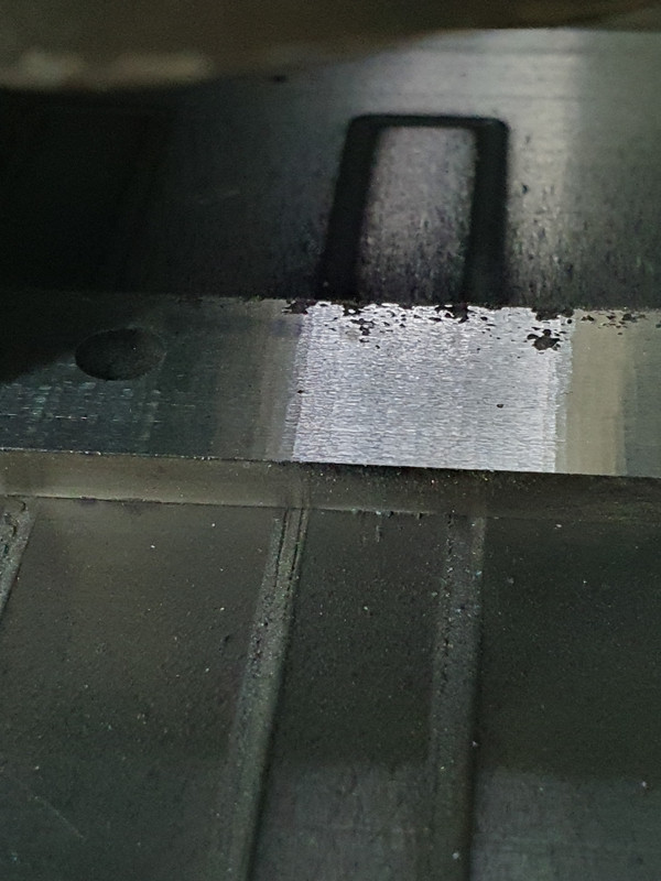

Surface ground
And replated

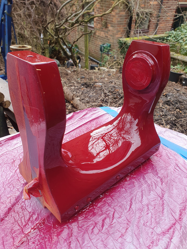

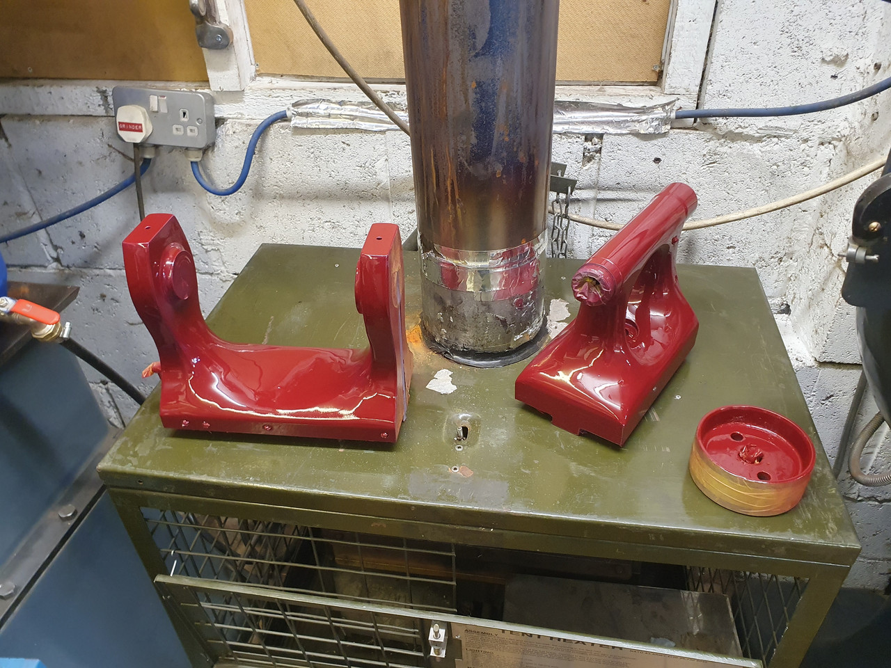

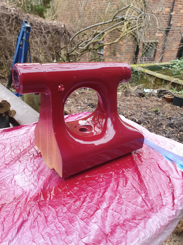

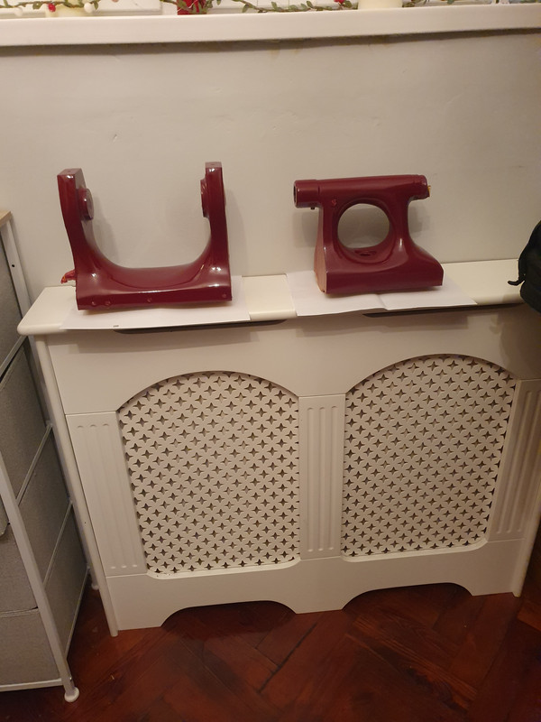

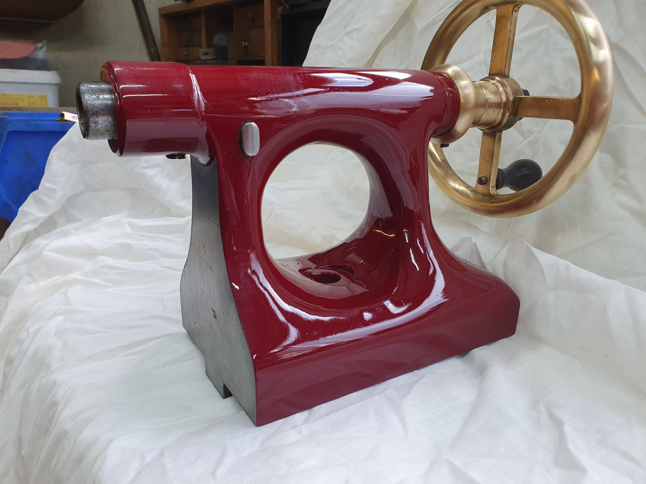

I even managed to get some spraying done
Stuck them on top of the army heater to help cure

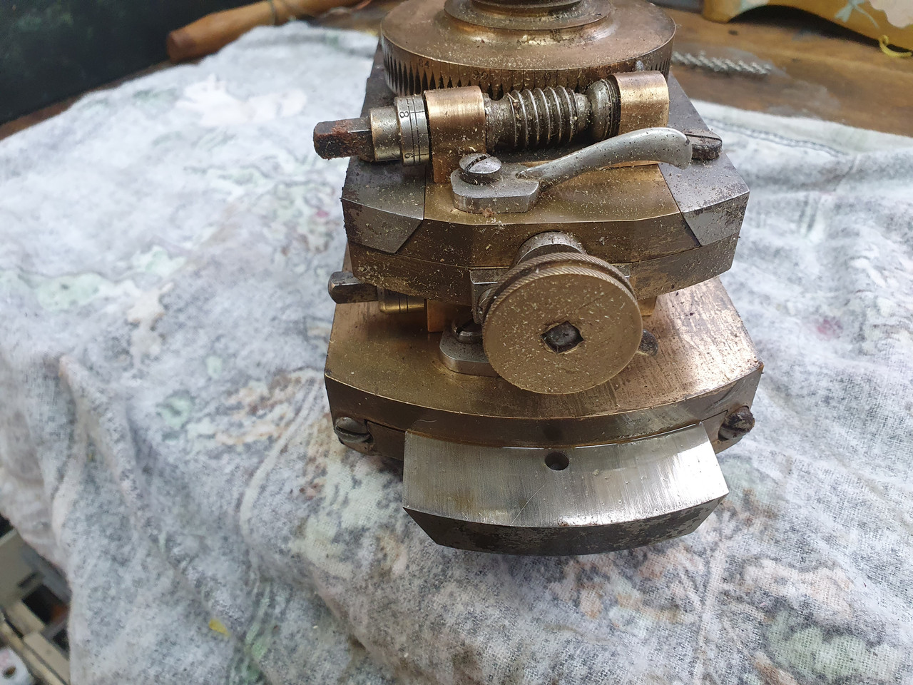

A bit crusty
Surface ground
And replated
