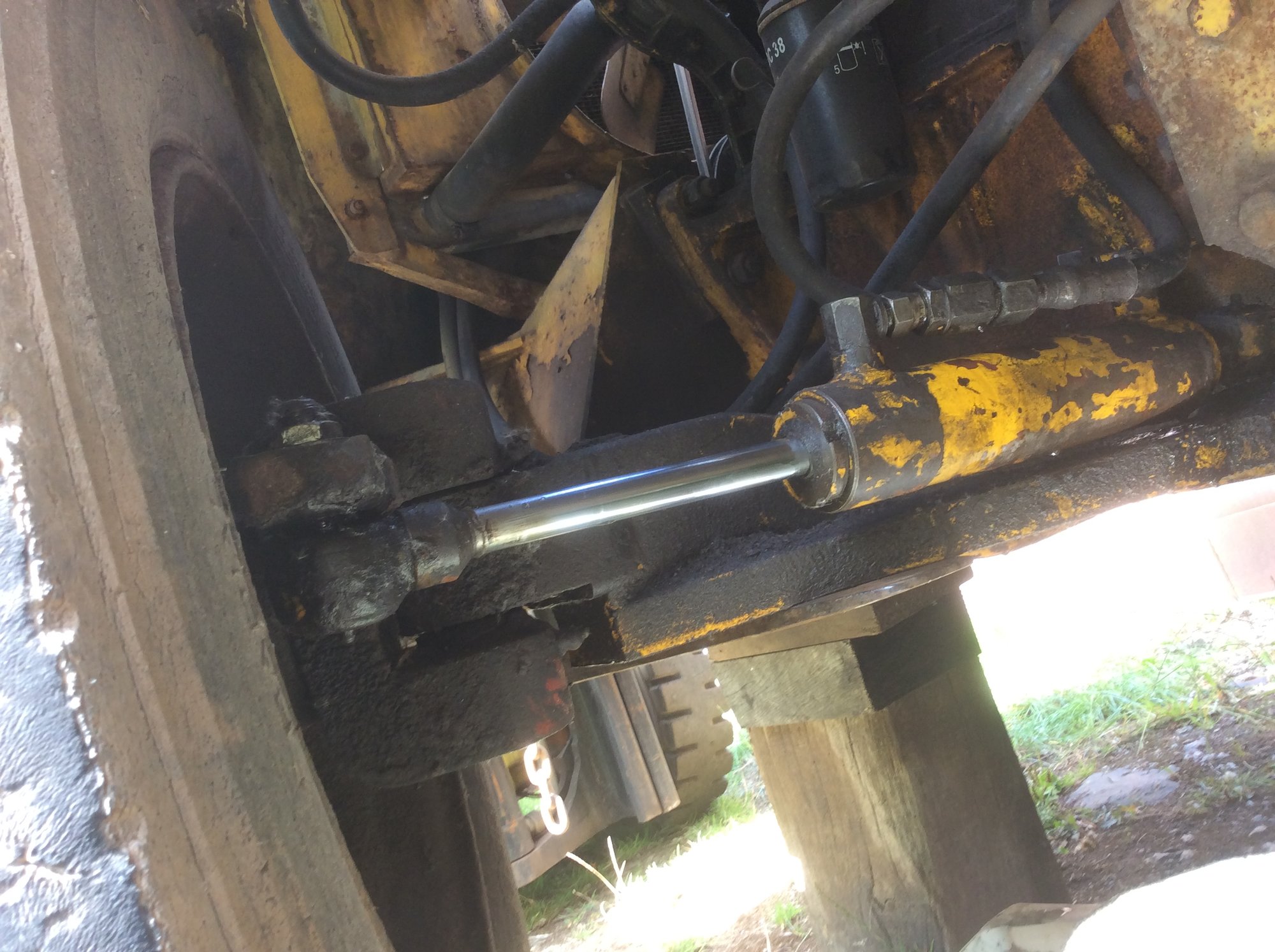

    ADB51C38-986E-4438-9EDB-D970EB9EBF6F.jpeg my old fork lift is turning the opposite way it used to!
    The mechanic who dismantled it over a year ago has health problems and can’t do it and has forgot.i thought just swop the hoses over but the fitting aren’t interchangeable,do I simply turn the ram around?
    The machine has had some problems in the past,in the last 24 years! I’ve replaced the pump at least twice,the reason the mechanic took the ram off was he suspected it faulty as steering was heavy and not smooth,it was sent away and came back with no fault,this is why I’m re assembling it.
    It’s a sambron,with a Perkins P3.

    Can you swap them at the pump?

    If the ram was the only thing removed then it has to be the hoses swapped somehow.

    hoses might be right swap em at next maifold connection
    will swap back to normal watch out for another different connection between them then

    strange that the hoses are long enough and easily put on the wrong way round , but that alone should make them an easy swap . is there a rod linking to the other side , or has it got a ram on too .

    Don’t forget it’s is rear wheel steam, so the wheels will turn right to go left and vice versa. Not trying to be clever but it looks like it’s on blocks as opposed to being driven to test.

    If it's not what Bullet says above then are the fittings in the ram the same or different? If they are different then swap the fittings or if possible, turn the ram around.
    Steer rams are normally just double acting cylinders.

    turning the ram round wont change anything ,,, out will still just make it longer ,, ??

    The fittings will not allow me to swap around,as I said they’re non interchangeable,as in ones several mm larger.
    Yes it’s on blocks to allow me access and to operate steering and bleed,no way I can go lock to lock without an airport runway:laughing:,and it steers opposite wether up or not.

    is there a drag link , only one ram that does both sides ?

    Yes,one ram.

    Does it steer with hydraulic joystick? Just swap the two signal lines on it or on the directional valve if you can't swap ram hoses in either end.

    Those hoses have adapters (well, the one in view does). Could be they were reversed by the place that tested the ram.

    do you have a pic of the other connection to the ram , they would usually be the same size ,,, maybe the adaptor belongs in the other end , is the other connection straight , or a block 90 maybe.

    It will if you leave the pipes on the same!

    then just swap the pipes.
